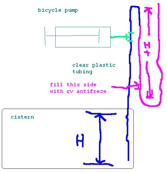

I have a burried cistern at my cabin and plan on building a manometer and plumbing it like the picture.
You will have to pump the pump occasionally to make sure tube doesn't get water logged the height of the pink part has to be just a little longer than the maximum tank level so it dosen't over flow when pumping the pump to make sure it dosen't get water logged.
one note I haven't checked the specific gravity of the antifreeze but it should be close enough to be almost 1" in tank to 1" of antifreeze
tom
