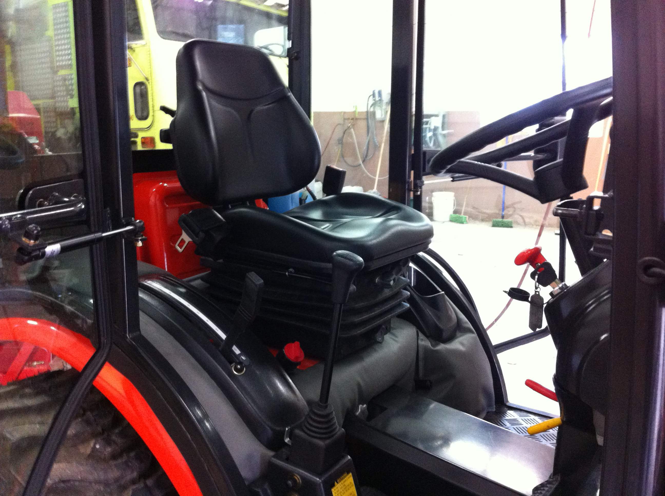

The heat is now working - there was air in the system. Yes, it's quite a job and there were several things missing from the cab kit but I hope the dealer is going to replace them for me. The only thing that's not working now is the rear wiper. I don't seem to be getting any power from the switch to the rear. I even managed to get the signal lights fixed today as well. Here are a few pics of the finished cab. Thanks everyone for the replies.View attachment 344330View attachment 344331
Great job. Enjoy the fruits of your labour.

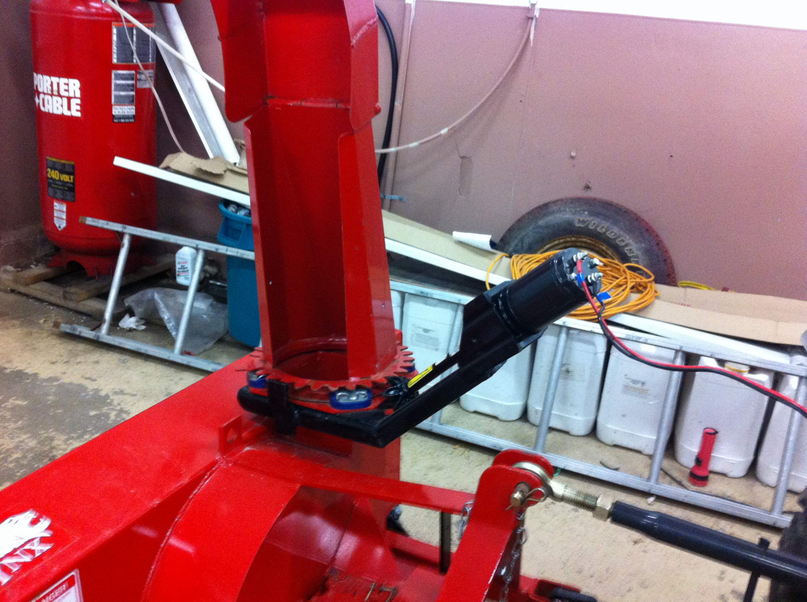

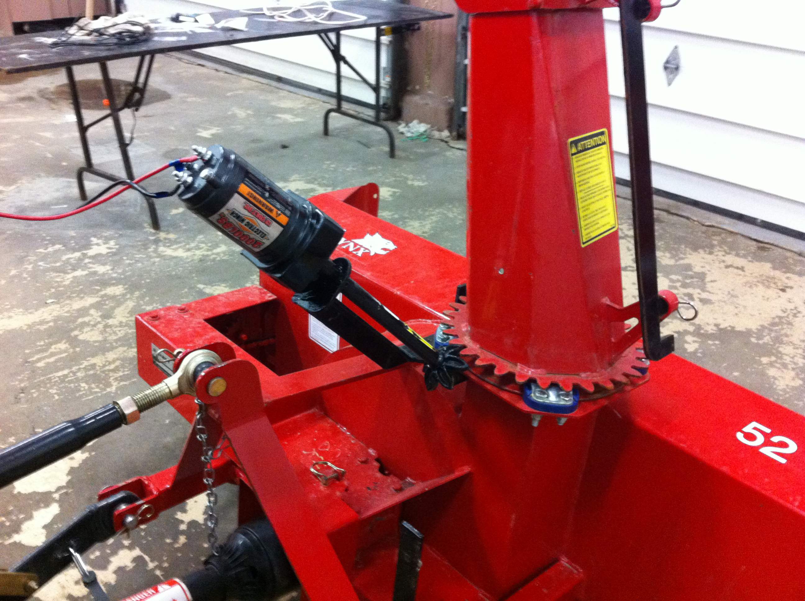

I decided yesterday to scrap the idea of using a winch to rotate the chute on the blower. I had tried several times to make it work but it would not turn properly for me. It would keep binding up and almost snapped the chute the last time I tried. I called the dealer to order a rear remote for the tractor. I was going to install it myself. I did not think it was that much of a job -- not considering the trouble I had doing the cab. He tells me that in order to install the rear remote, I would have to lift the cab off the tractor. That is not going to happen after the five days it took to get it on there. I thought only the seat would have to come out and once you remove the panel under the seat, you would have access to everything I need to install the remote. He said I would not get the pipes in there without lifting the cab. That makes no sense to me -- I mean, if you had to remove the cab, that would say that the pipes run under the cab and if so, how you would you get the cab back on? I'm sure the pipes run under the tractor under the inner fender - or am I wrong? Anyone know if this is true?

I finally got the winch to work but not using any cable. I will post a few pictures to show how I did it. I can thank my dealer for this suggestion. I thought of doing it this way but he did the welding for me. It works great and the nice part is no cables. I have seen a few set up with cables but this is the first time I've seen it done this way. This way to me is better since there are no cables to deal with. I will go with the two rear remotes, but not until spring now. winch.jpgwinch1.jpg
