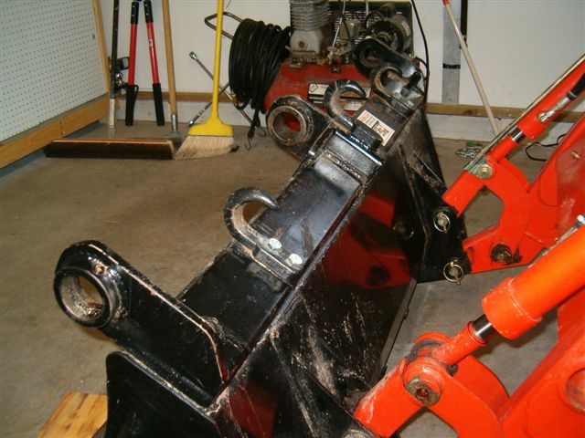

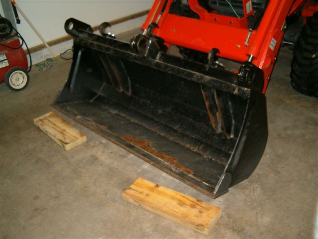

Unlike some of the safety police types postin here, I'd just like to quietly point out the unsafe hook-up in rimshot's first picture, where although the load hangs down from the center of the bucket, the attachment point of the chain is solely on the left hand grapple mount, from whence it crossed over to the center hook. This mounting applies a twisting torque the the left hand bucket mount and is essentially trying to twist the bucket off the mounts.
We should all avoid this kind of one-sided or torquing hook ups, instead either just using the center mounted hook, or better yet, both of the end points. Also, the positioning, while dramatically impressive for a picture, is too loose, making the bucket have to rear up too high, and bringing the COG too high risking lateral instability.
Thomas
You are right about the three point hook up as opposed to the two point hookup in the picture. In this case the stumps were plucked from a pile and did not go anyplace. They were posed for a picture. None the less the balance provided by the three points is Superior.
So far as twisting the bucket off the boom arms is concerned I think some bucket distortion would have to take place for this to happen. I don't think there is much chance this is going to occur in this case. Of course there are limits for everything but I don,t think my bucket will be distorting too much with anything this particular CK20 can bench press . As you can see the bucket is reinforced with plate and box channel steel. You point out correctly the stress would none the less be preent.

Hi Rimshot,
I know a posed picture when I see one, and your other points are just as valid, but an object lesson in safety should never be a missed opportunity to teach safer methods.
Thomas
PS: Being a Belt AND Suspenders guy by nature, my bucket would look more like yours, IF I didn't already know how feeble my little B2320's loader is compared to the bucket's inherent strength. :)
