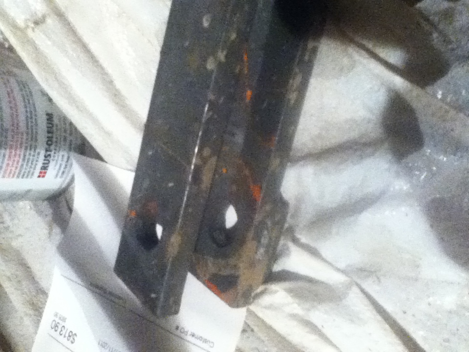

Hi,
I'm trying to replace a bent adjustable lift arm off of my kubota, and really like the crank style on the Kioti's I've seen.
I need the arm to have yokes on both ends, which I think rules out the ck20.
Can I get owners of a ck25, ck27 and ck30 to measure the length of this arm at it's shortest and longest lengths (hole-center to hole-center), and also internal width of the top and bottom yokes.
I've included a picture of the part I'm asking about.
Thank You

I have my tiller mounted so did not measure full travel of the adjustment but if the stationary (left side) measures the same as yours the right side shoudl work. Stationary link is:
Top clevis width ID - 1&3/16"
Bottom clevis ID- 3/4"
From top to bottom pin center - 16" first hole & 17" to lower hole
Uses 3/4" pin dia.

Length is good, and bottom yoke is good, top is only 7/8" on the kubota but washers would work for that...
Unfortunately the pins on my tractor are only 1/2"... drilling the bottom out for a bigger pin would be no problem, but the top doesn't seem like it will work, since it's a ball on mine..
Thanks again for the measurements though!

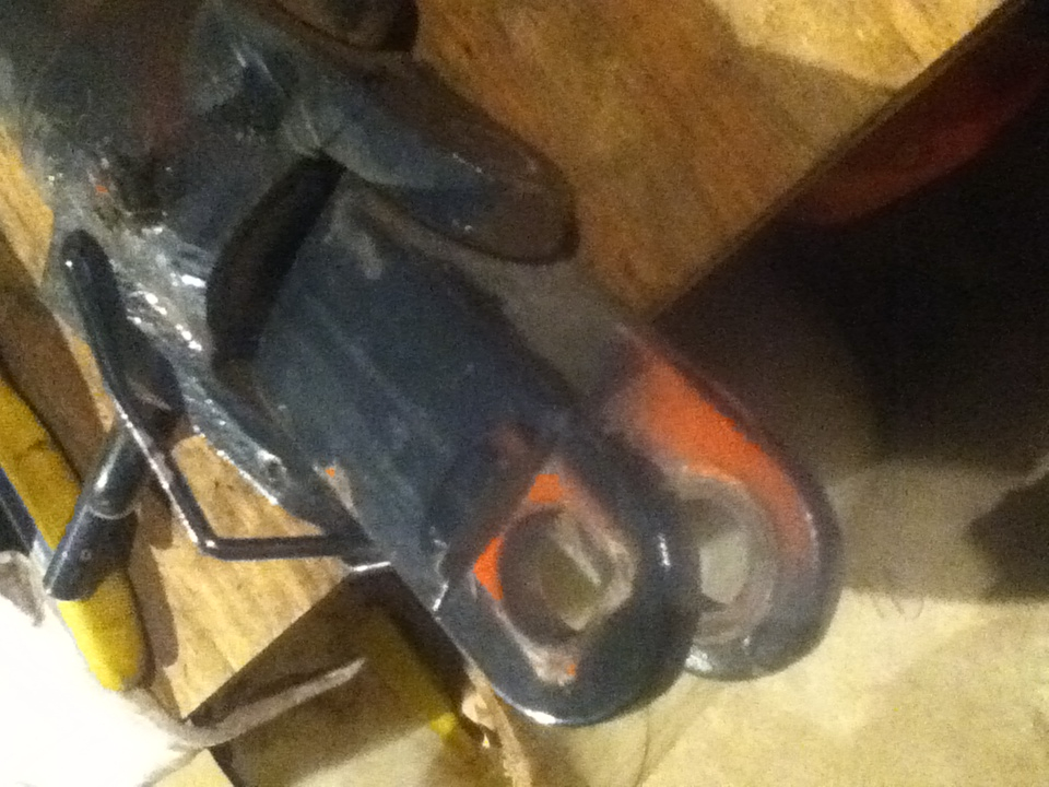

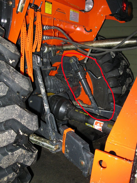

Mine measurements are also the same, and I got a ball on top to.

Could you use 1/2" pins and make bushings to go in the lift link?
