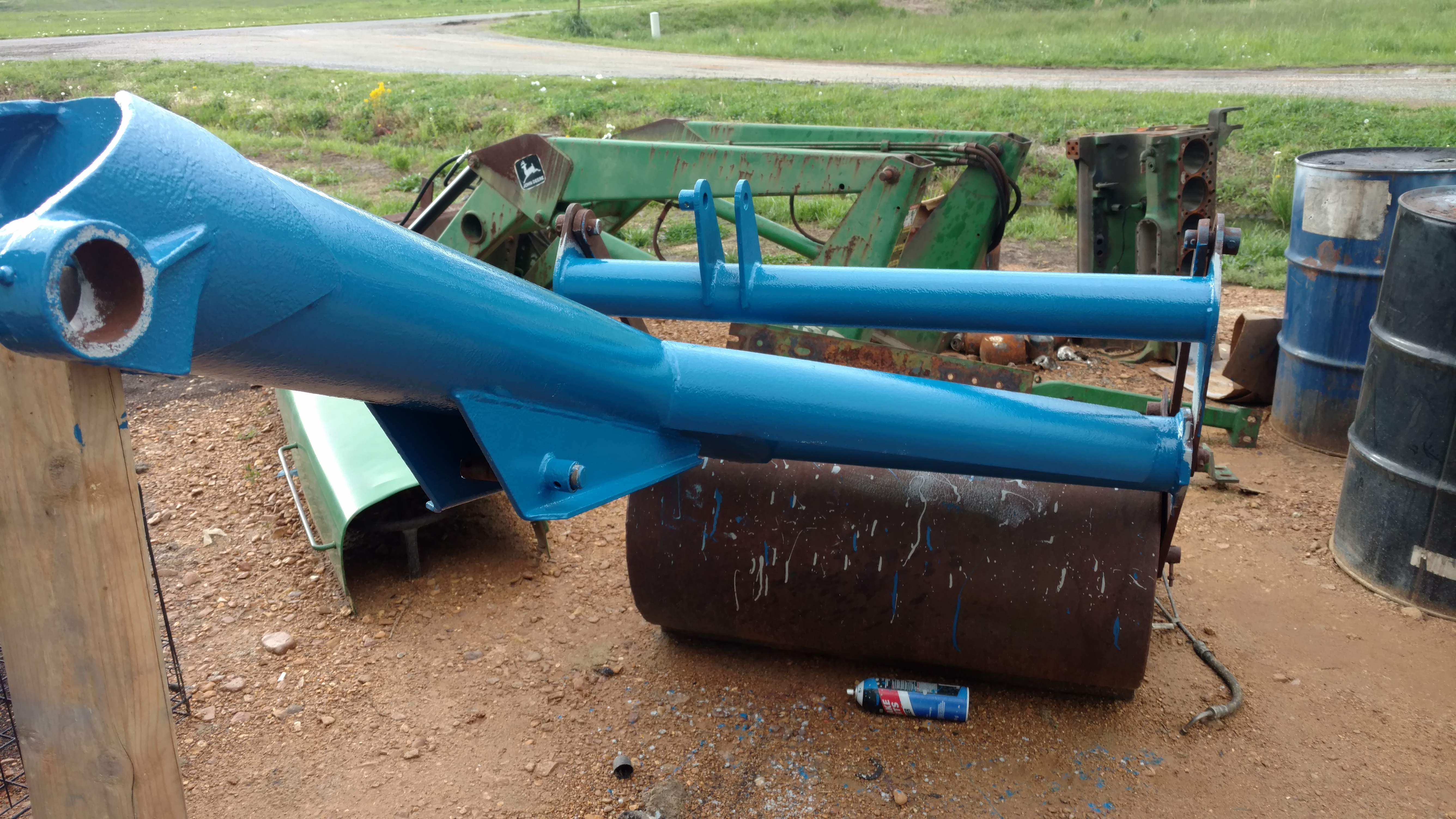

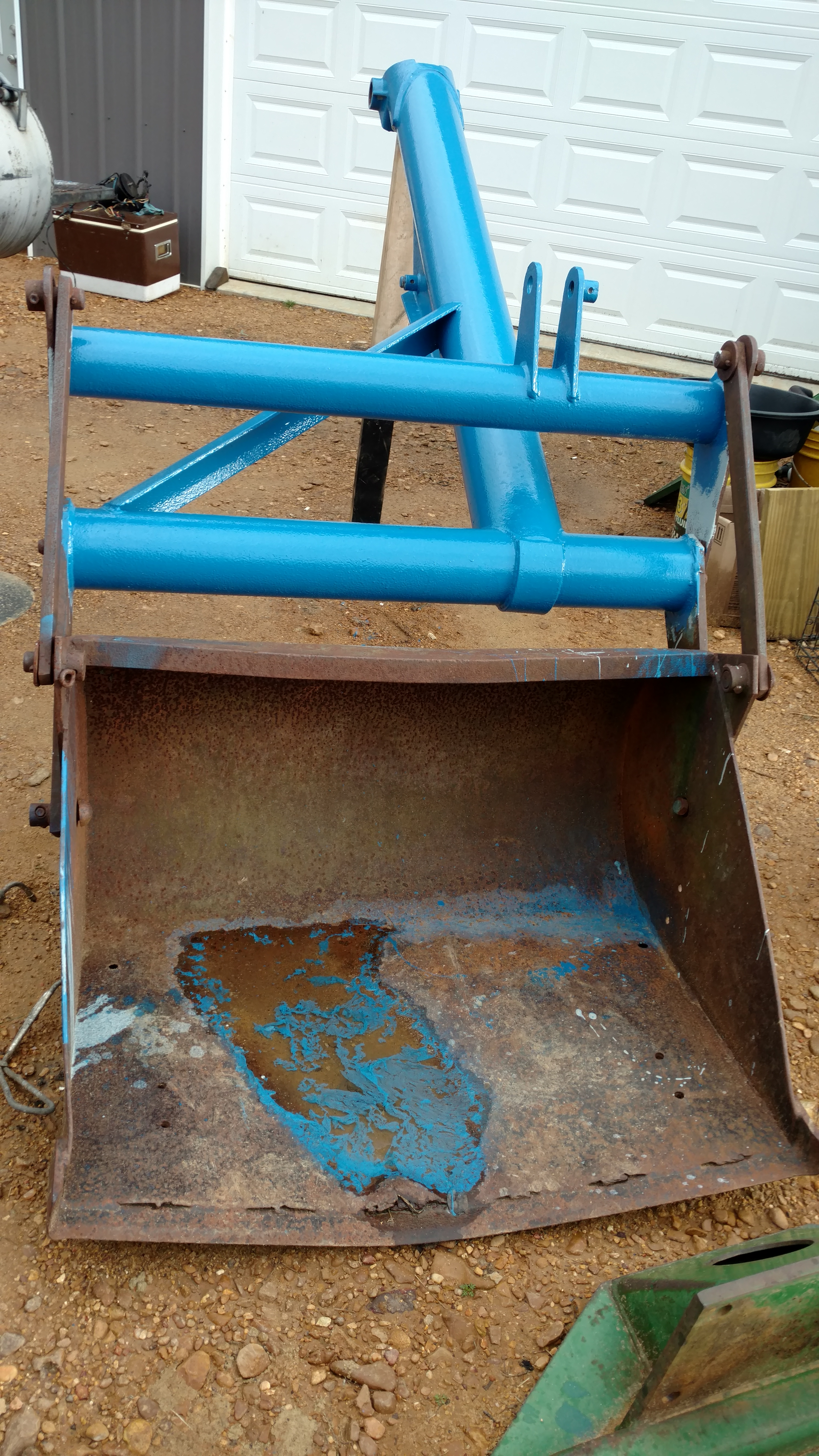

Still pushing to make the May 4th&5th local antique tractor in Mayfield KY with set up on the 3rd. There is still the front bracket but mentally it is done based on what we know at this time. The bucket has to be repaired but we want it mounted first to cut out most of the manual handling part. :)
Today I got the painting done on the parts that will not be cut and welded on as I will posts. The main cylinder is now blue and the curl cylinder is primed and ready to make blue.
I was moving fast and had to finish painting in light rain but was down to the inside area where the top of the main lift cylinder pins. The new paint did not get rained on when when it came a storm. The other spotted a bit where what had beaded up water after the sun came back out but that is not an issue. I plan to brush on the second coat on the top side of the arm for longevity of the paint job.

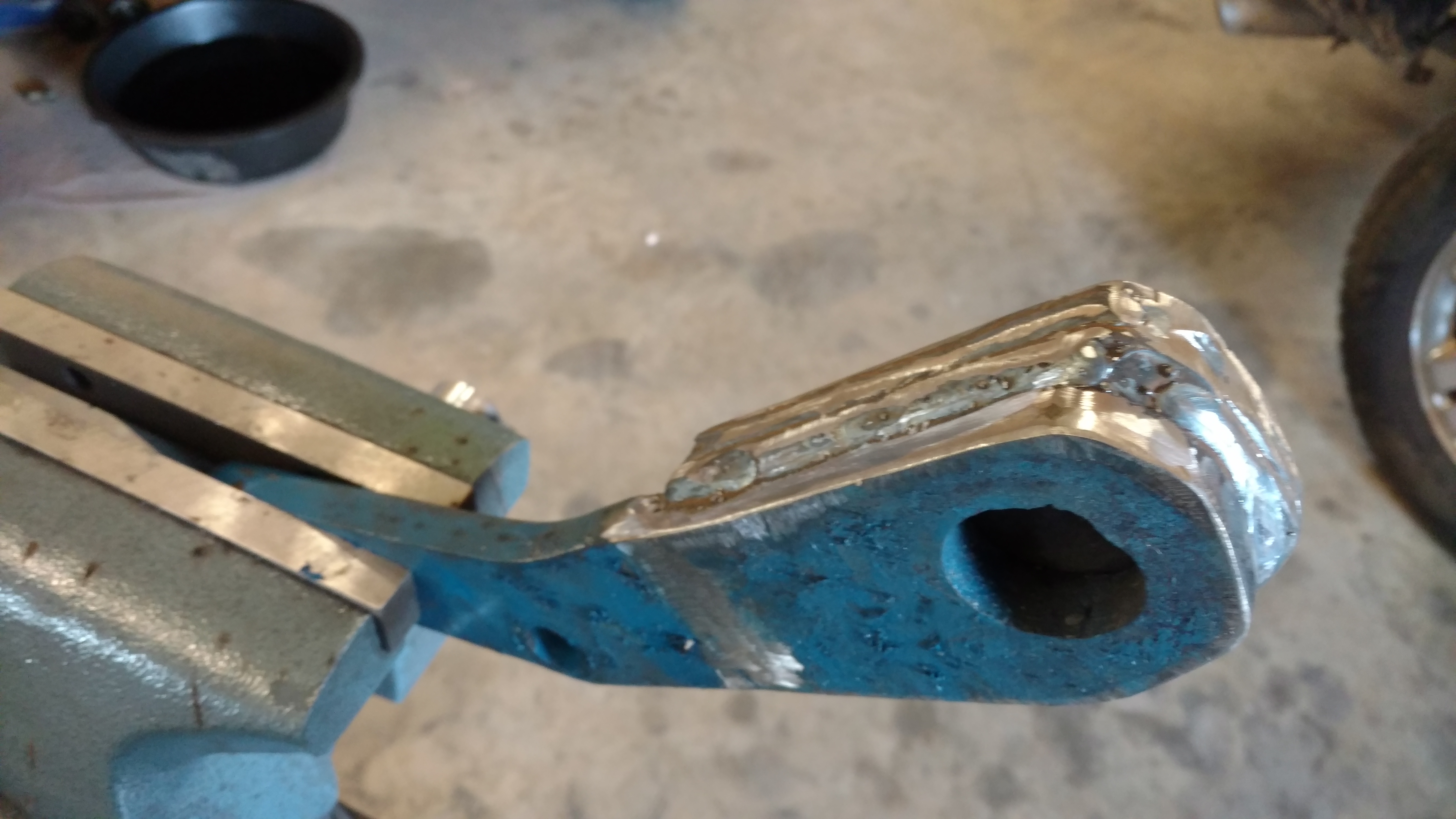

This is a quick shot of modifying the front mounting bracket to effectively move it 3/4" to the rear. I see a Ford 2310 3 cylinder today and both engine blocks are about 18" long but the front bolster was very different on the 2310 than our 3000 but similar to the one on our 3600. As noted by Soundguy mounting a 711 one arm loader on a 1965+ 3 cylinder Ford tractor can be a challenge at best.
If the bracket modification goes well by Friday evening hopefully the loader will be functional so we can start rebuilding the bucket.
