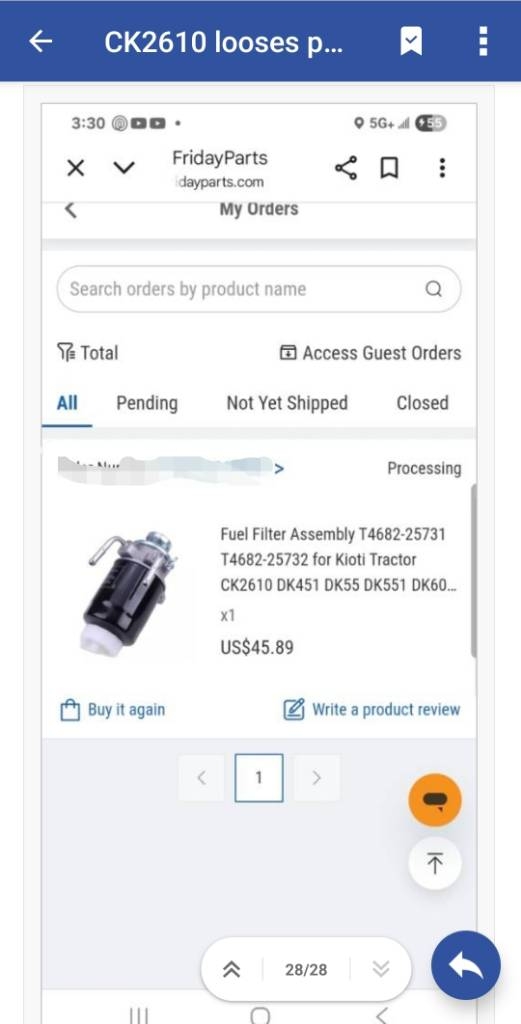

Im going to drain the tank, change the filter again, and seal up that screw on water separator.
Edit: Did some looking, and a filter is about $19, or the whole assembly, bleed screw, primer, water separator, with the filter is $45; so, gonna replace the whole dang assembly.

I had the exact same problem with my 2610. After changing out the new filter I noticed that the purge pump on top of the fuel filter assembly didn't do anything when I opened the screw and pressed on it.
It all cleared up when I replaced that fuel filter assembly.

Took about 4 minutes to swap the filter assembly. Now, note, im sitting a full right now, but it primed quickly, and started right up.
12mm; ratcheting wrench for the mounting screws; the left side one, you only have about 8 degrees of swing, so I'd hate to use a normal wrench.

So, I guess ill give an update, after replacing the entire fuel filters assembly, things were great for a bit. Then it started acting up same as before. I took the fuel supply side off the filter assembly, and blew compressed air through it, and it ran Great, for a bit. So, today I drained the entire tank, blew the line back out, and put fresh fuel. I currently is running good.
So, when draining the tank, i ran it through a paper towel and got this. In addition, I also got a small piece of a leaf out too. Also, as mentioned, today, when I took the supply side off, to drain, it drained good for a maybe a minute, and then down to next to nothing, Until I removed fuel cap.
So, im thinking, yes, I have a fuel cap venting issue, I had a partial blockage of the pick up as well.
Was replacing the primer and the assembly necessary, maybe not, but I think it was, as the old one would not suck fuel to the filter when priming
