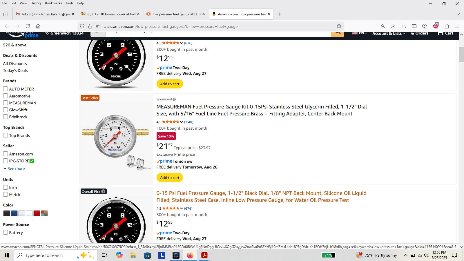

One method to see what's going on would be to replace or add a section of clear fuel line to yours one at the bleeder return and on in front of the injection pump or after the lift pump, teeing a low pressure fuel gauge into the line prior to the injection pump will also establish if that is working.

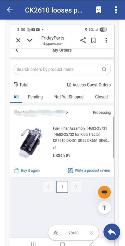

Im going to drain the tank, change the filter again, and seal up that screw on water separator.
Edit: Did some looking, and a filter is about $19, or the whole assembly, bleed screw, primer, water separator, with the filter is $45; so, gonna replace the whole dang assembly.
   / CK2610 looses power at half tank fuel #29
I had the exact same problem with my 2610. After changing out the new filter I noticed that the purge pump on top of the fuel filter assembly didn't do anything when I opened the screw and pressed on it.
It all cleared up when I replaced that fuel filter assembly.
