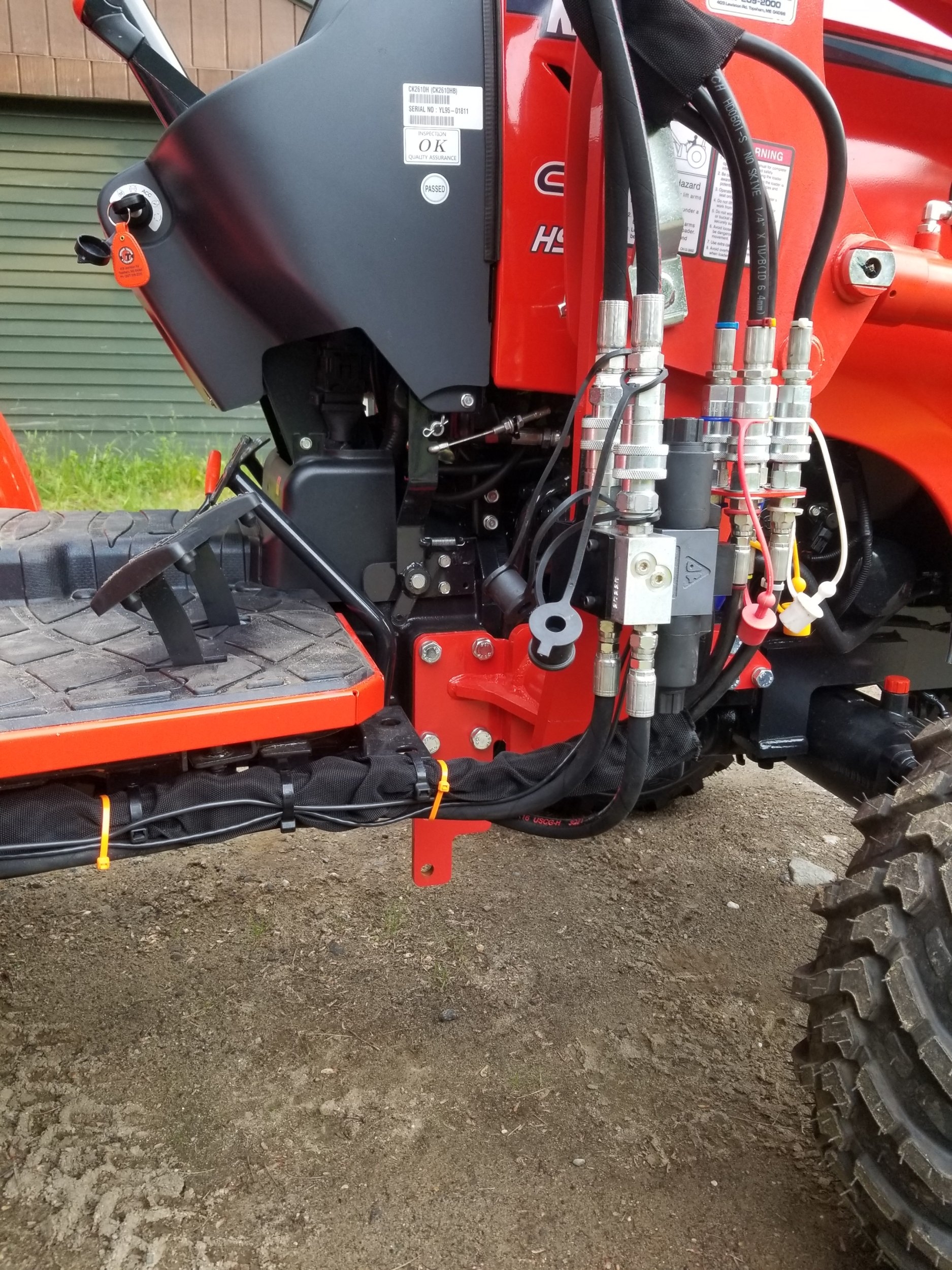

Bill makes a great point, check the simple things; wires, hoses, these things are left to the dealer to route properly. Hop on TractorHouse and look at brand new CK's and you'll see a wide range of dealers. Some tractors will have everything hanging low and exposed; one that was assembled with love won't.

Thanks for the advice everyone. I was mostly going to take it to the dealer to give it a good check over since I’ve never owned a tractor before. Most of my “wrenching” has been on my atv but very minor like winch install, brake pads, calipers, and new rotors. And to get a 3rd valve installed for a grapple but maybe I’ll just have them install the valve and pull the trigger and do the service myself. Pickup all of the filters at the dealership.
