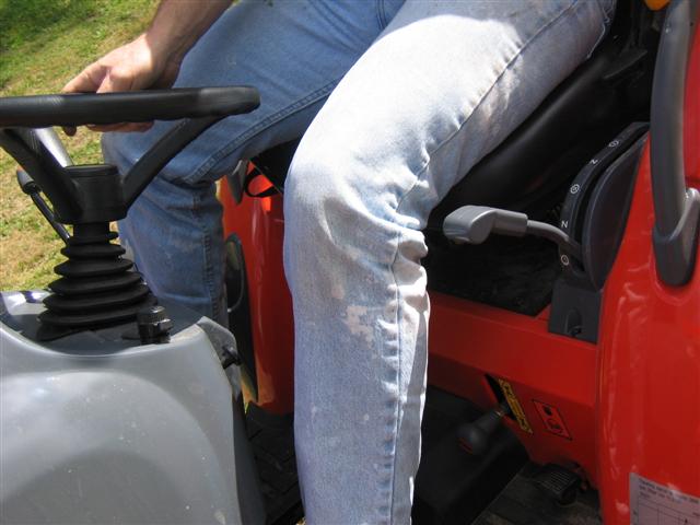

Heres the picts of my leg in relation to the shifter.

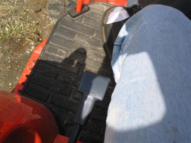

#27
Heres another angle of shifter pict. /forums/images/graemlins/shocked.gif
   / CK30HST near death experience #28
No doubt about it being in a bad position. Looks like you would catch your leg on it even when getting on and off the machine. Being in a hurry getting on and off might result in a nasty bruise on your leg. /forums/images/graemlins/mad.gif
   / CK30HST near death experience #29
TL,
Glad this got moved to the "Safety" forum. I like the detail in your picture, especially the open toed sandles on a tractor... /forums/images/graemlins/smirk.gif...just yanking your chain.
Seriously, although my 4115 does not have the same problem with shifter proximity to the knee, shifting in, and out of low is not as positive as I would like. Numerous times, working on my sidehill, I've had to shut off the tractor, or just put it in neutral for a few minutes (bucket and RB solidly anchoring it in place with wheels turned hard and brake set...). When I would start back up, I found I'd better try a little reverse, after shifting into "Low", to be sure I really was in low, not still in neutral. Amazing how fast one can start to roll down a hill in neutral! I love the HST but, some form of shift lock shouldn't be that hard to design. Numerous auto's have had various designs to reduce the chance of changing gears unintentionally (i.e. pull back, shift up/down for column, pull left or push right, or pull up or down for a stick... Designs have been around for many, many years.
Tom
#30
I was just being a tractor model that day in the pict. I didn't run it. Sorry for the lack of safety gear. /forums/images/graemlins/grin.gif /forums/images/graemlins/grin.gif
