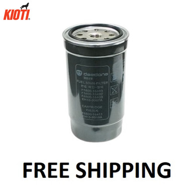

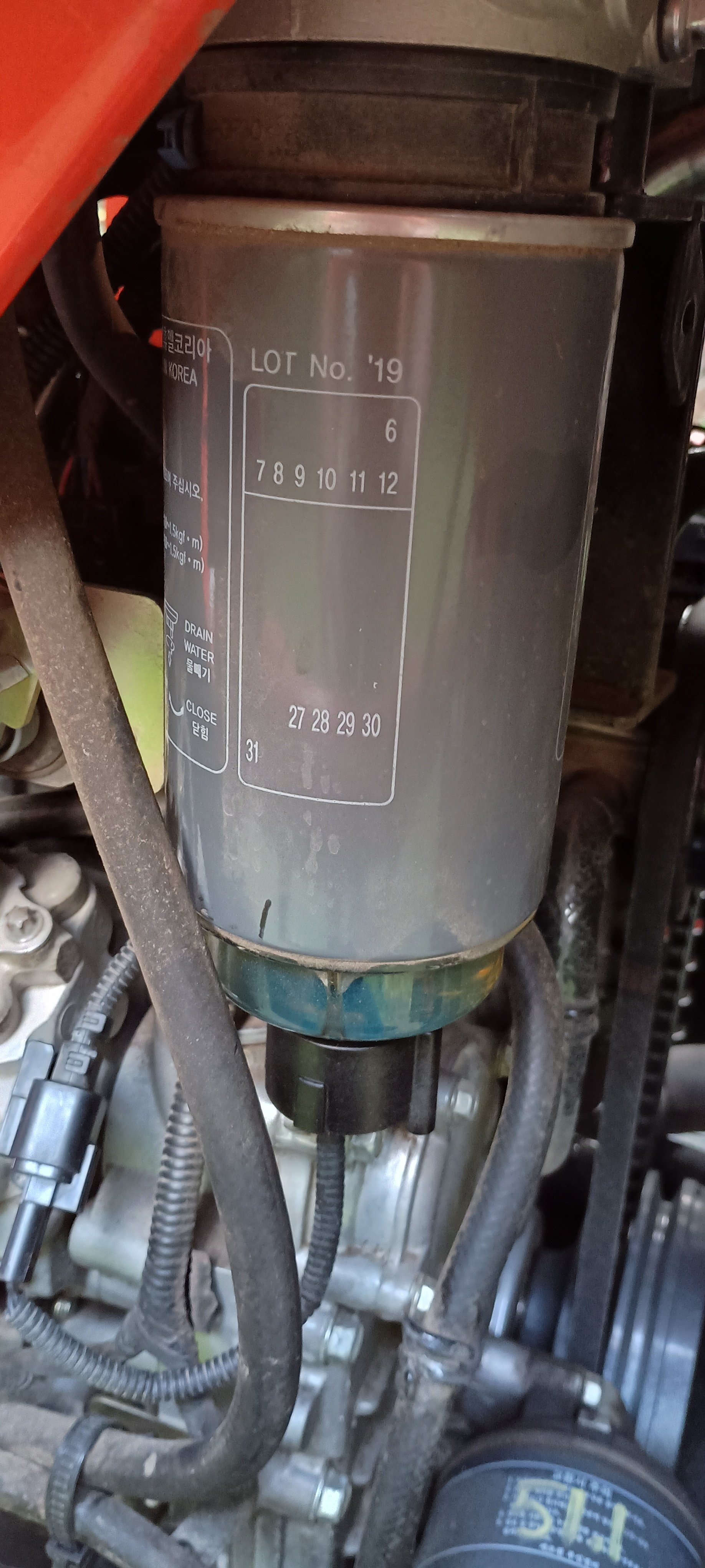

Tractor is a 2020 CK3510HSE (hydrostatic, SE, open cab)

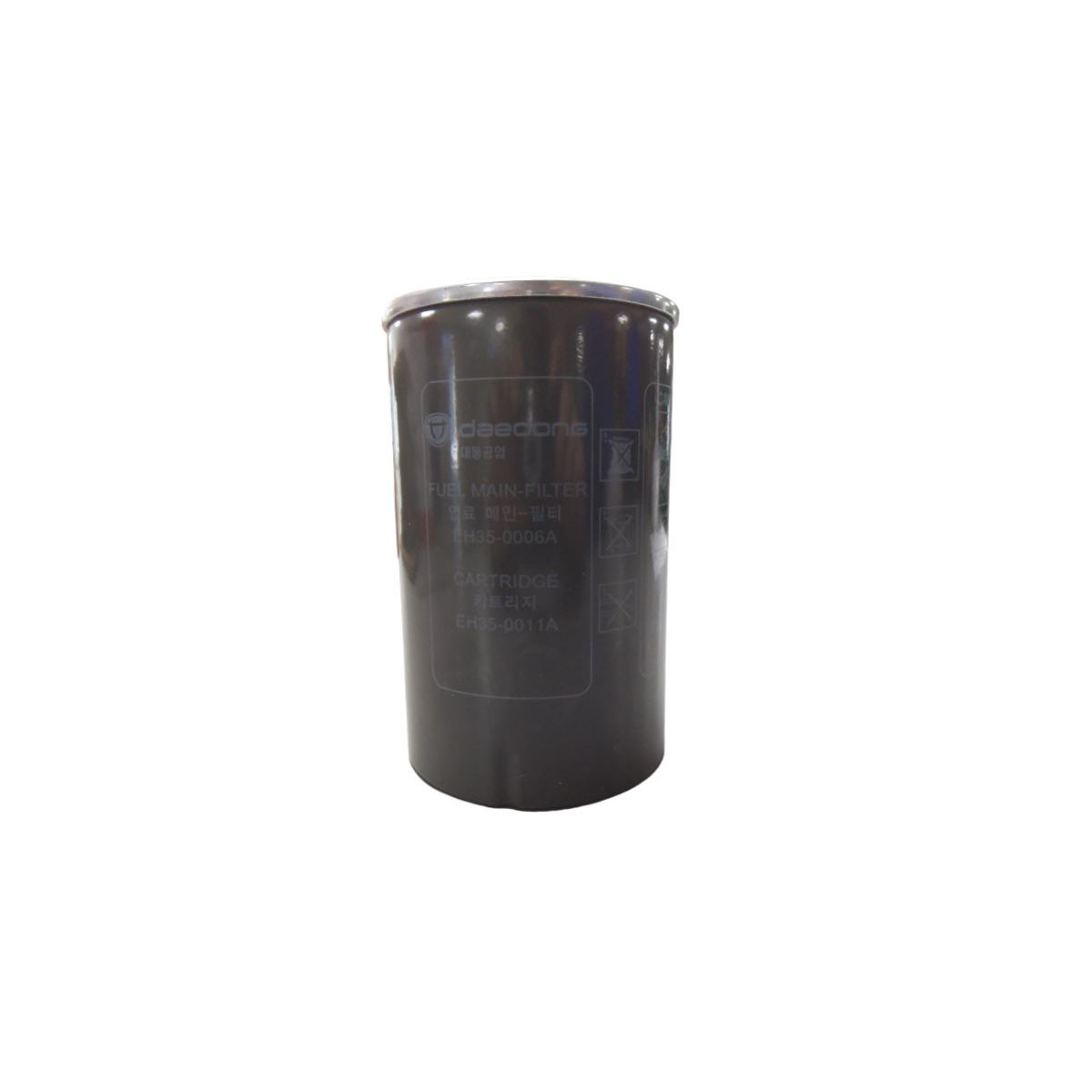

Seems to be a lot of reference for the F6800-16411 fuel filter, including my own manual.
My tractor has a clear bowl and water sensor on the bottom. Looks like EH35-0011A based on what I was able to get from a cellphone pic (side with numbers is towards engine).
Why is this so damn hard to find?

If you are looking for the whole Filter Kit, look for the 'Stage 5' versions. As far as I can tell, they have 2 different Air Filters depending on when it was built (serial range):
This is an OEM filter kit which includes the air filter TC26-1869A, engine oil filter E6201-32443, fuel filter EH35-0011A, hydraulic filter T2185-38031, HST filter T5855-46531. The distinguishing difference is that the air filter cover is held on with one plastic clip. The fuel filter has a clear bowl on the bottom

If you have the single Orange air filter housing clip and the Clear Bowl fuel filter, the Nolts Power kit I listed is the correct kit.
You have exactly the same tractor as mine - a 2020 CK3010HSE - and the manual is incorrect.

I don't recall an orange air filter clip, but I do have the clear bowl.
No dealers super close, so trying to order online
   / Ck3510HSE Fuel Filter? #10
Main thing is that its a single clip and not the normal 3.
