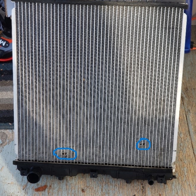

Soooo... happy day. I went back to dealer with rad. Spoke with manager, and as luck would have it, service guy and mechanic were there too. New rad on order, and dealer and kioti figuring out payment. They couldn't believe a rad could leak in 3 years either. So I took it out of my trunk and said "me either". But there it was, a rad with 2 holes from the inside. I also had mentioned this coolant leak 3 times with different reasons why it happened throughout the last 1-2 years.
As for a direct tractor/part, the Bobcat CT235 is nearly a CK3510. Nearly. Electrical and wiring is apparently different, the Bobcat part number is 7000258. Unfortunately, its $990 CAD from Bobcat.
I might also add, I am happy I let the rage die down before I had a constructive and rational conversation with my dealer.

Did anyone verify pH level of antifreeze in the unit prior to replacing it. If the pH level becomes acidic it will eat up the radiator first then work on block. You can use ohm meter to determine if the antifreeze is becoming acidic one lead in the antifreeze and other on known ground. If reading above .4 ohms it’s becoming acidic and needs to be changed. Three years same antifreeze on tractor shouldn’t be a problem but it can be based on different alloys it is touching within the motor and radiator especially true if the tractor sits for extended periods. Yes that failed radiator would not sit well me either. however you still need to determine root cause or it could happen again.

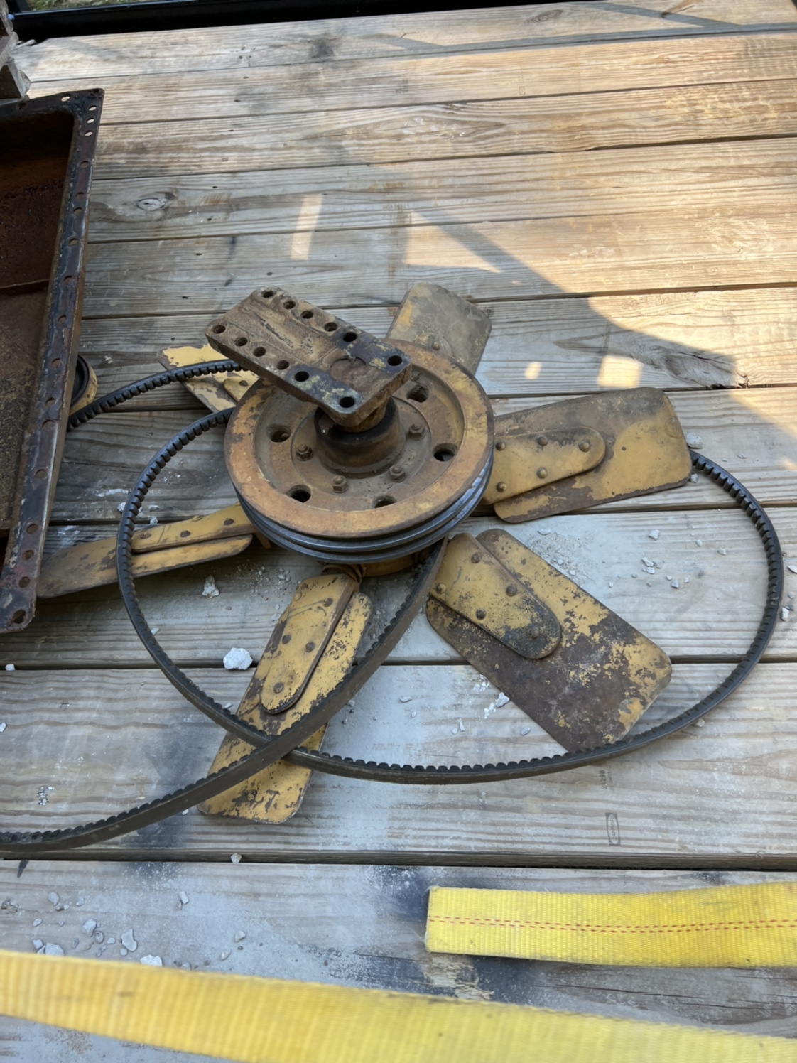

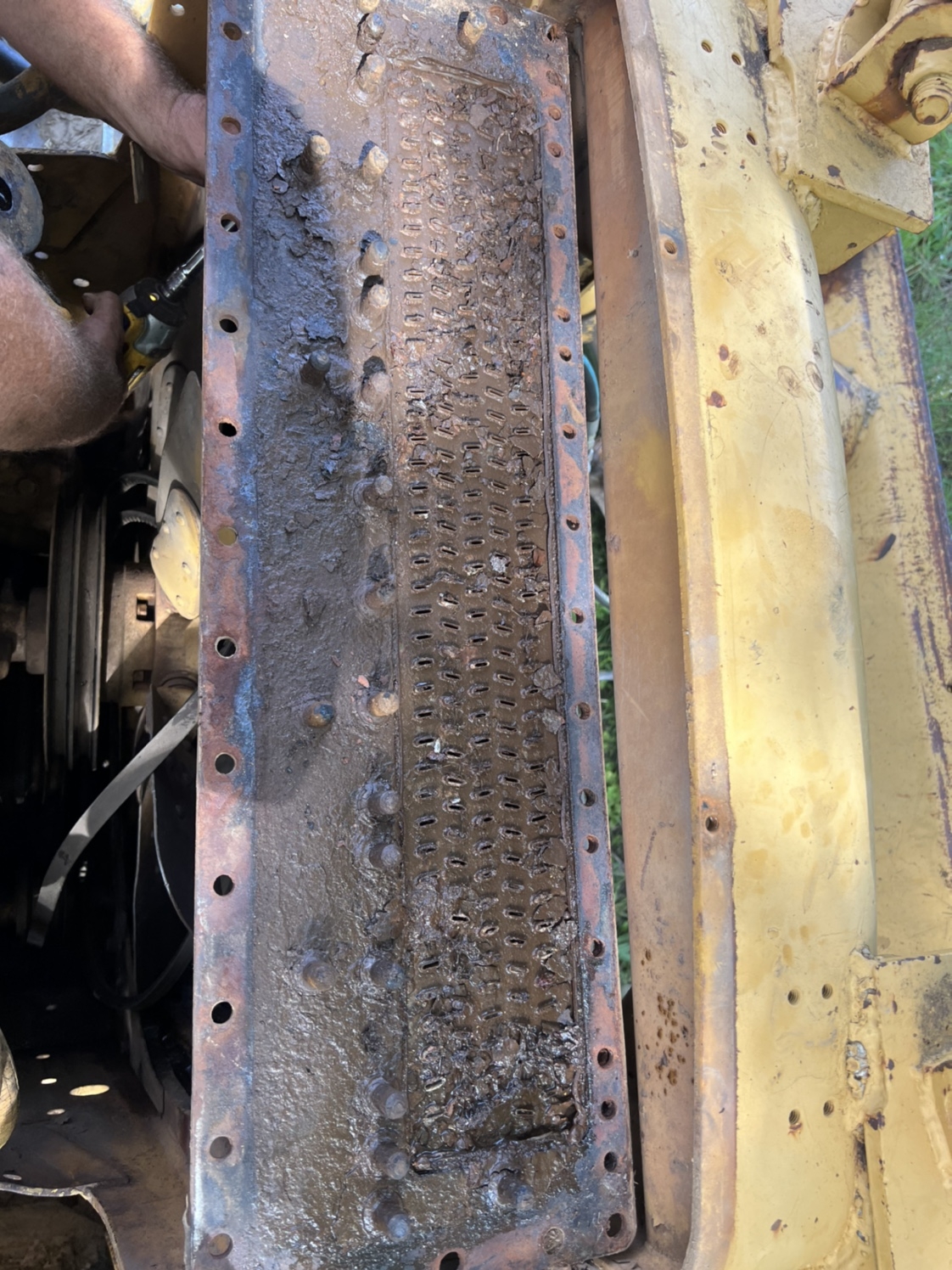

I had to remove the radiator from my dozer and work on it. The core is brass but the tanks on the end were steel. Based on the organic matter in the radiator it was probably running pond water for quite sometime. But another major source of contamination appears to be rust flakes from the steel tank. The top tank isn’t fully submerged so even if it did have the proper mix of coolant and distilled water the top tank would still rust. It’s also nearly 50 years old so they must’ve done something right. The fan is no joke, you can tell it’s from the built to last era.
