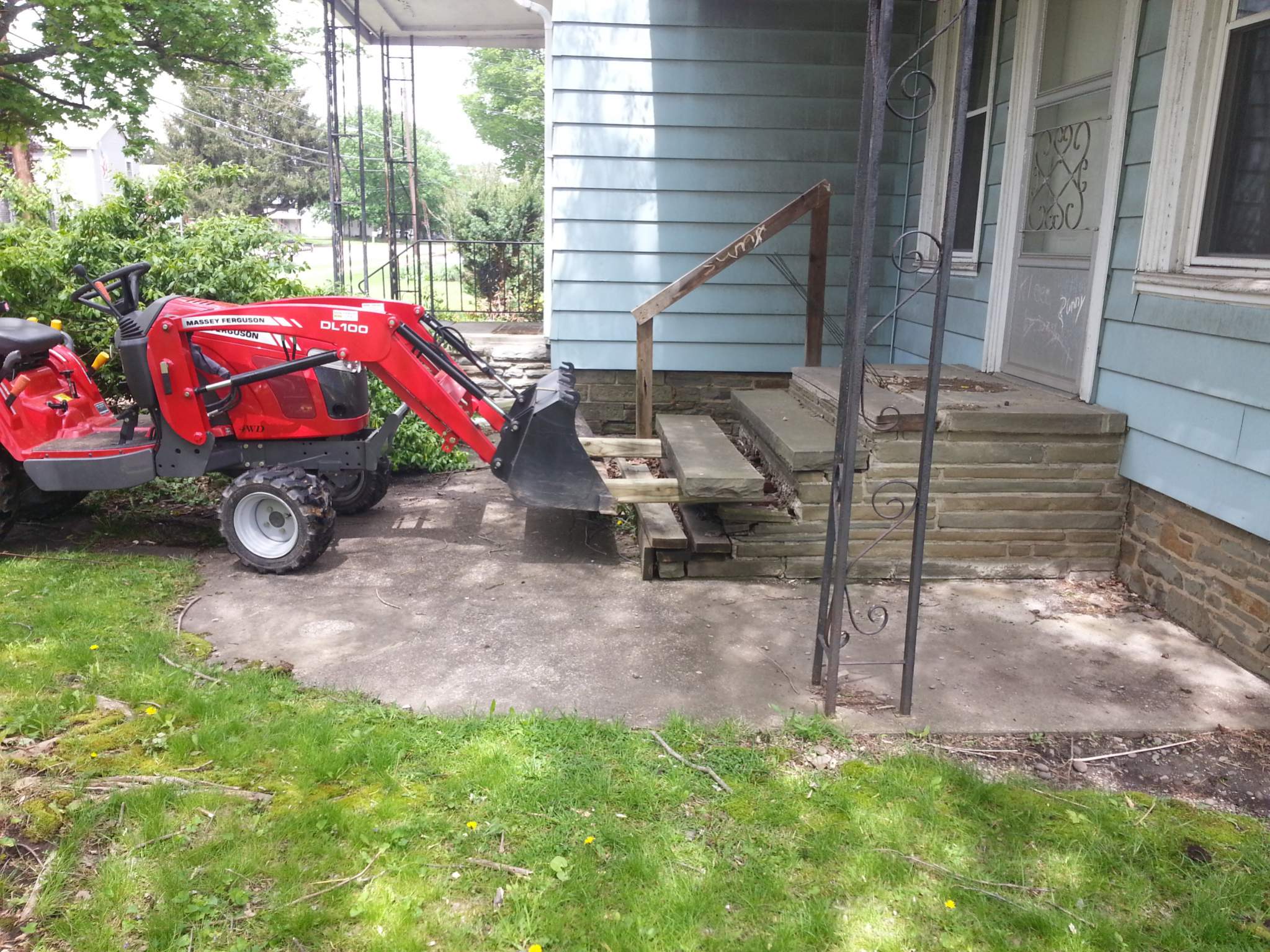

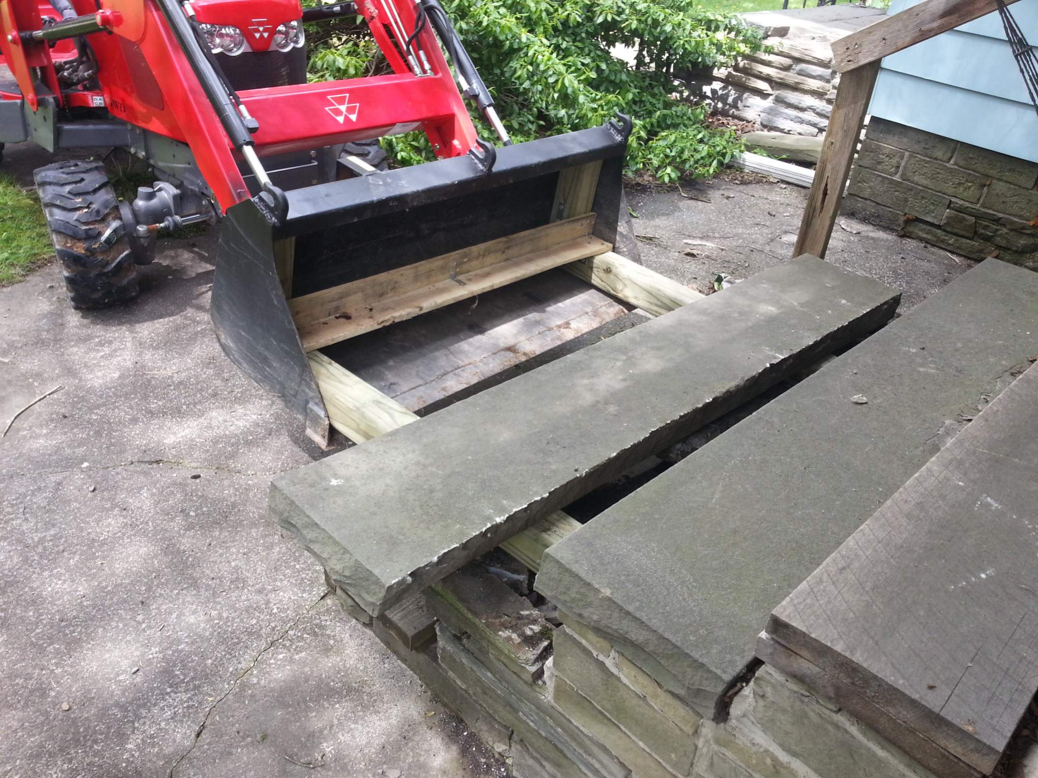

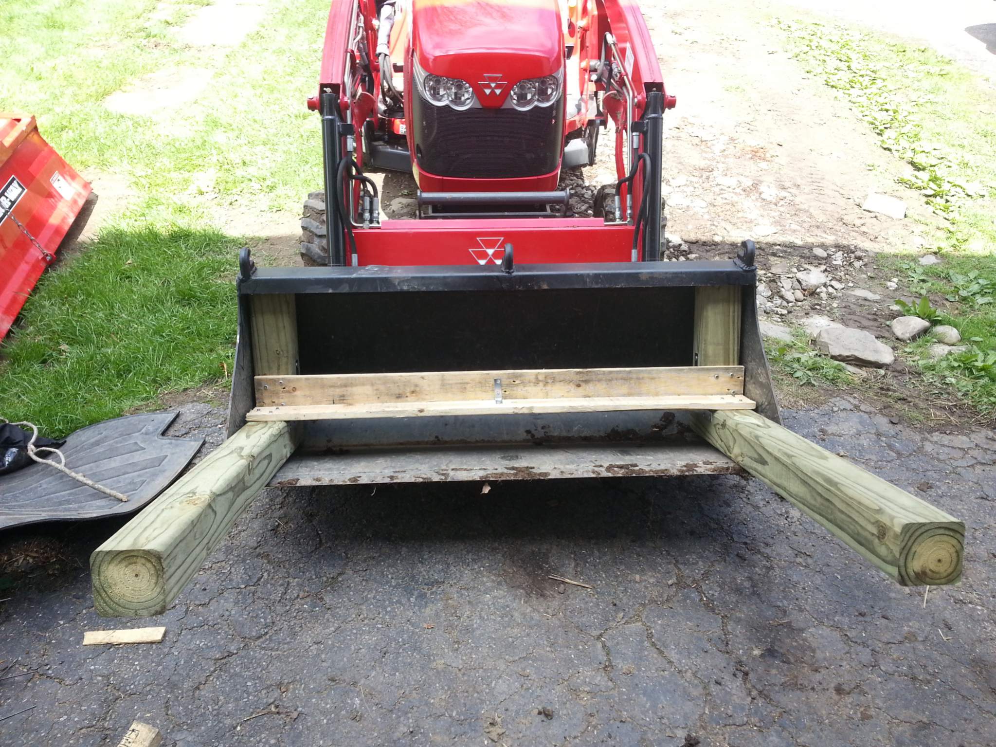

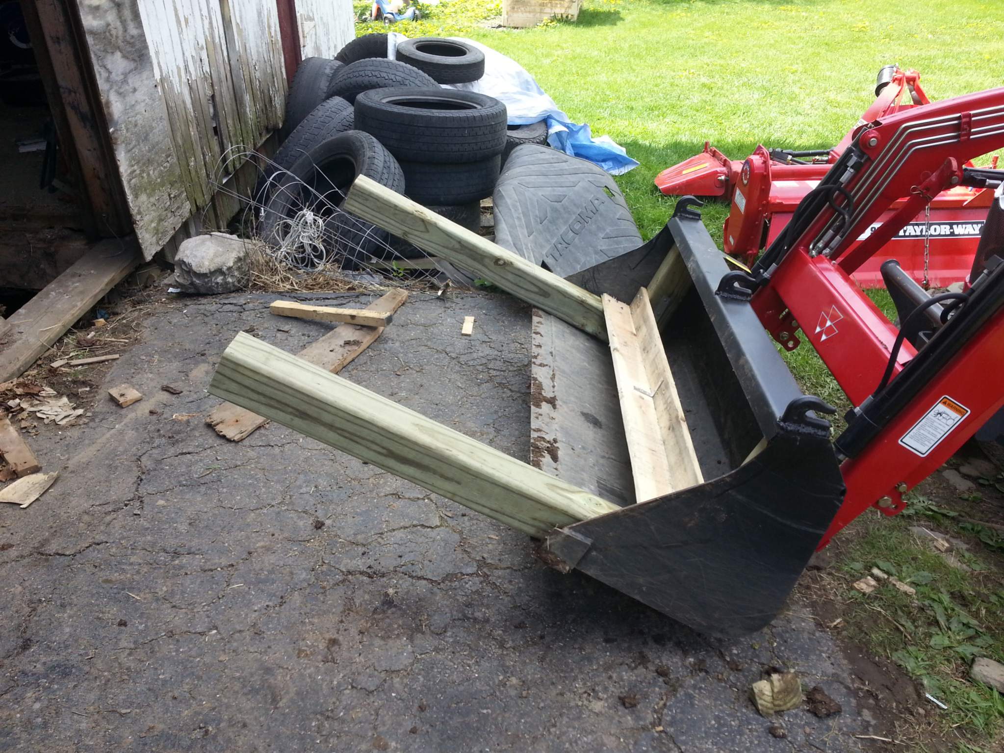

I needed something to help move the flagstone steps to tear them down. Not clamp on, but they don't shift side to side. Just need to tilt them up to remove them. Cost maybe $20 tops between lumber and angle braces.

That looks like it did a great job, and no one can say it's not sturdy.
While we were looking for forks, I used C-channel held tp the bucket with c-clamps for the stuff we needed to move rightaway., not pretty or awfully sturdy, but they get er done.
Way to go,

Thanks! I saw a youtube of a guy that took a couple 2x4's, and sandwiched the bottom of the loader between them with a bolt. Simpler than mine, but I kind of like not needing tools to take mine on and off. They just happened to be wide enough to set those stones down on bench by our fire pit, back out, and go back to work. They're perfectly positioned to pick up again later when I get pavers or stones stack for legs to turn them into 2 more benches around our fire pit.
