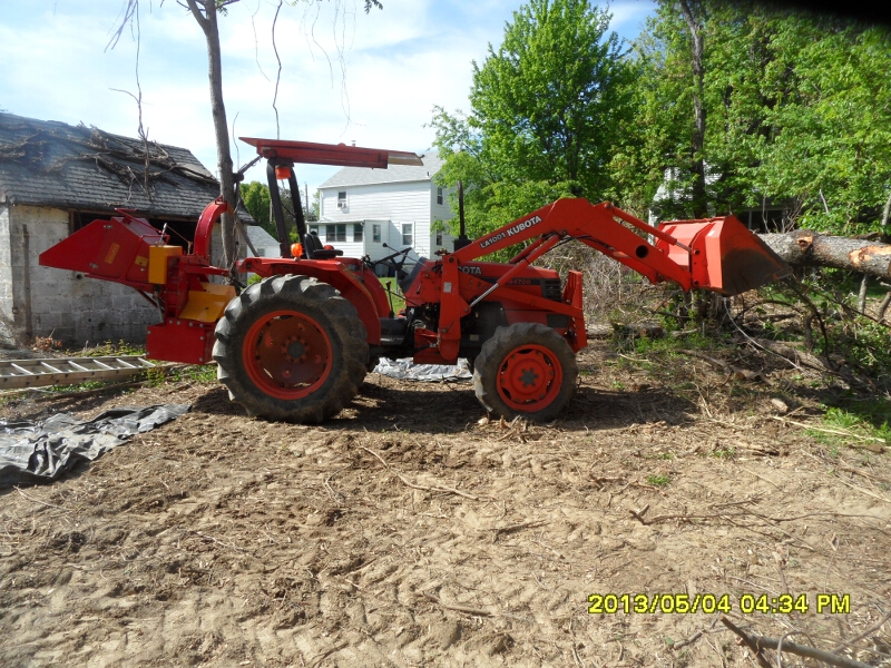

I just bought new clamp on pallet forks, 1500 lb rated, with stabilizer bar for $169 shipped to my door. Used them Thursday to move my 800 lb chipper (which is on a pallet) with my M4700.

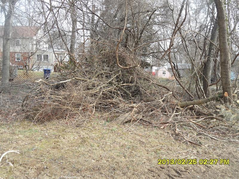

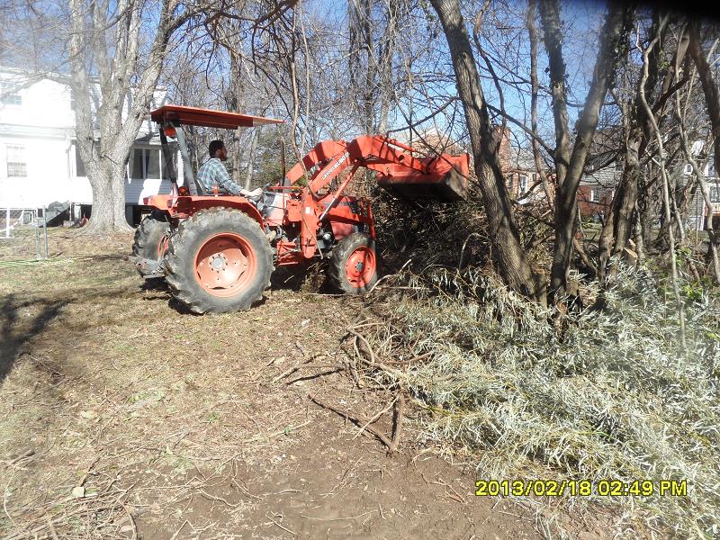

I originally bought a pair of the 4,000 lb rated forks for my M4700 w/ stabilizer bar, last year. We used them a LOT in Virginia. Their main use was as a root grapple and we piled a lot of brush and they worked rather well for the $240.

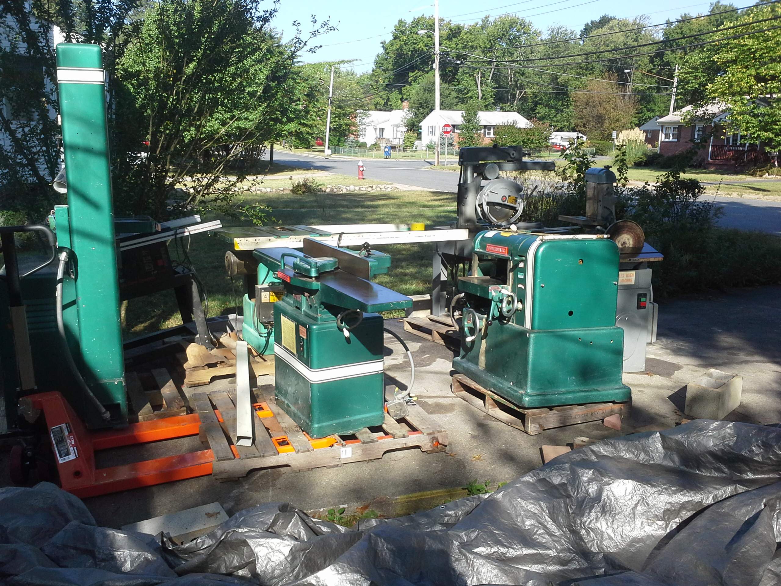

We also used them for moving a bunch of HEAVY palletized equipment, the planer pushed 1300 lbs.
