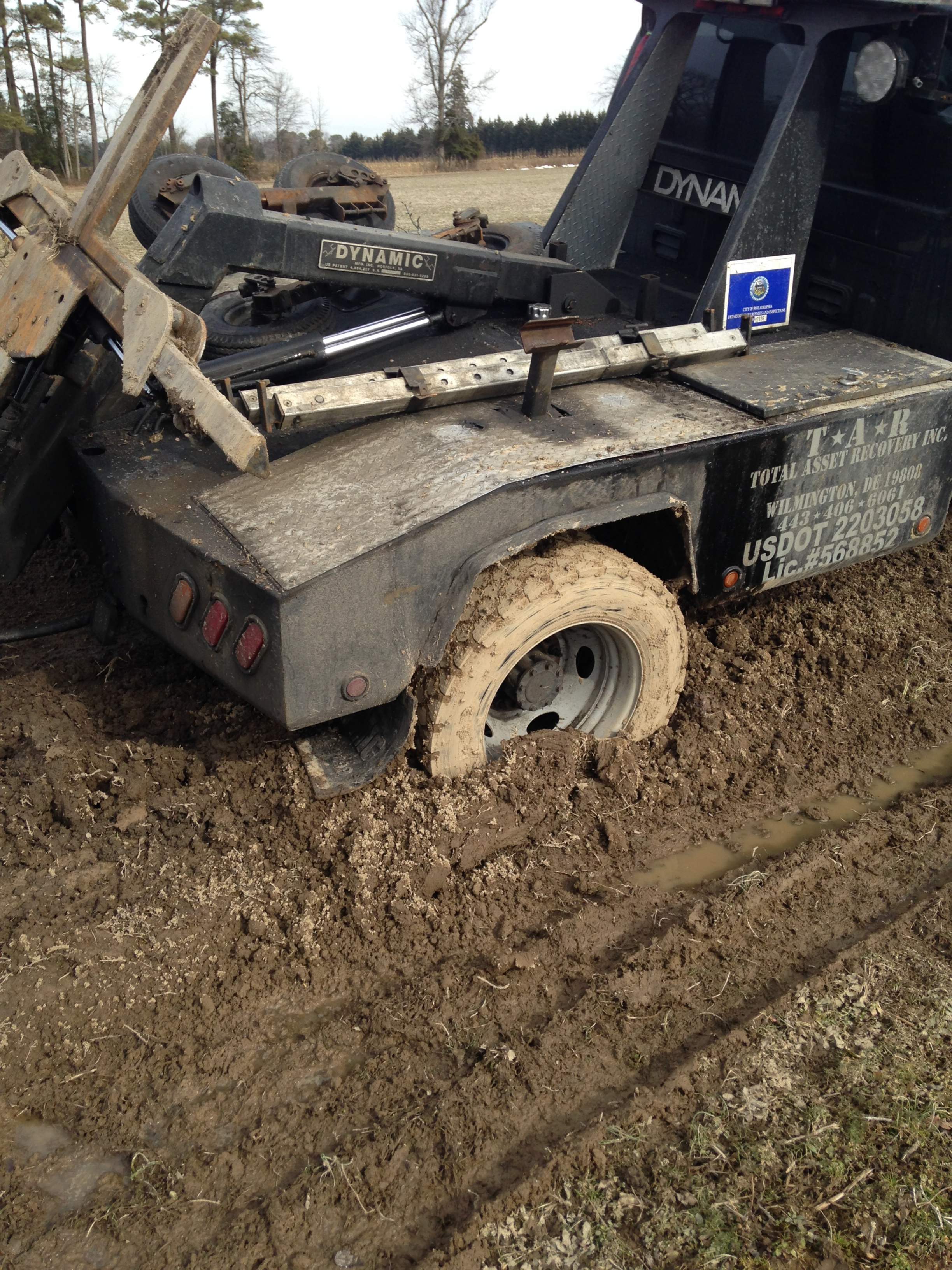

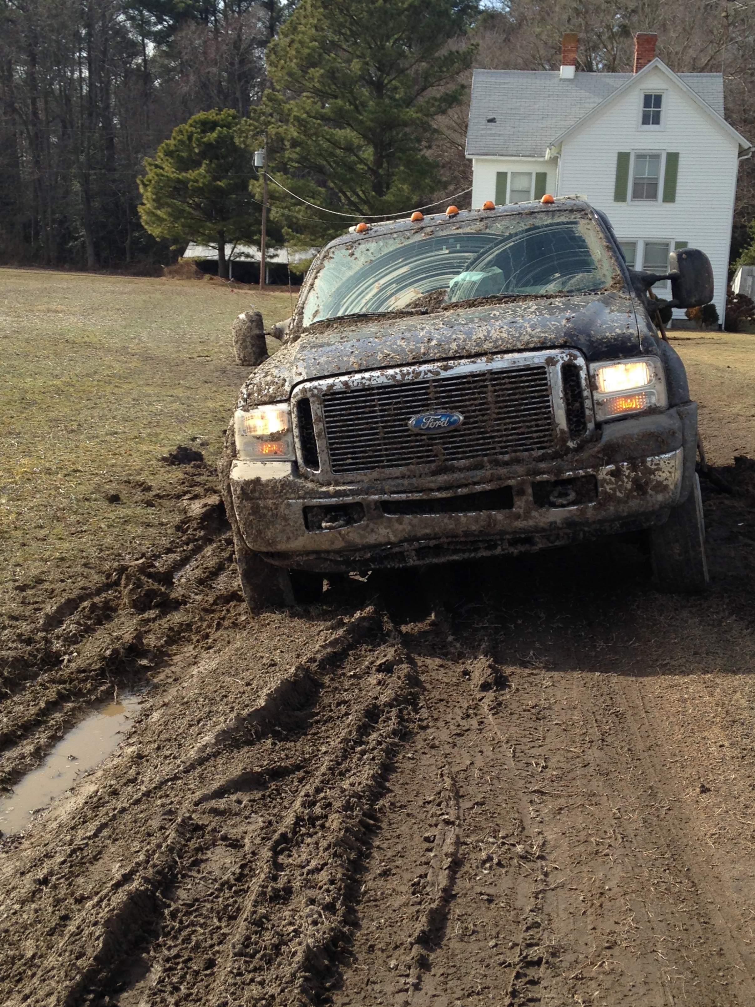

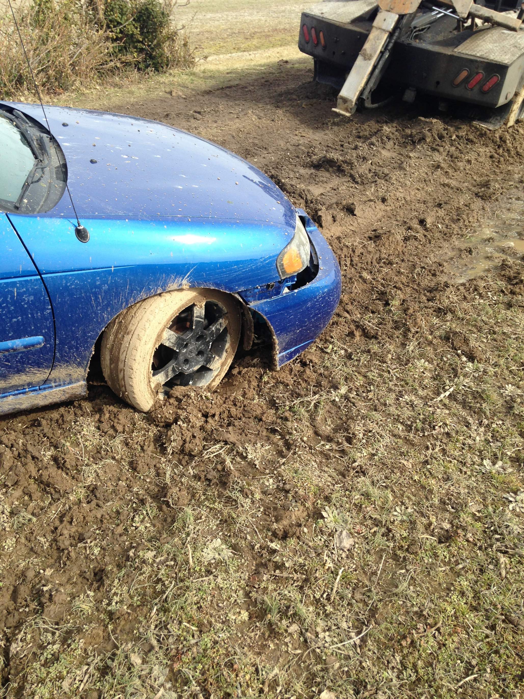

We are trying our best to deal with this! IMG_0498.jpgIMG_0500.jpgIMG_0506.jpg

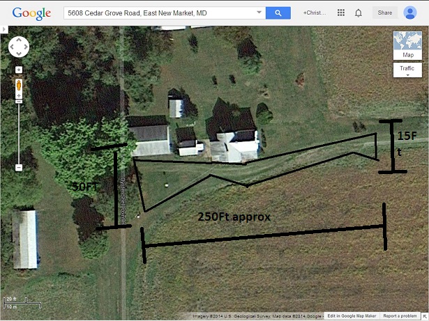

Artist I am not,I just took some crude measurements and heres a picture of where we are getting driveway. Whats your opinion on how many loads it will take? How thick is it generally laid? Was yours done in one day?

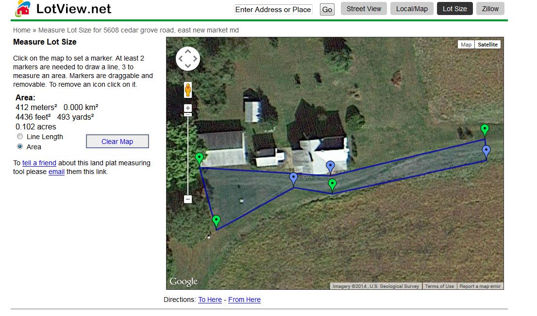

check this website out, lotview.net allows you to mark out an area to measure area.. or you can do just straight lines,
i use it all the time. here's what i came up with using it with your drawing (best i could mimic)

Mine is around 140' by 16' with 2 turnouts one single and a half wide, one two cars plus wide, mine was $2250. I had a good hard base below mine and that helps. He did all the leveling and prep work and had it all but about half a load done in one day.

I don't know how thick, but I'd guess 3"-4" most places, mine is two years old now and where we've driven on it daily the area our tires goes over is like concrete.

Based upon Dutch's measurements, 60 yards will finish off at about 4" compacted. Of course, shells may pack more or less than gravel, I don't know.
