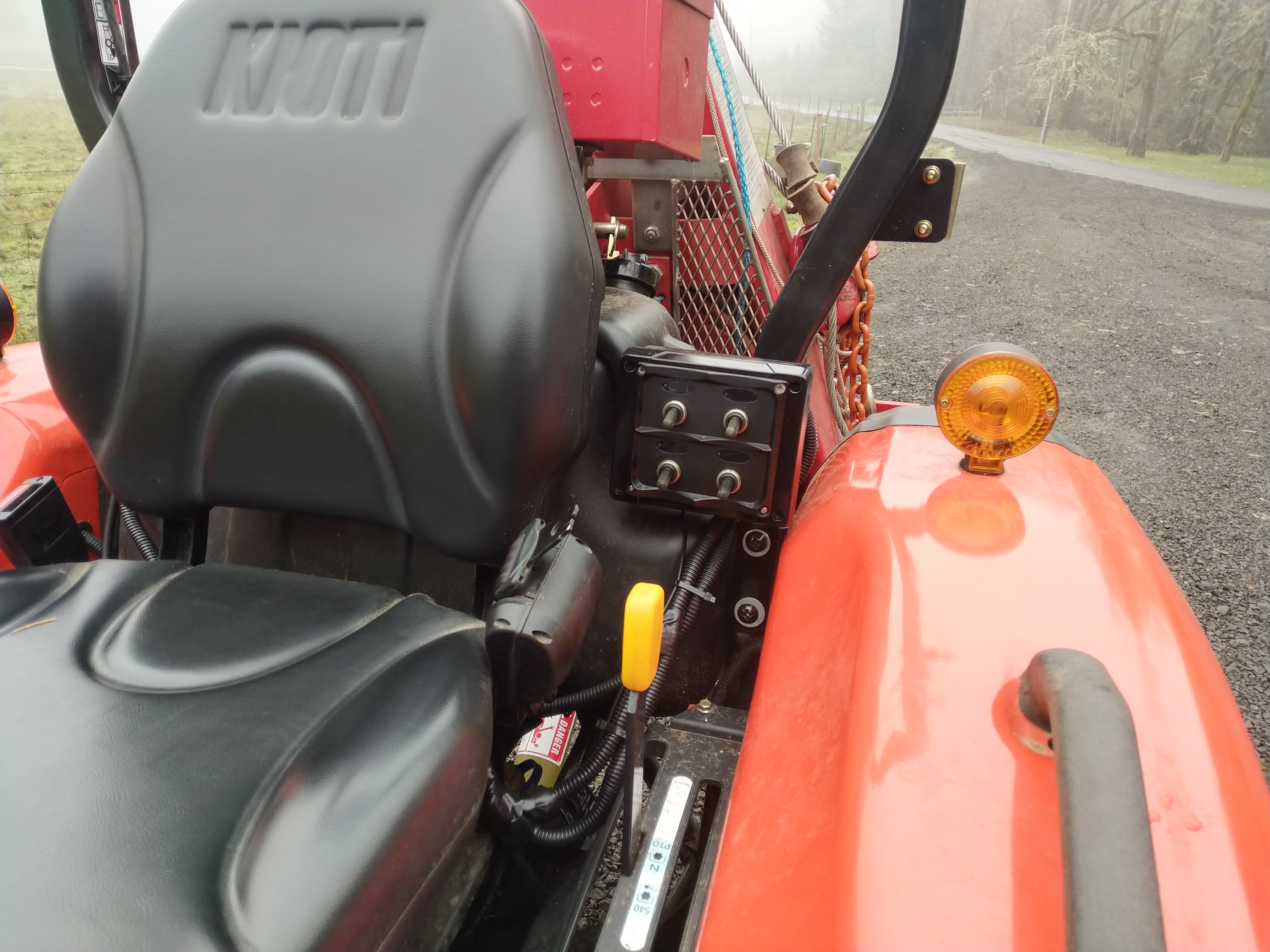

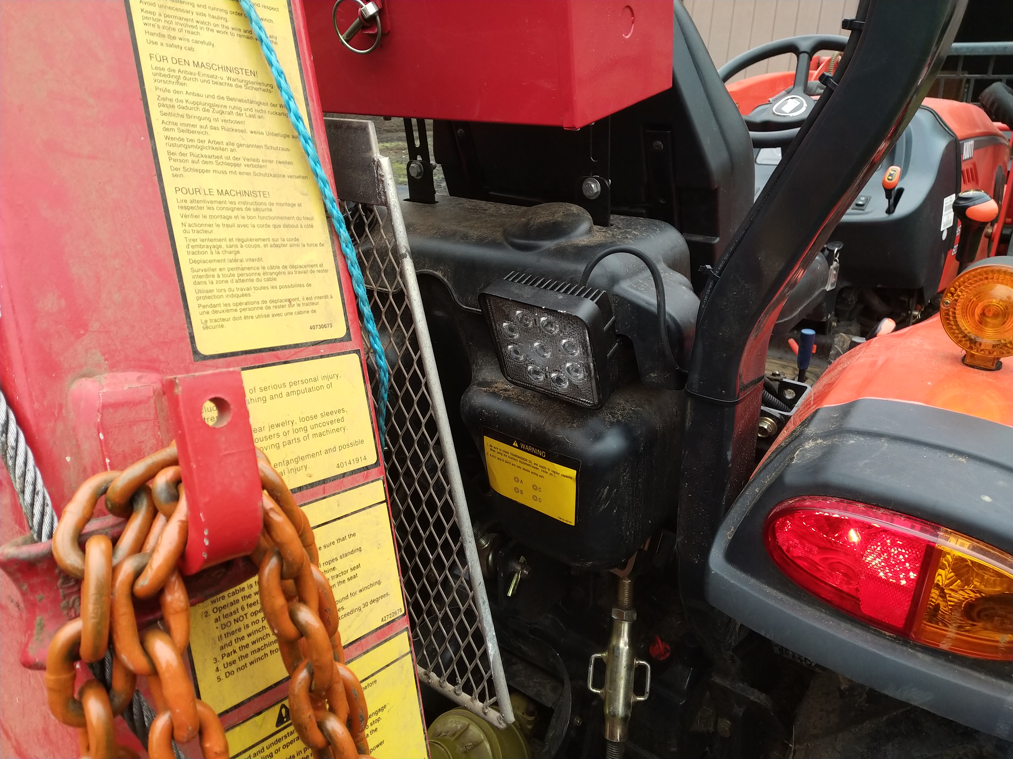

Here is what I did on my Kioti. I power cable from the battery to two relays. The relays then feed a marine grade switch panel. I have two LEDs mounted on the ROPS pointed forward, one mounted rear and one on a swivel kind of behind seat that I point at the PTO.
IMG_20171216_093738.jpgIMG_20171216_093742.jpgIMG_20171216_093749.jpgIMG_20171216_093753.jpgIMG_20171216_093801.jpgIMG_20171216_093809.jpg

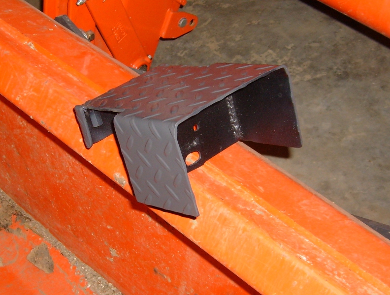

I made my own brackets that clamp on. Since I'm in the woods quite often I made them out of 1/8" diamond plate steel so they can take a beating without putting any stress on the lights.

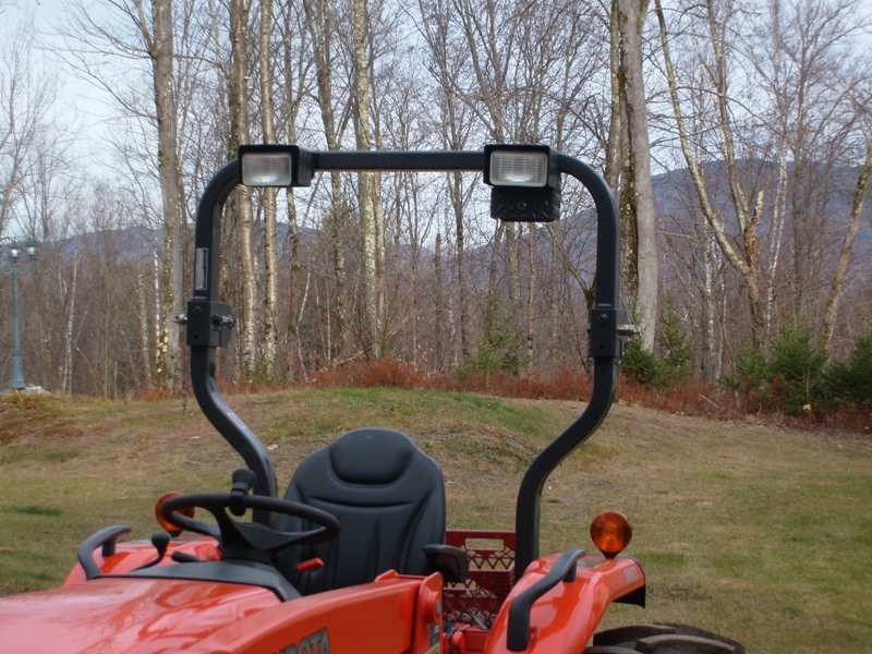

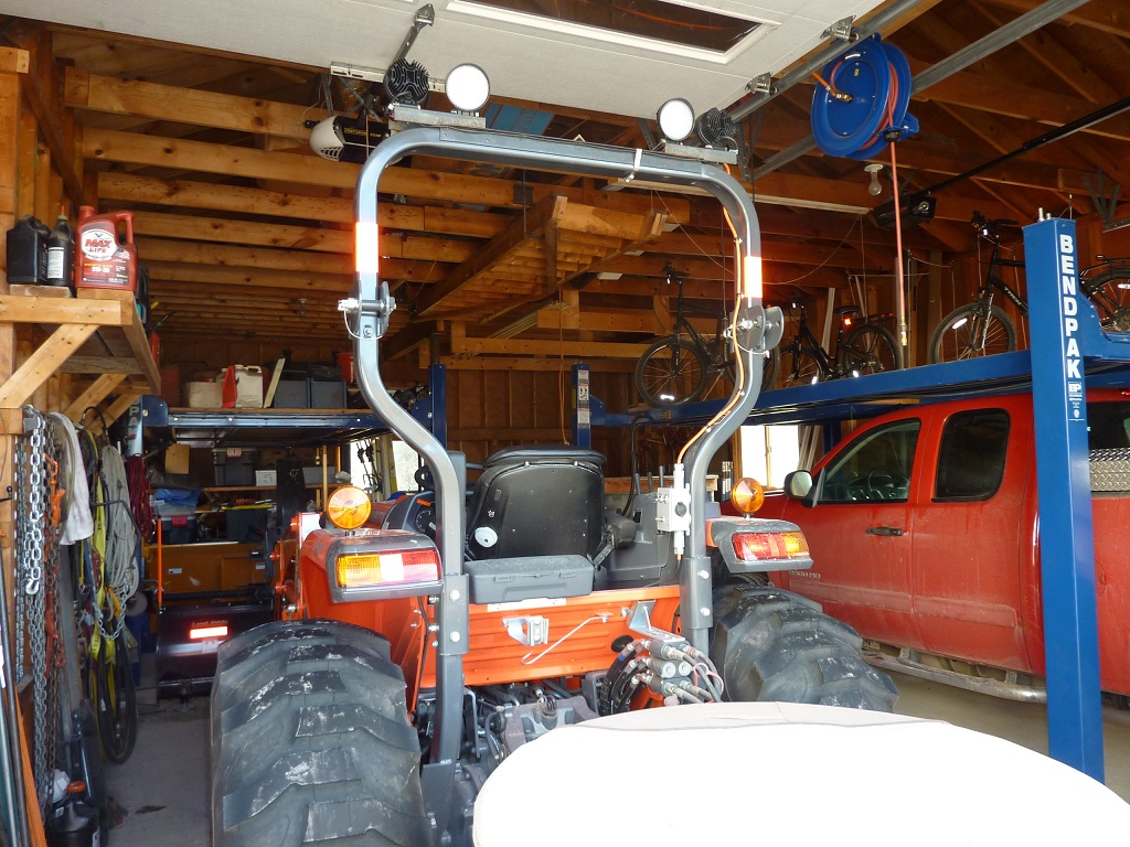

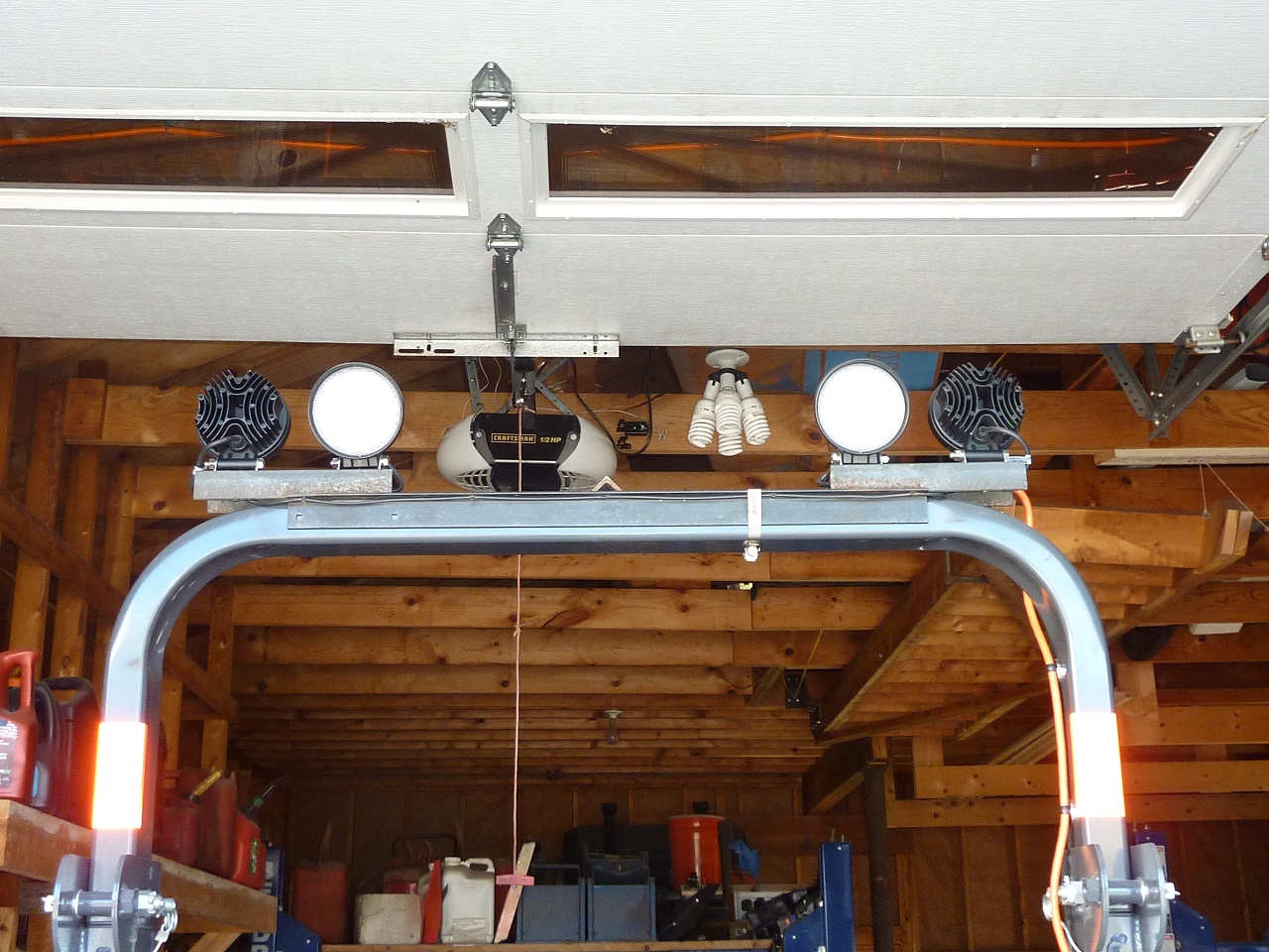

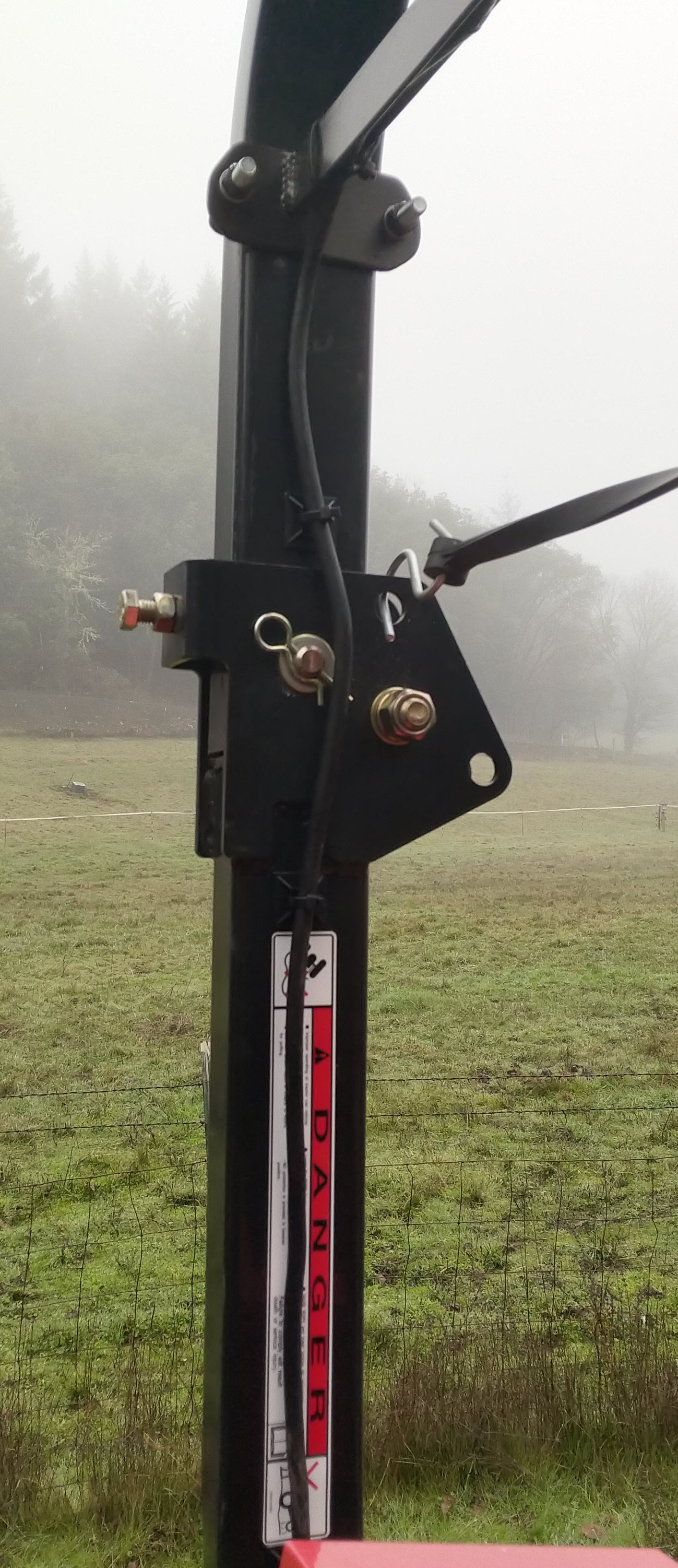

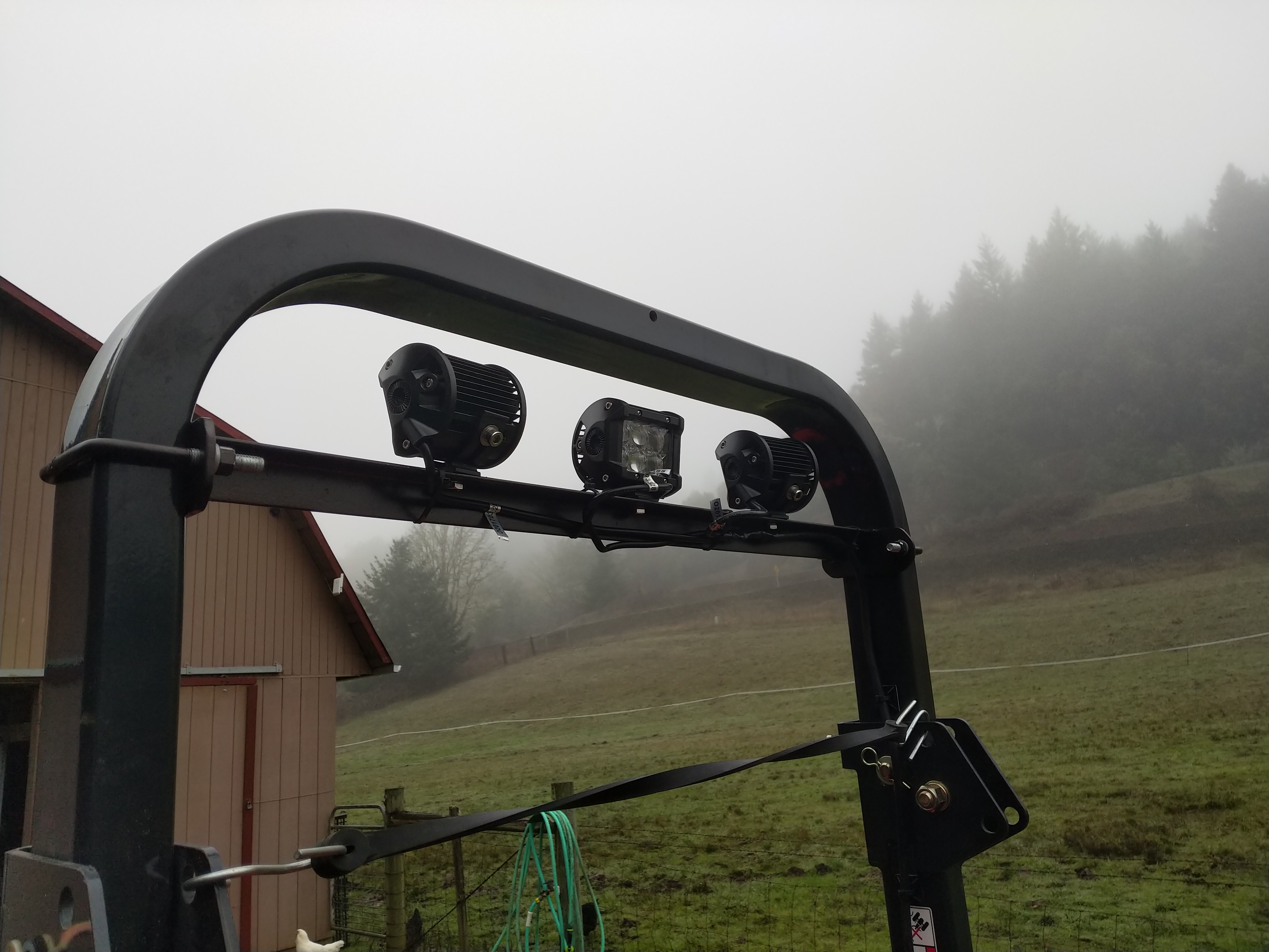

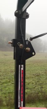

I made a bracket that sits on top of the ROPS. It's made from an old T rail from a garage door opener with a couple of pieces of channel iron tack welded on each end. It's a tight fit on the ROPS and stays put without fastening although I do occasionally use a hose clamp as a backup. The switch box and wiring are held in place by magnets and the whole rig removes in seconds without tools. I powered the lights via a cigarette lighter socket wired to the tractor aux lighting circuit.
I take the lights off when not in use so I'm not concerned about damaging them on branches. BTW, I did have an older setup with the lights mounted under the ROPS for protection but busted them anyway on a branch. Taking them off before going in the woods is the best protection. The ROPS can also be folded without removing the lights if necessary.
The pictures shown are with the lights on my L6060 but they also fit my MX5800. The ROPS on the two tractors have the same dimensions.

Nice setup!

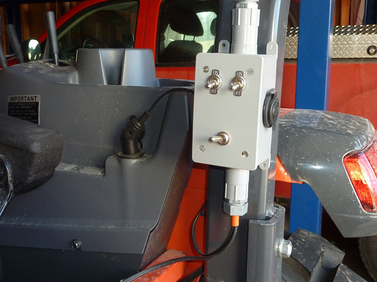

It looks like a single wire going up to the lights? Do you have the front and rear on at the same time?
Mine are split, so I can avoid blinding someone driving by as I'm clearing the driveway.
   / Clean light bar on ROPS? #40
Nice setup!
No, the front and rear are on separate switches to avoid blinding drivers when plowing the private road.
The single wire is a piece of an old extension cord with 3 conductors. Ground and one hot lead for front and rear lights.
