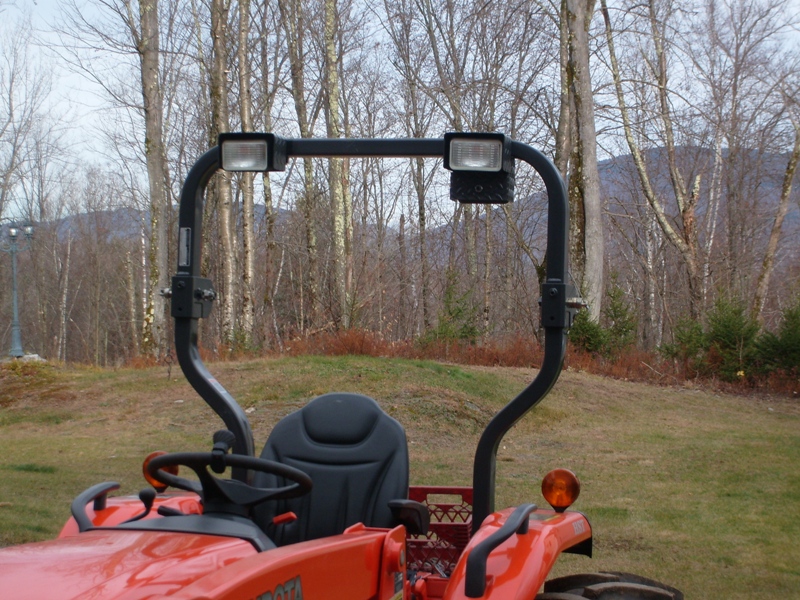

Here's what I did on my B7800 [NOTE: updated with more current picture]:
U-bolt and angle bracket. This was done long before LED lights became available. Having the lights mounted on the inside of the ROPS lessens the chance of whacking them with tree limbs (one of the reasons why I went with cheaper lights).

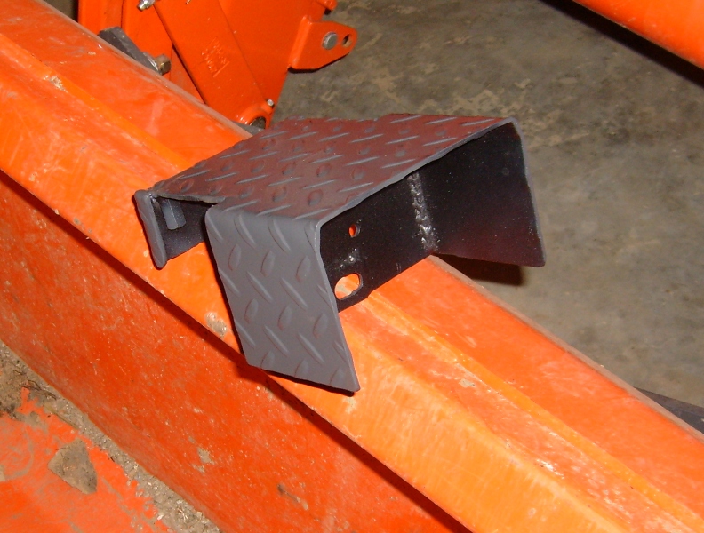

I made my own brackets that clamp on. Since I'm in the woods quite often I made them out of 1/8" diamond plate steel so they can take a beating without putting any stress on the lights.
