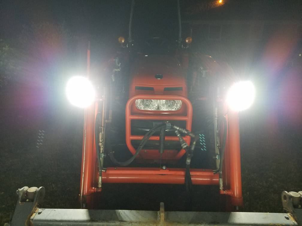

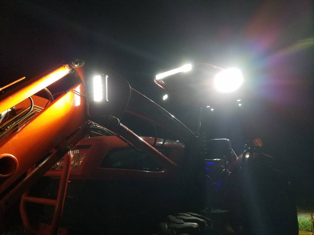

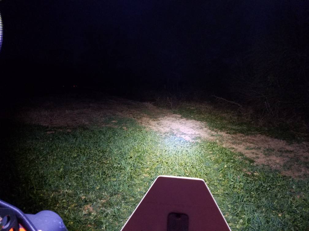

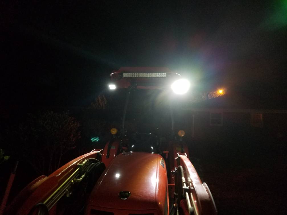

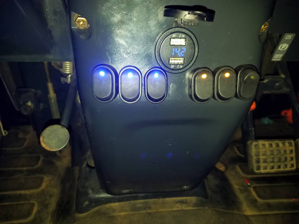

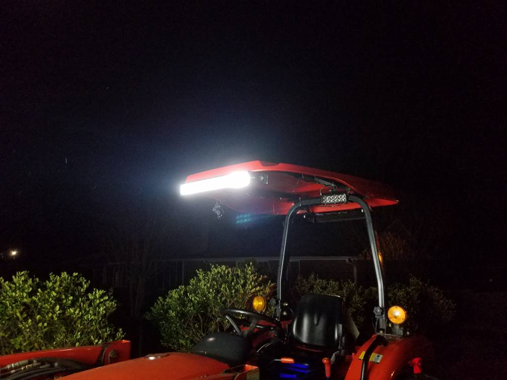

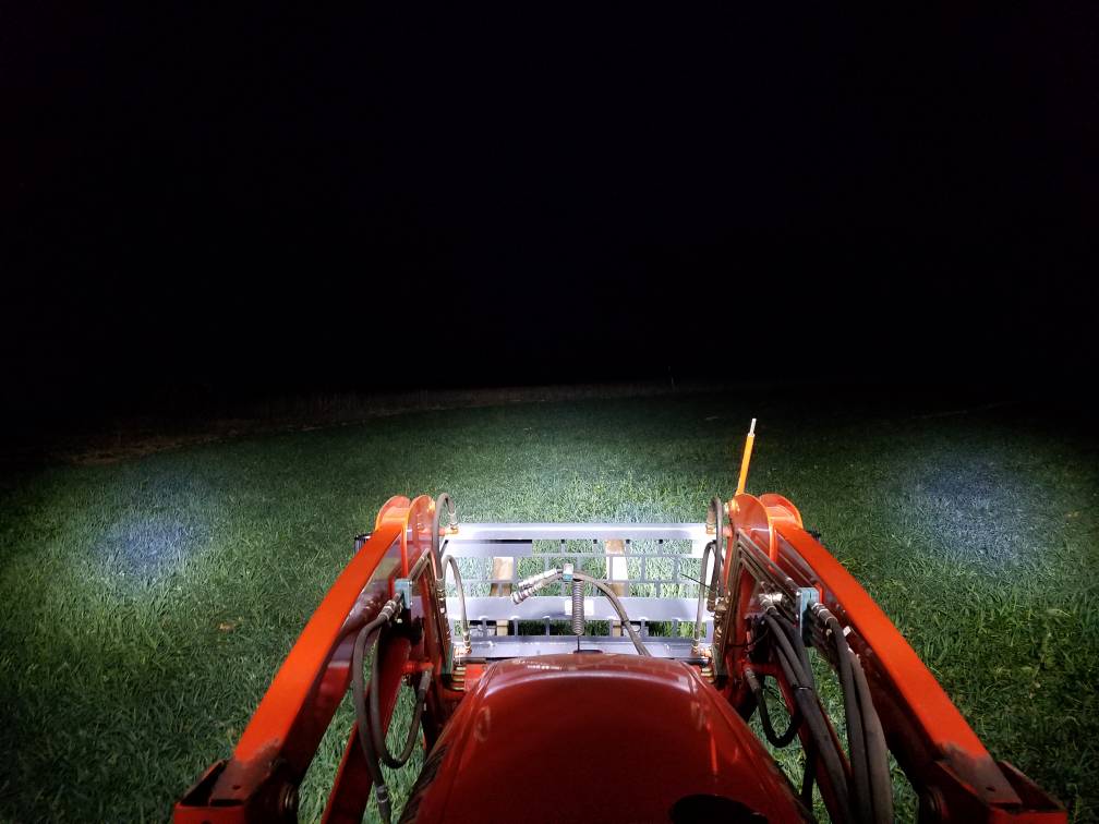

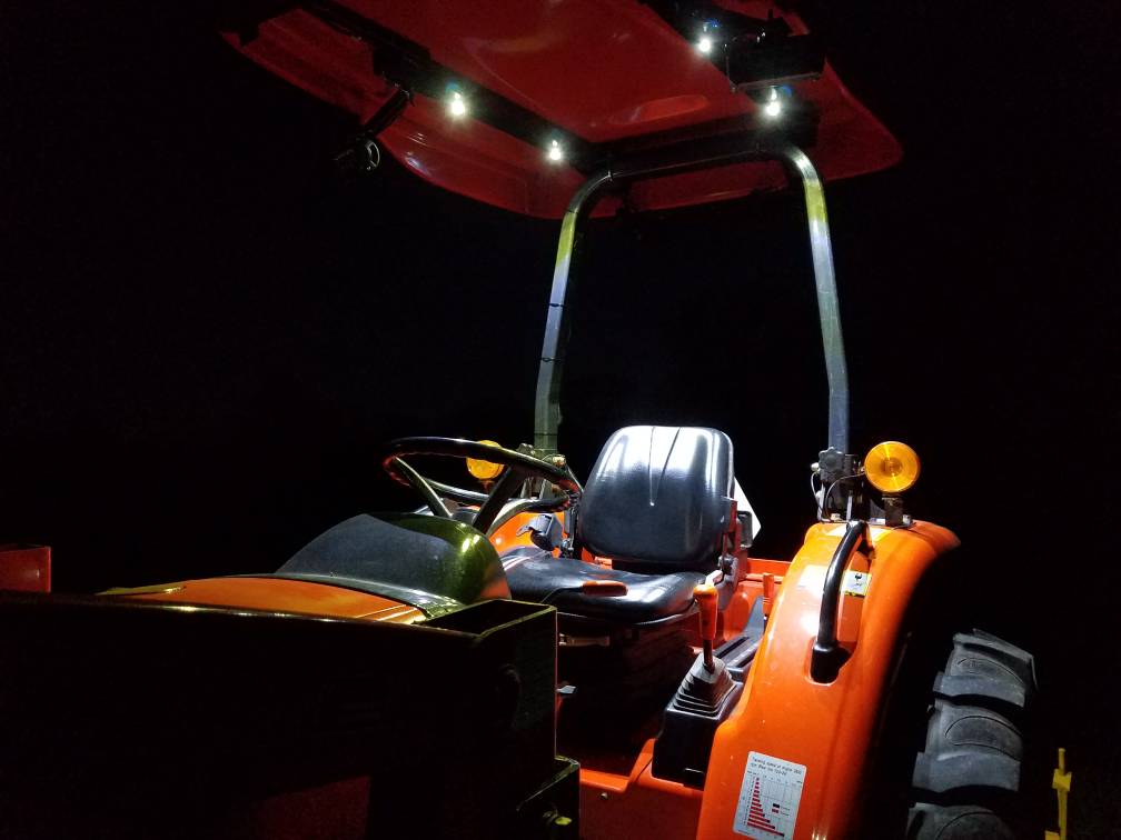

Just finished my light install. I went overboard, but it was fun.
-Rear light bar with 4 pod lights to shine on 3pt linkages to make hookup easier.
-4 pod leds that I call my courtesy lighting that shines on the seats and controls
-2 small light bars mounted on loader arms with magnets so they can be removed or adjusted as necessary
-2 leds mounted on the left and right side of the canopy. These can be swiveled and angled to shine to the front, sides, or back.
-1 large curved light bar facing the front
- 6 led rocker switches all on relays and separate fuse panel with voltage display and usb accessory ports
I added an extra switch for a power port on the rear to use for a sprayer pump or whatever else.
I'm pleased overall, but I plan on adding a few more in areas and I'll change the angles on the rear pod hookup lights so that they cannot be seen from drivers seat. I really do not like glare from leds and I want no light to shine on the operator.
All connections were soldered and heat shrinked and sae 12v quick connects connect the lights in the back to the canopy in case it needs to come off one day. Still at 14.2 volts with all lights on, so plenty of amps left to add more lights! I look forward to getting some nighttime chores done once it warms up. 20180101_182412.jpg20180101_182244.jpg20171230_183923.jpg20171230_183906.jpg20171230_183849.jpg20180101_182059.jpg20180101_182200.jpg20180101_181932.jpg20180101_182105.jpg
