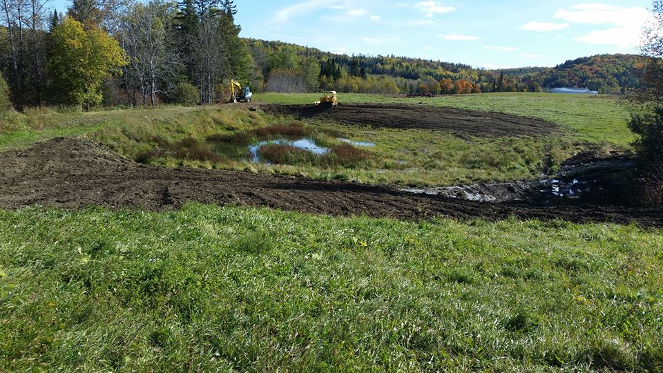

Plugged up the breach and installed a 15" poly overflow. Went down about 3 feet and sloped the edges. Set some stumps and logs along the bottom so the fishes have a chance with those pesky otters.

Some of the material removed was piled on the far side of the pond where it remained since last summer.It had a crust on it at first but this year, weeds and grasses grew over it. The dozer was used to pile the material up close to the opening and the excavator was used to fill in and compact it. The dam is almost 30 ft. wide at the top and wider at the base. We'll see if it holds but I think it will.

Can you give us pics, closer up, to the poly overflow, and maybe say more about why you chose to go that route?

I'm back in Jersey now. If you do a save as on the image I posted and open it up in photo viewer, you can zoom in on the overflow pipe.
There's two main feeders that keep the pond full year round. One is a small brook that drains the two fields and the other is a spring. Both flow year round with the brook's volume varying, depending on the amount of precipitation.
There had been an open 4" sched 40 pipe set low in the dam that kept the water level about 2-3 feet below the top of the dam most of the time. That drain was damaged during the clean out and is no longer functioning (although I might be able to clear it). In years past, during the spring snow melt and with any extended period of very heavy rain, water would top the dam at the far end where the new 15" overflow pipe is now.
The top of the new overflow is set approx. 12" below the top of the dam.
