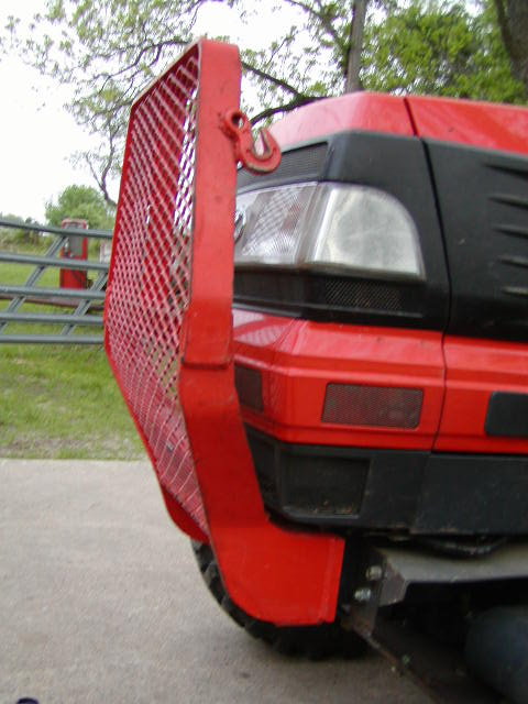

Grill guard side view

Neal, THANKS for the great photos. Now I've got to get off my duff and get started on one for my tractor.
