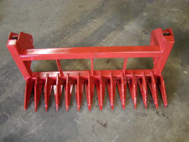

Thanks so much, Neal. The text and photos are a great help. The only thing I still can't tell is about the vertical braces on the teeth. Do they butt up against the square tube or did you cut them to continue over the top of the tube?
Thanks again!
   / Cleaning the fence row is fun now
#42
Mine went over the top. Only because I was using 3x1/2 and I thought it would look better and be stronger. I think TraderMark used 2" which could butt into it. I believe 2" would be plenty strong.

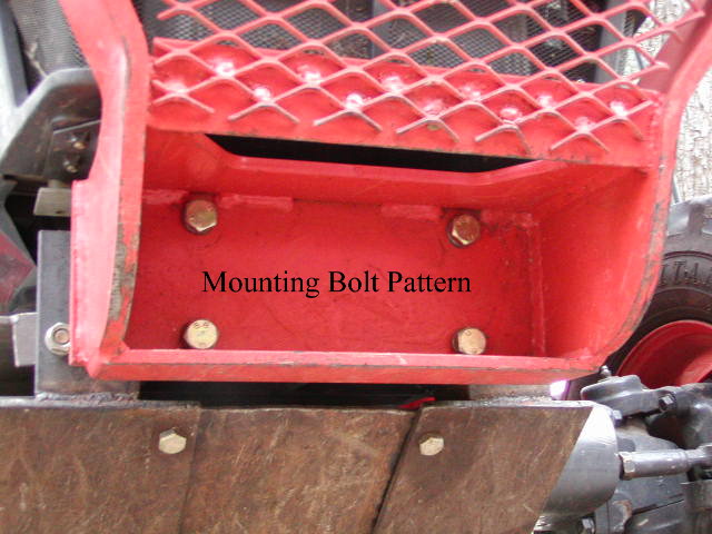

Tbone
Finally got around to taking some more pictures of the grill guard. Hope they help when you start your new project.
Will attach about 4 pictures,
1. Grill guard bolt attached

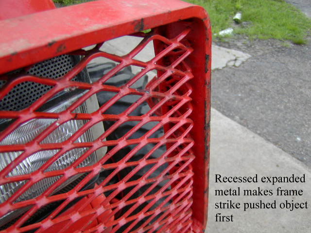

#50
Recessed expanded metal
