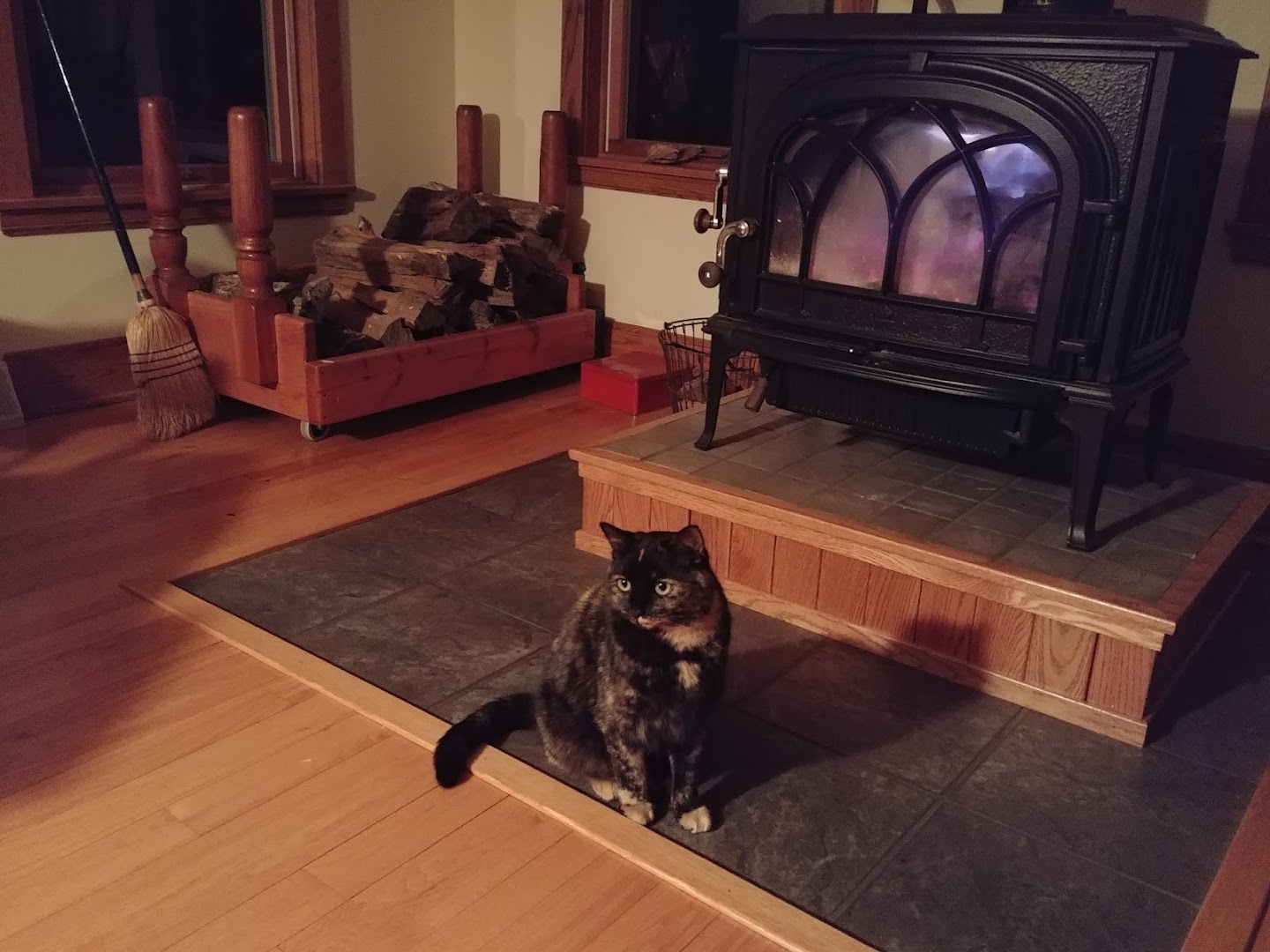

Jotul oslo500, primary heat source for winter here, 27/7.
Burn dry wood, hot enough to prevent creosote build up, or hotter still to burn it back off (creosote condenses at 250f, will burn back off at 700f). The only cleaning I do is to use a damp cotton cloth to wipe gray ash buildup off the glass once a month or so. On startup the glass is cool, water vapor present, wood pops ash onto the wet glass. No creosote, ash just wipes off, rinse and toss in the laundry. A couple old wash cloths last a long time and are good too for wiping down the rest of the stove area.
Agreed.
Users with creosote problems need to buy a flue gas thermometer and learn to run their stoves hotter.
Creosote on the glass should be a warning sign that you probably have issues in your chimney as well and you need to get it inspected and cleaned.

I burn coal. I had to replace my glass because I used glass cleaners with ammonia. They yellowed the glass to the point you could not see the fire. Now I just use white vinegar and a paper towel. Haven't had a problem since.

Lol, no. Mrs Slim would not tolerate throwing away cloth towels. These are "dog towels", which are kitchen towels that have passed their service life and then go into the "general cleaning" bucket. After wetting them completely and wringing out all the water that can be wrung out, just wiping the inside of the glass by hand, no scrubbing involved. Then the soot covered towels just go in the regular wash load and come out clean again.
I don't have a creosote build up problem at all, as like others have stated, I run a "hot" stove. And as most others do I'm sure, I only burn well seasoned wood, primarily Ash wood. I also have a thermometer on my wood stove to monitor burn temperature. The only build up I have is just soot/ash that just wipes off the inside glass easily.
