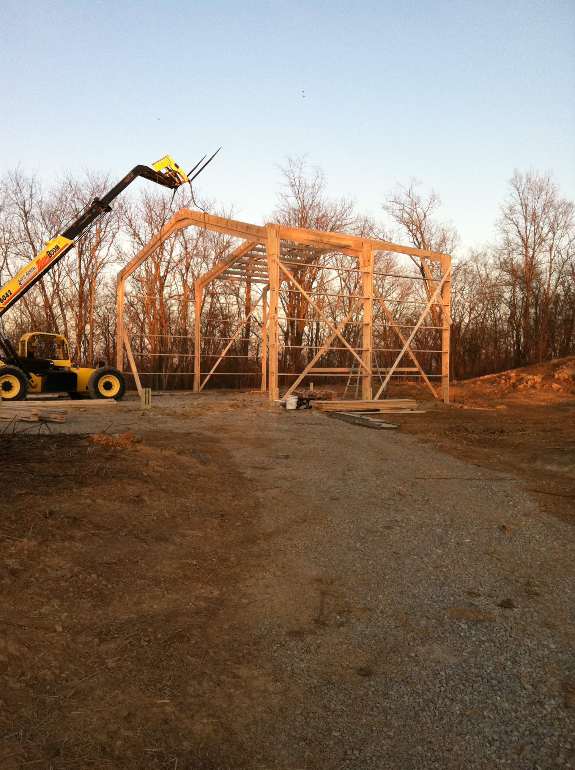

Thank you everyone for all the great advice! I broke ground this past weekend and removed all the top soil. I just had 67 yards of sand brought in and have that all spread out. Now comes the leveling. If anyone has any tips please let me know. I am planning on running line levels around the perimeter and go from there. My buddy has a laser level so I am going to try that as well. I am raising the level about 10" higher because the area I am putting the barn is low, but no water issues.
I ended up going with the 30x40x12 with a 7/12 pitch. I also went with a standing seam metal roof because the price was right. I will post pics as I go. I was working at spreading the sand until it started to rain so I didn't get a chance for a pic but I will post one tomorrow.

Here is a pic of the site with the sand spread out. I decided rather than leveling now I am going to have the posts set and then level from there. The posts will only sit 2ft above the ground so it should be easy to level out. I will post pics when the posts go in.

My cement guy wanted to level and compact the base as part of his contract. He came in after the barn was framed and filled to 4" below finish floor grade using the level skirt boards as his point of reference. He wetted the sand and compacted it all with a vibratory compactor on the front of his skidsteer. After everything was level and compacted he formed up the aprons for my three doorways and was ready for concrete the following morning. He made it all look real fast and easy. He figured how much fill was needed, called a trucking company to schedule delivery, and ended up charging me less for the fill than I would have paid if I cold called for it.

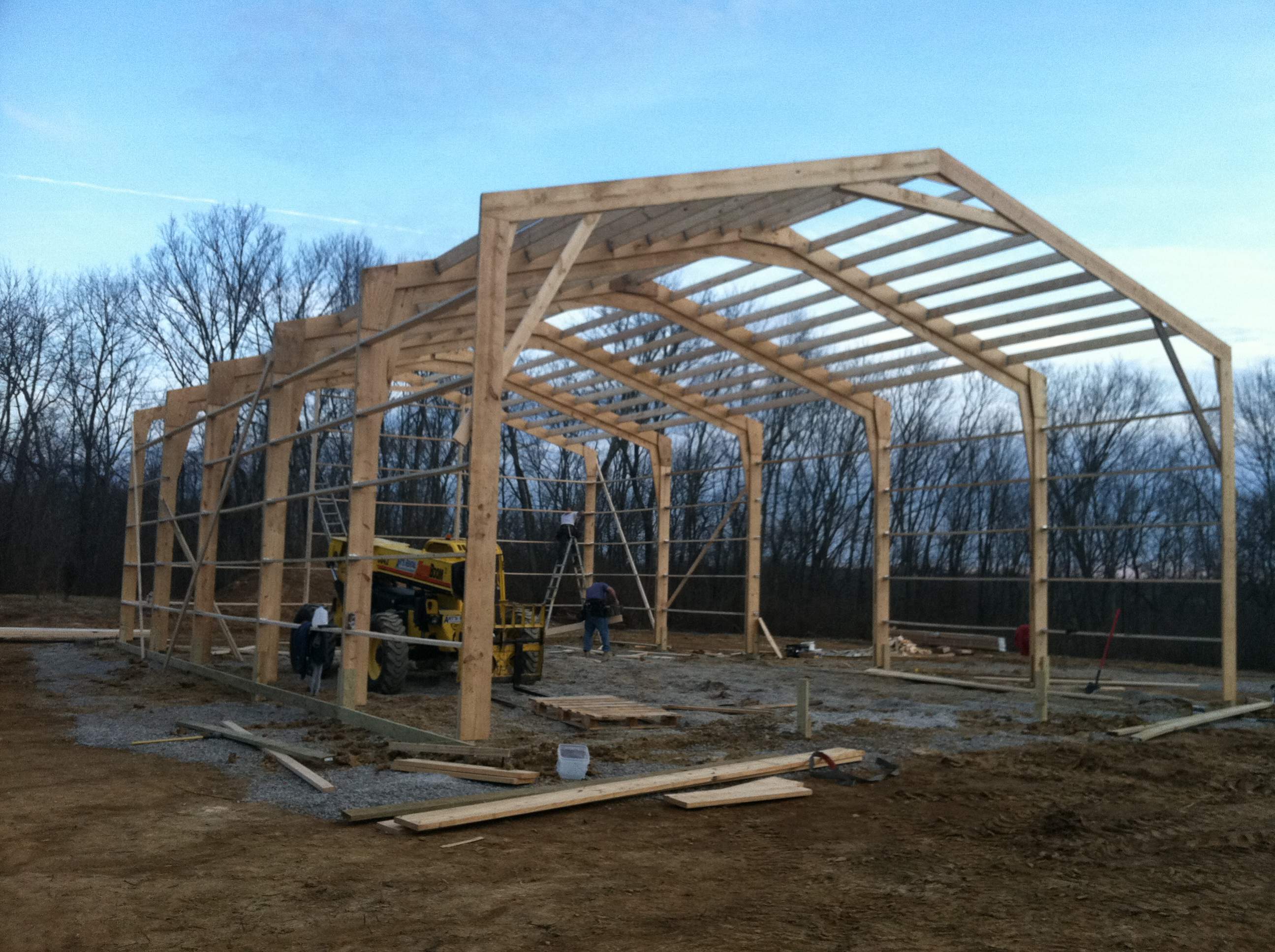

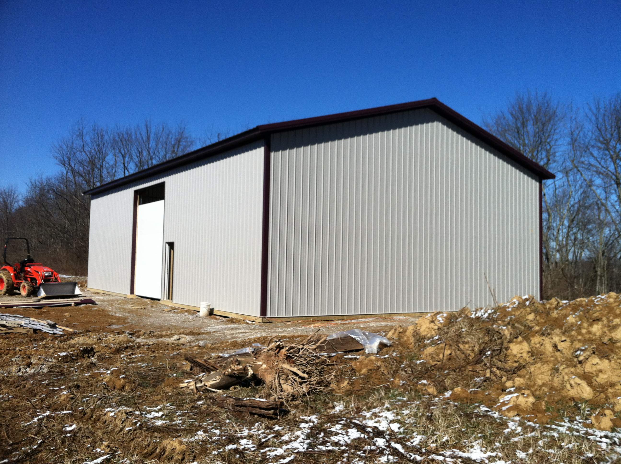

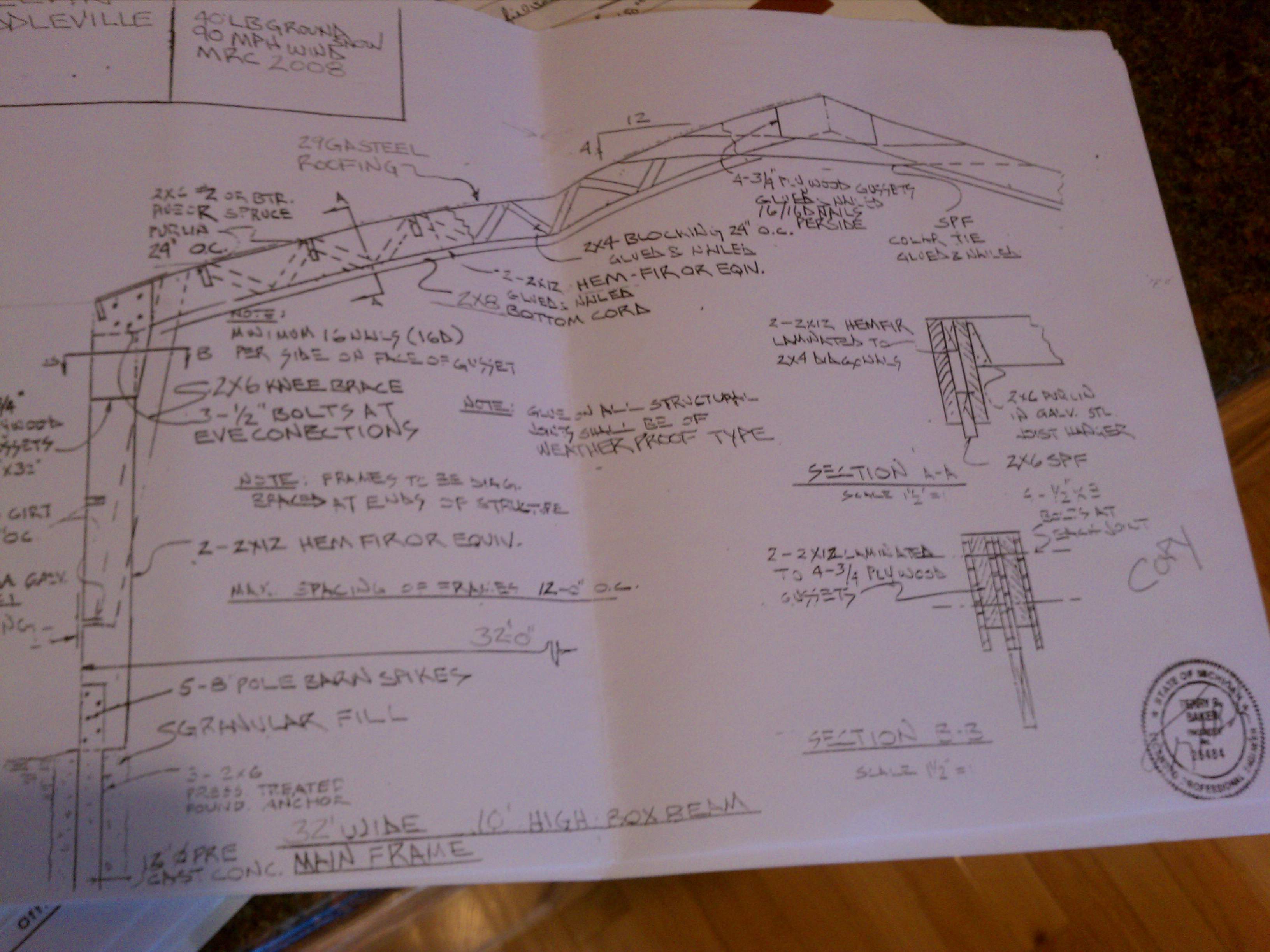

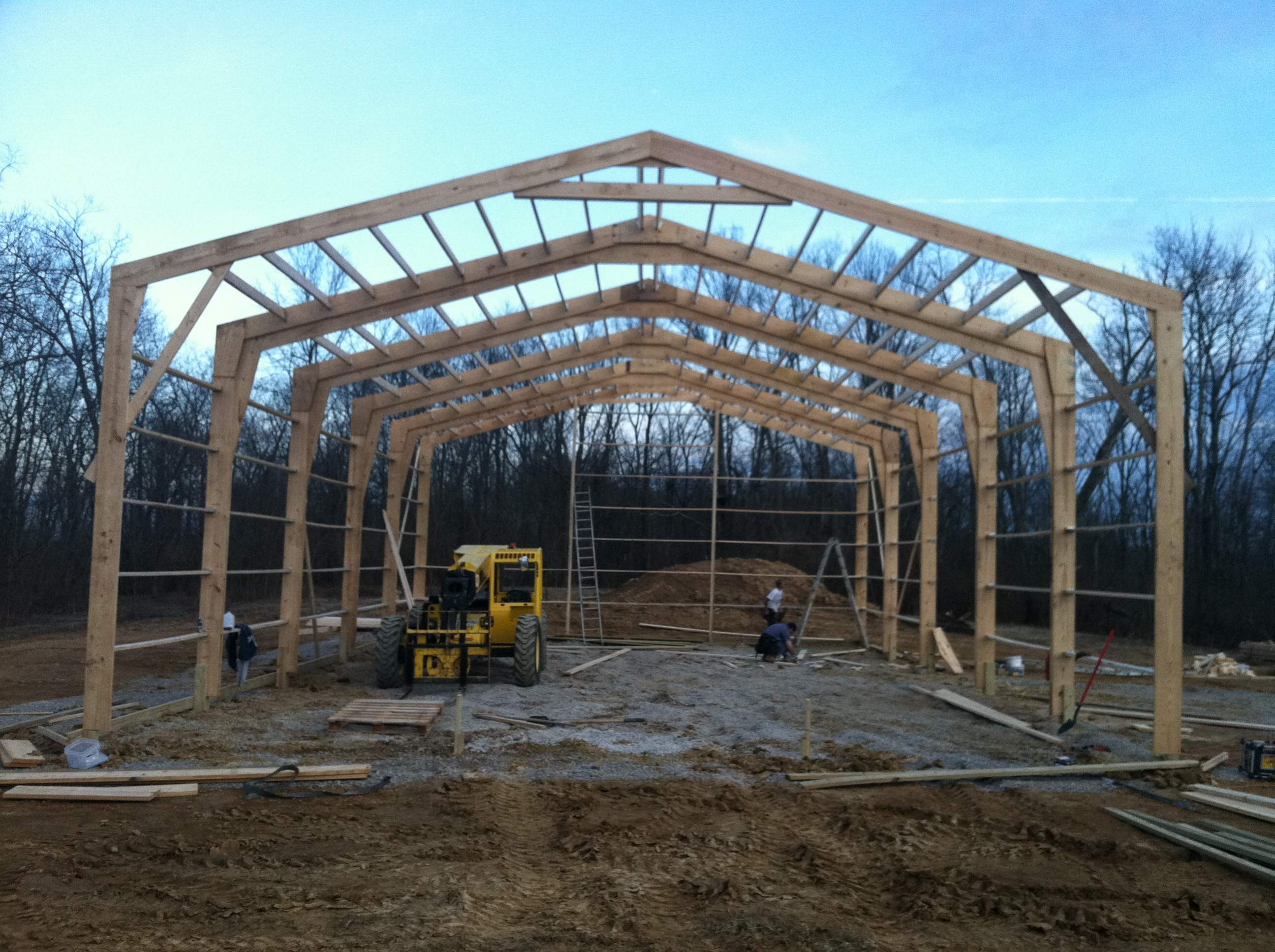

The barn actually just got started this week. Sorry for the lag time in posts. With all the rain and the tornado/straight line winds that devistated my area things got behind schedule. I am into the barn for a little over $10k including labor. Concrete is another $2600. I thought that was a really good price considering all the options. The first 2 pictures are of the ancors that go in the ground to hold the beams and the 3rd is the material. Also a new tractor that my boys get drive.
