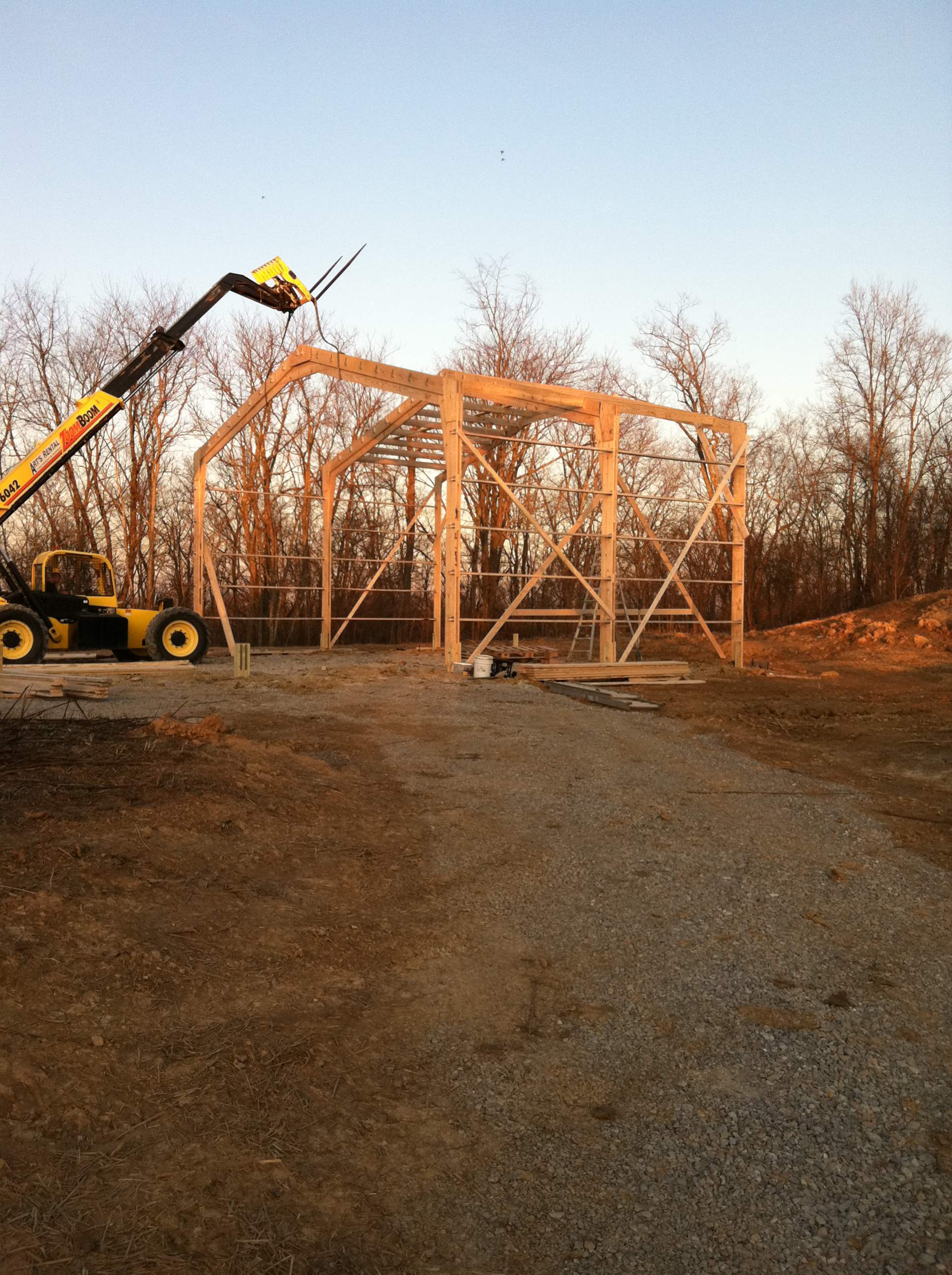

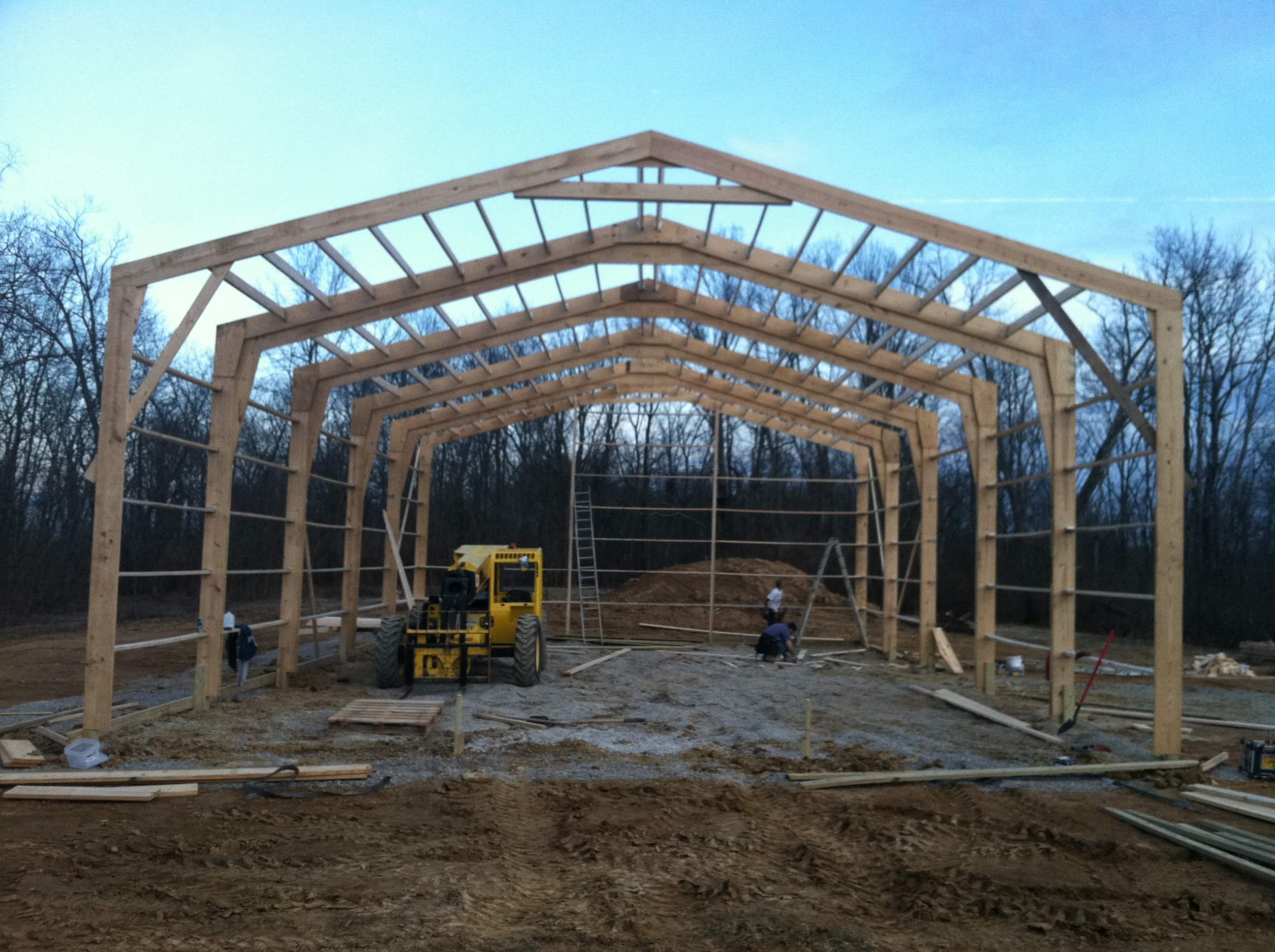

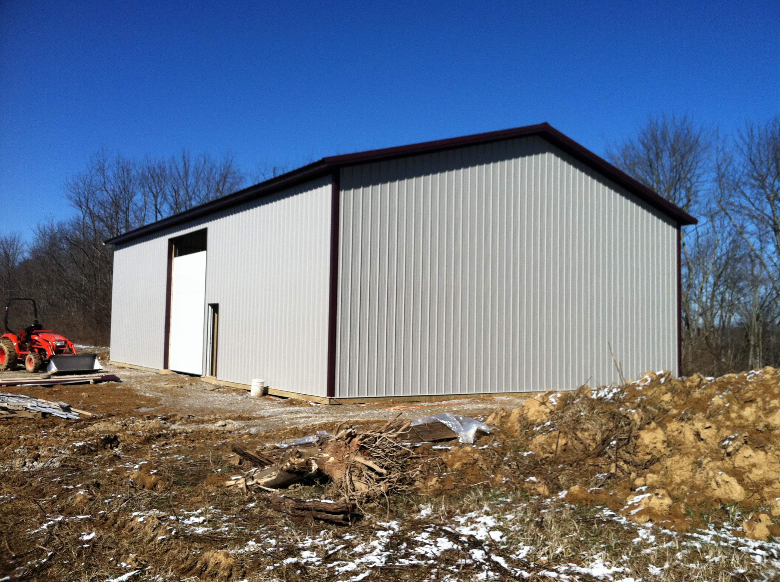

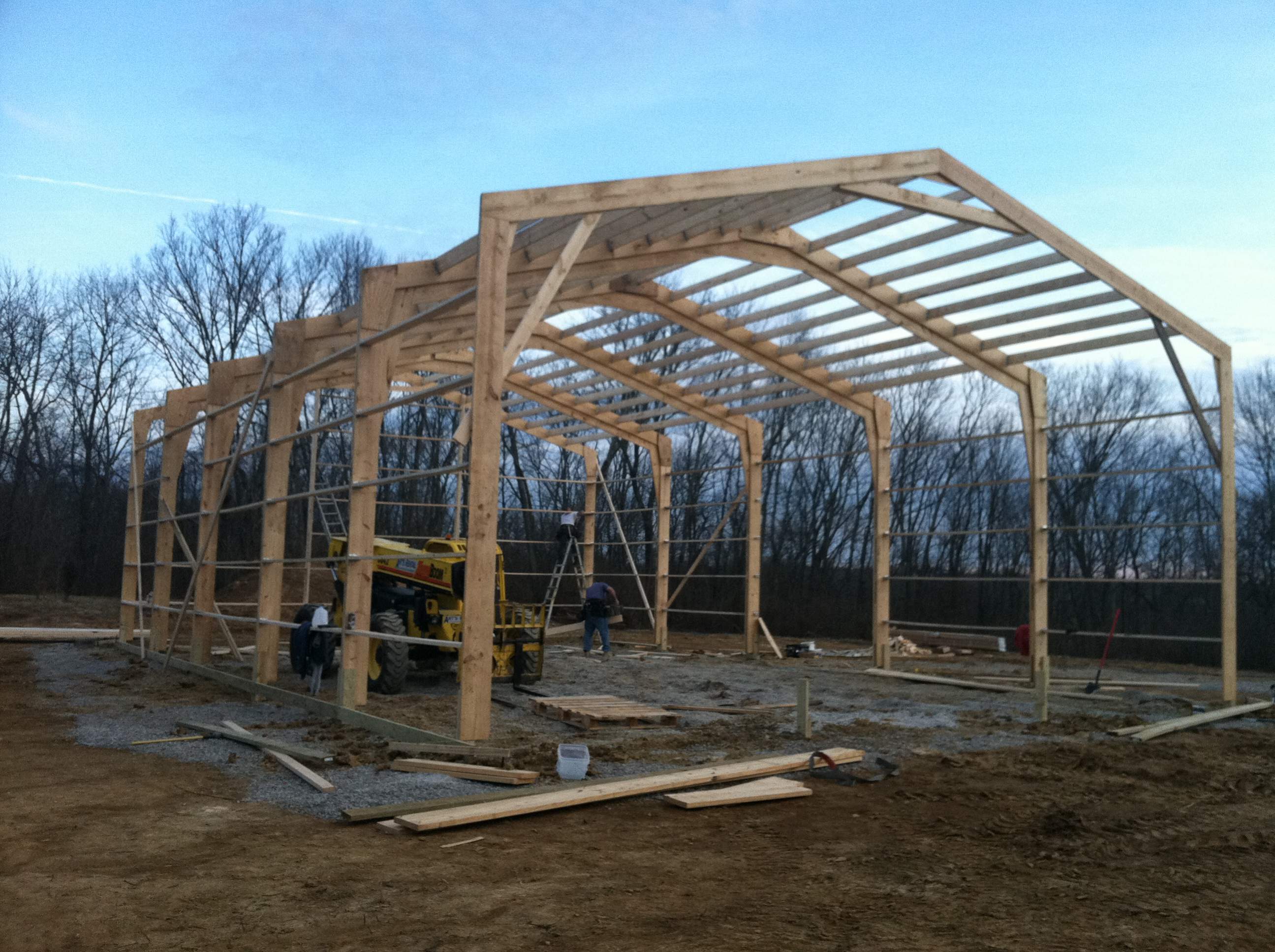

I just had a Branstock building put up. I saw the building here on this forum (actually this thread) and it was exactly what I was trying to find. So I called and was surprised at how reasonably priced the building was. I could not find a better constructed building for the money. Chris at Branstock was very good to work with. I am very impressed with the construction. The building is 38x60x16 with 12" eves all around, a 12 x 14 insulated door plus a man door. With the 2x6 girts on 32" centers and the 2x8 perlins on 24" centers and placed perpindicular to the beams it will be very easy to insulate in between them.
I used Shane to put up my building. He was extremely knowledgeable with the construction of the building. I paid him according to his payment schedule, that seemed fiar to me, and the building was completed in 2 weeks. It was only him and 1 helper. I thought his rates were very good especially since I live in KY and he had to get a hotel for the duration. Sorry to hear olds67 that you had problems with Shane.
Just want to thank everyone on the forum for all your good information on various subjects. Everyone here is great.
Bill

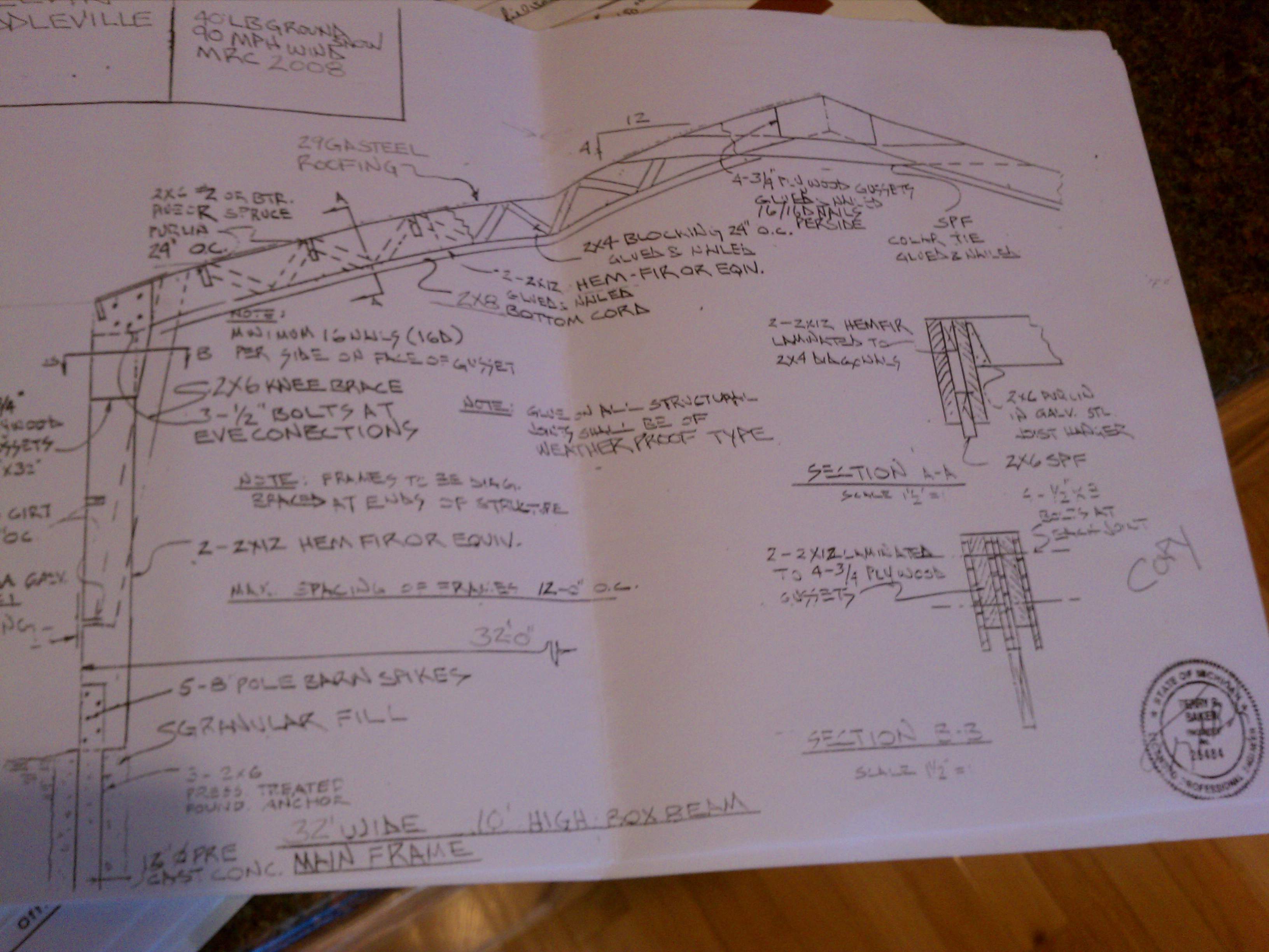

I have the prints and was redrawing them on autocad adding dimensions, thats the only thing I've recieved. Did they completely assemble the beams there or were they partially preassembled for straightness before delivery. It seem's it would be hard to hold a 20' 2x12 straight with out a jig. The print had a engineering stamp that said Terry Baker. I found a Terry Baker civil engineer at kater engineering in holt Michigan only the number was disconnected. He graduated from Michigan State in 1969 that puts him around 65 years of age. I wanted to ask him who owned the sole rights to the prints. My prints aint exact with out the original but, I put in the dimensions I know and auto cad does the rest.
   / Clear-Span or Box Beam Barn #57
We probably have the same plans. My beams were laminated before they were delivered and then they assembled the entire thing on site. I can measure anything you want or feel free to come check ot out and measure whatever you want. Pm me and I will give you my phone number if you have anymore questions.
