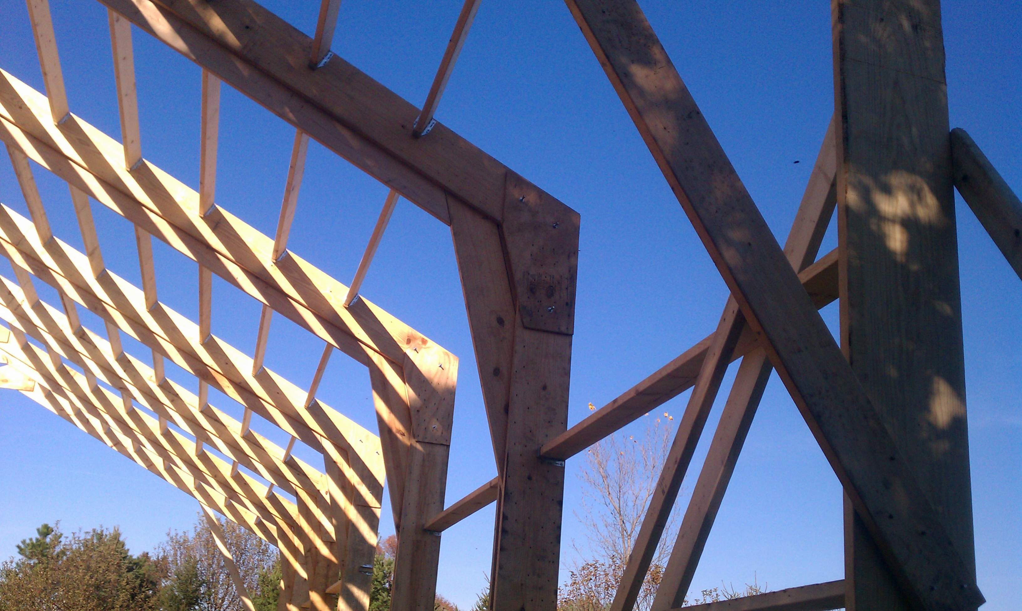

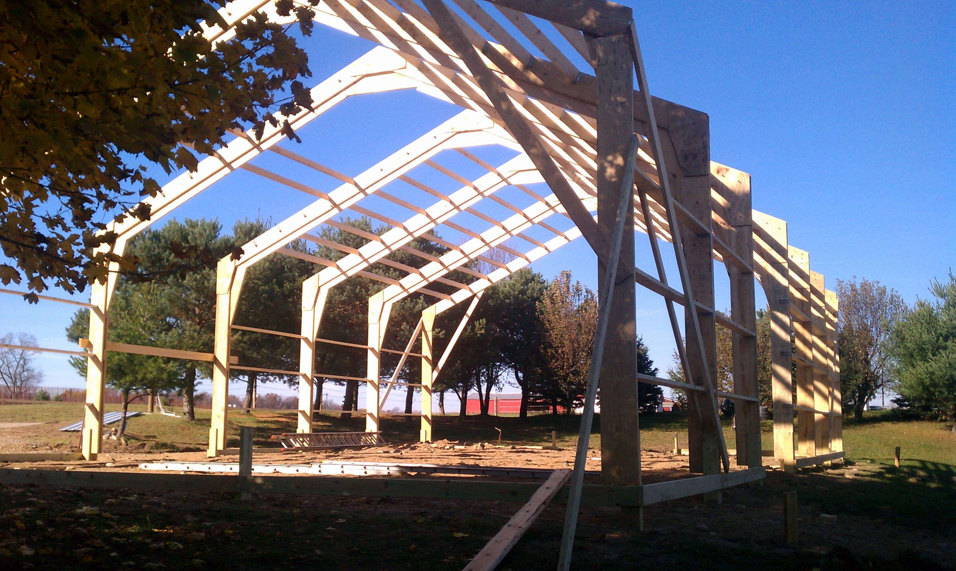

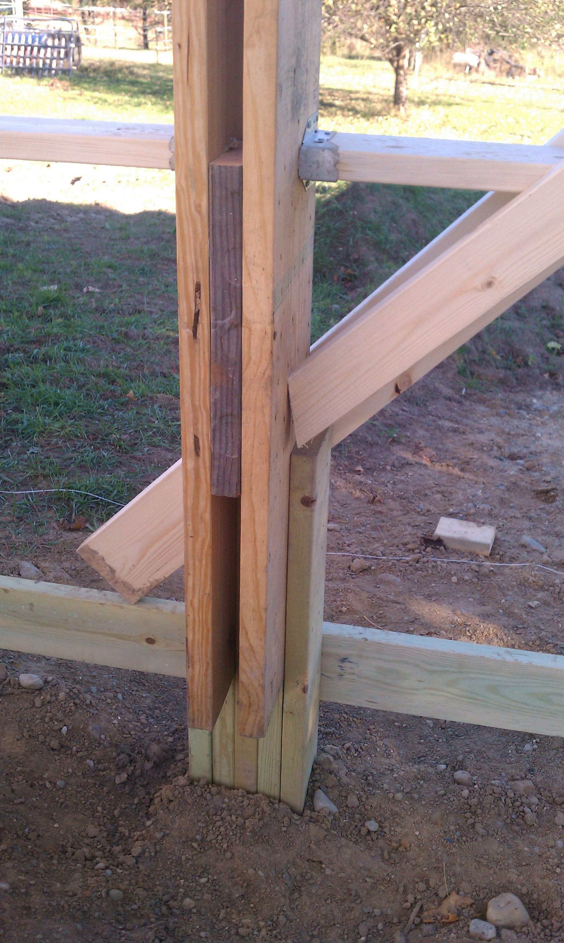

Thanks Mike for your help! Sorry to hear your had trouble with the builder...I've actually talked with Shane a couple of times about building it...Good to get advice from u ! I went and looked at a 36x60x12 today north of Battle Creek and got some great advice from the owners... they really like the building and liked working with Chris but also had trouble with the builder...but it was a differnt guy. I rehab homes and contractors in geneneral aren't reliable. Which is sad because if they were they would get more biz.
So Im back at trying to decide if I hire one of the people whom have put this barn up before... hire a builder whom has never built this type before or just build a pole barn.
There's got to me more people out there that have built these with better luck with builders.
Looked like a really neat barn though! Glad yours is done! :)
I enclosed a few of there barn pics There simple barns:thumbsup:
