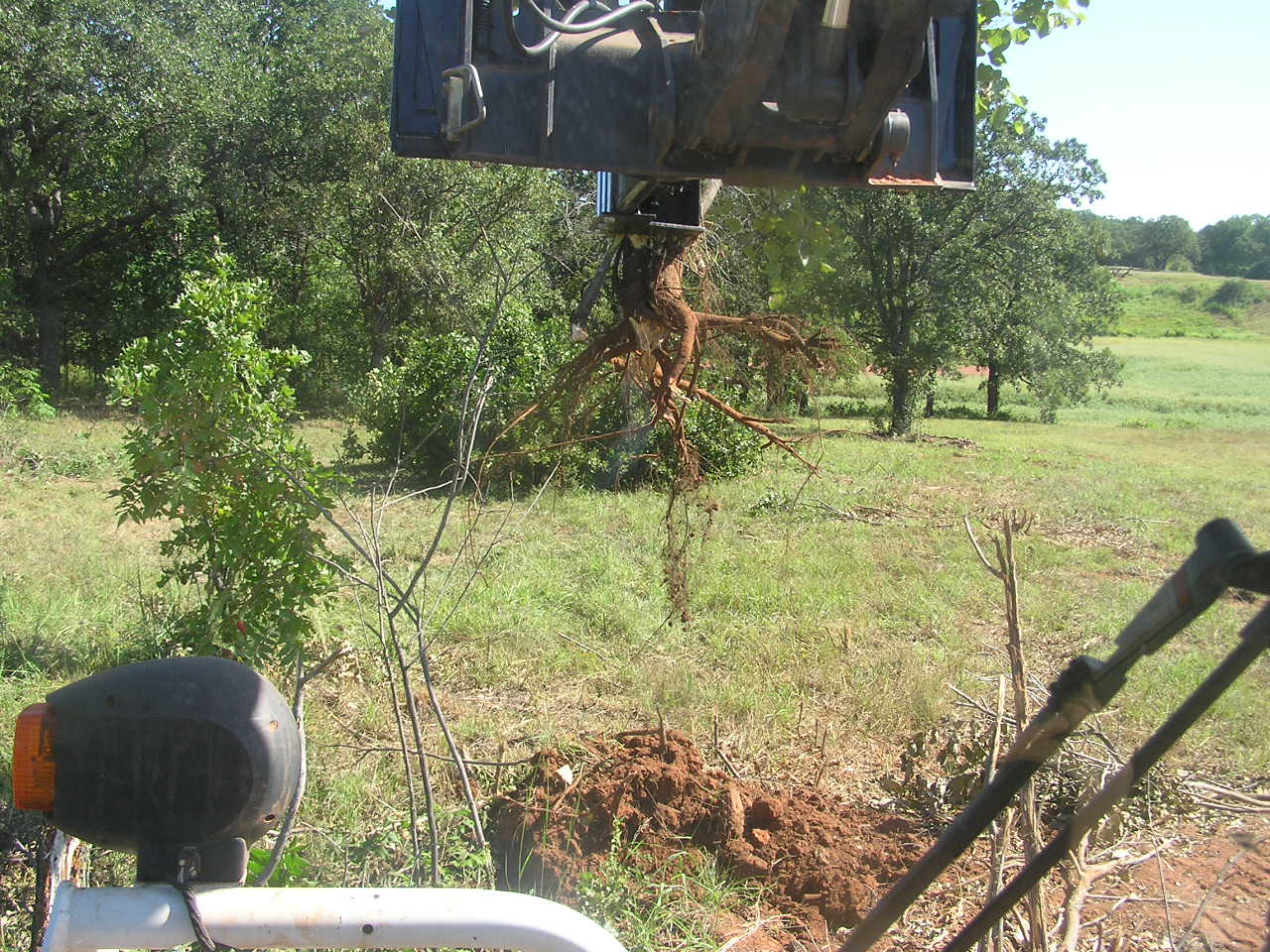

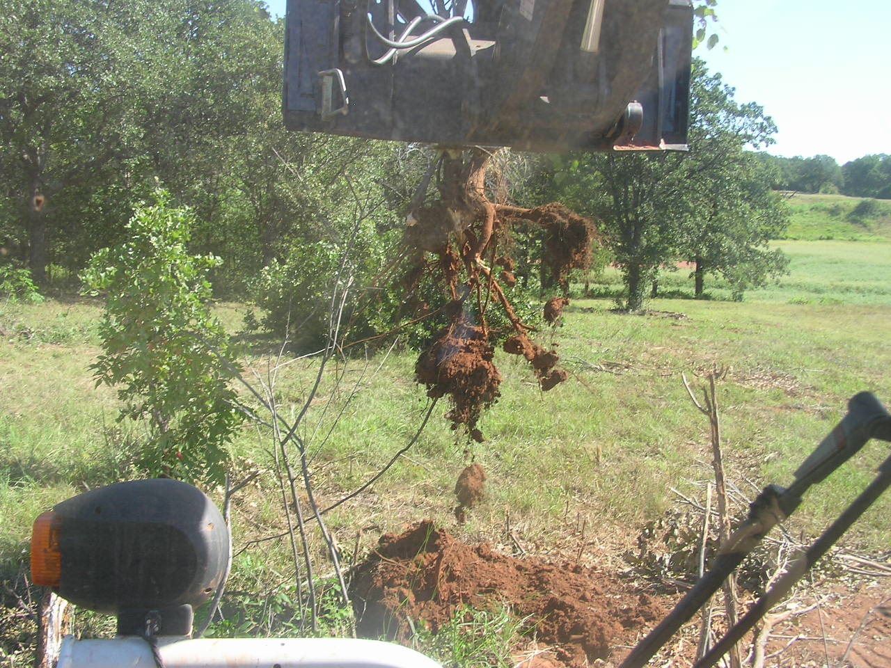

My tree puller was in post #26.
And the V417 is more comfortable than a skid steer. :thumbsup:
Here it is pulling a cedar tree: http://www.tractorbynet.com/forums/attachments/277824-tree-puller.html#post3444397

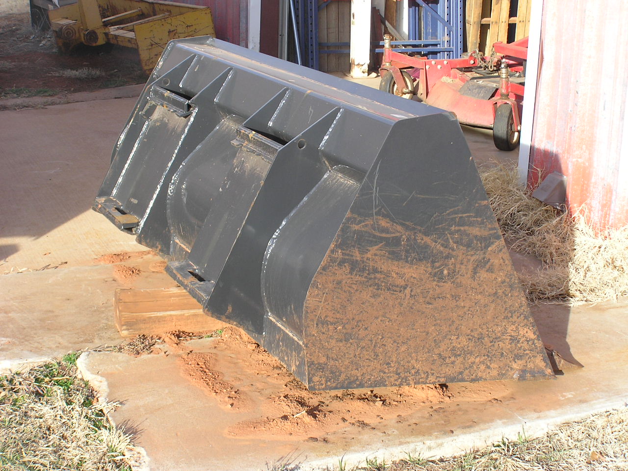

Wrong! :thumbdown:
Have you ever operated a V 417?
I have done a direct comparison with a Bobcat T300, and the V417 out performed it in every thing I did.
That includes pushing power, as in filling this bucket in hard clay and sand rock.
The V417 is 6' wide, 6.5' high and 13' long. Tire size is 14x17.5. Top speed is 15.5 mph, drawbar pull is 7,000 pounds, boom breakout force is 6700 lbf, bucket breakout force is 4700 lbf and it will lift over 5,000 pounds, 17 feet high.

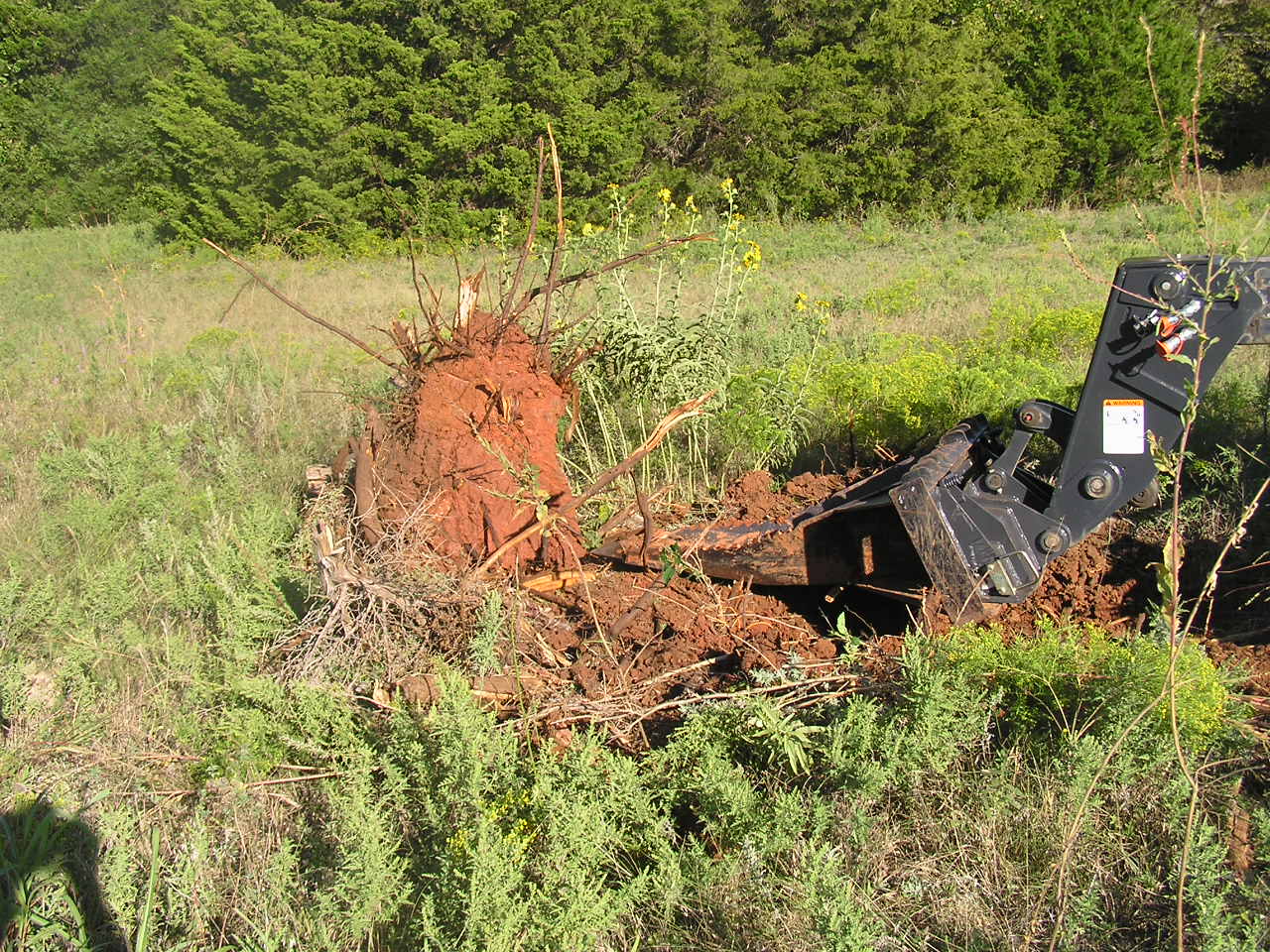

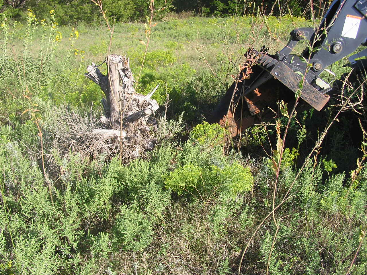

For trees too big to pull, I use the stump bucket. Had to dig on each side first.
Old cedar stumps pop out very easy. Just like using a long handled shovel. :thumbsup:
