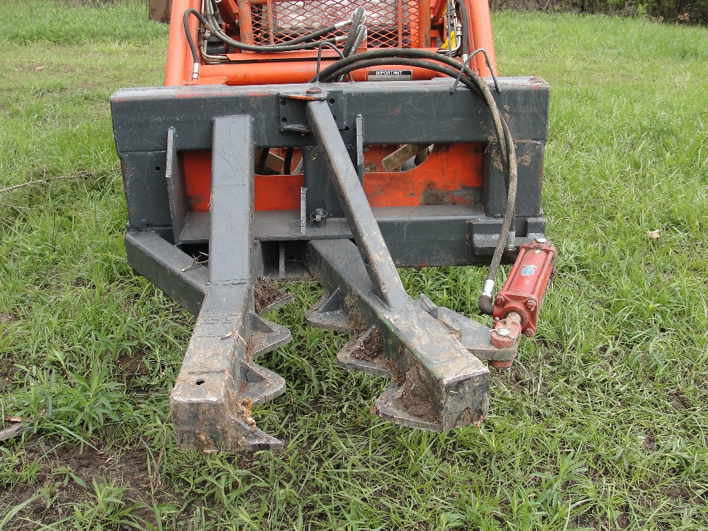

I built a stump bucket/spade before I built my puller. Although it was an improvement over digging them out with the FEL bucket, it never gets used now.
If you pick the right conditions you can shake most of the dirt off the roots when using the puller and you don't leave much of a hole. With the bucket or spade you don't have that luxury and take a lot of dirt.

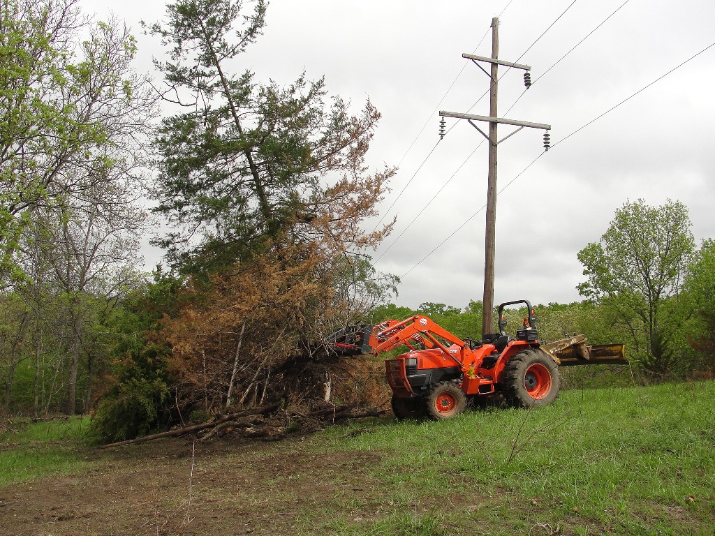

I posted pics in post #40 of my puller but here's another.
Put that on the front of a SS and there's nothing, I mean NOTHING, that will remove cedars faster, including pushing them or quickly cutting roots and pushing them over. I'll shoot some video this Summer. If you've never saw one in action you'll have a whole new opinion of a SS. And you'll be wanting a puller. Also works awesome to take out old fence posts, steel or wood. :)
As I mentioned earlier, I removed 100 or so in less than 2 hours in the AC cab, listening to tunes with our T300 Bobcat. :)
