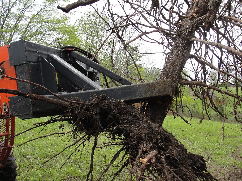

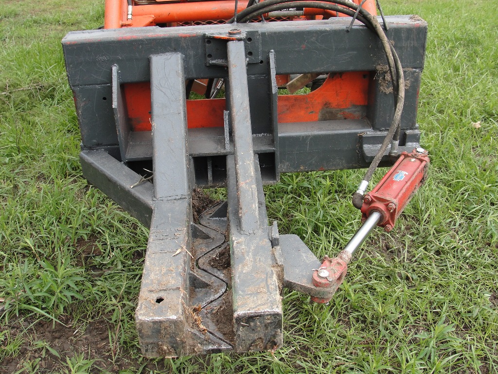

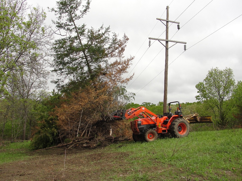

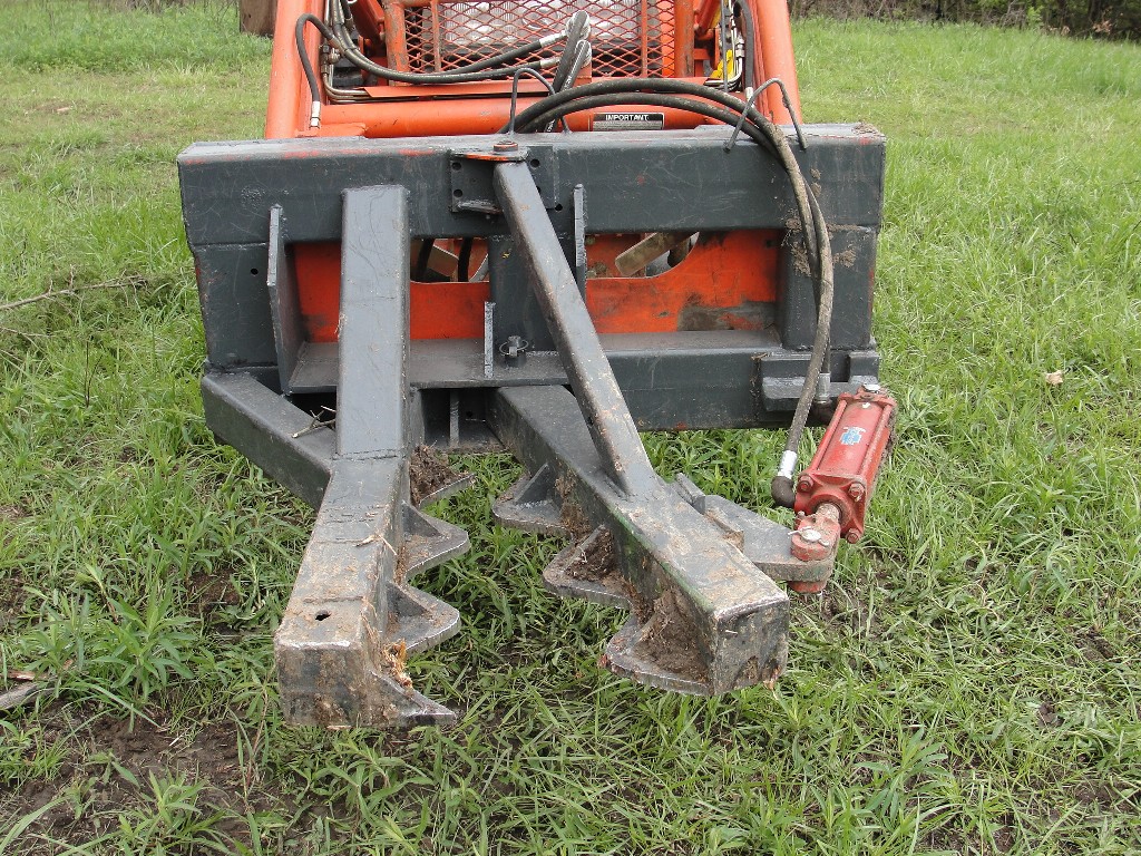

If you have a rental outfit in the area contact them and see if they have a tree puller that you can rent. They come in various shapes/sizes but will look something like this one which I built. In the Spring when the ground is loose you can pull some very large Cedar trees.
