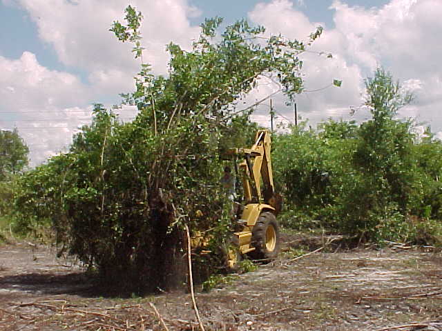

Hey Sound, you've mentioned popping them with a bucket and then using the rake a couple of times -- you may be right, I know you've got a lot more experience than me, but when we rented our TLB for clearing, the curved tines on the rake when down and under the roots a lot easier than a bucket, and popped whatever we were after right out of the ground. We didn't do any palmettos, but I did pop some 7'-10' cabbage palms out where they were in the way of the house or barn. The bucket couldn't get as deep in the ground as the rake.
The pepper tree in the attached picture wasn't picked up off the gorund; it was popped out of the ground by the rake exactly as it sits in the rake in the picture! Palms, while tough, are easy in comparison.
