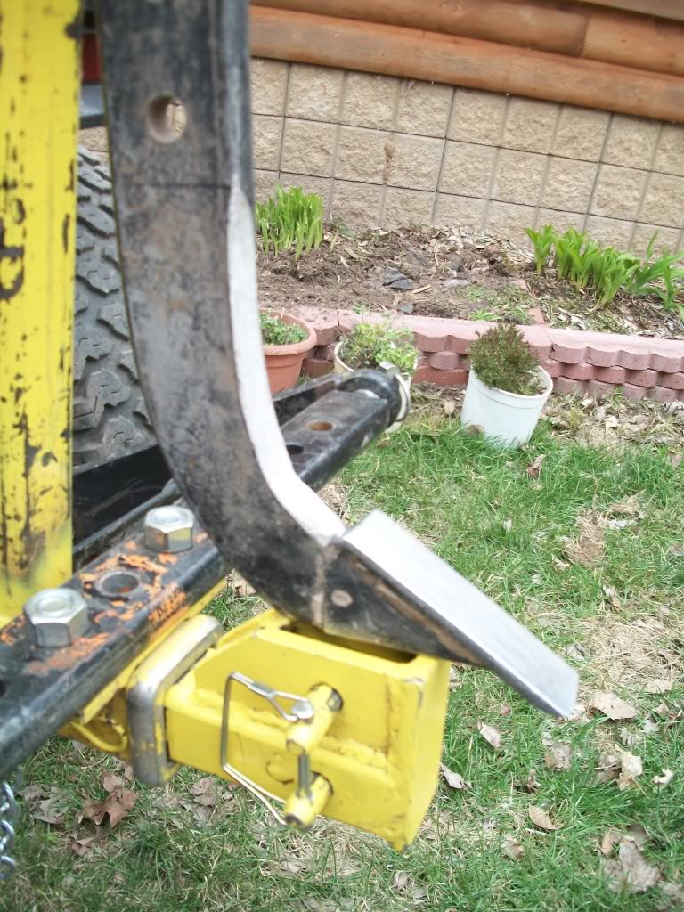

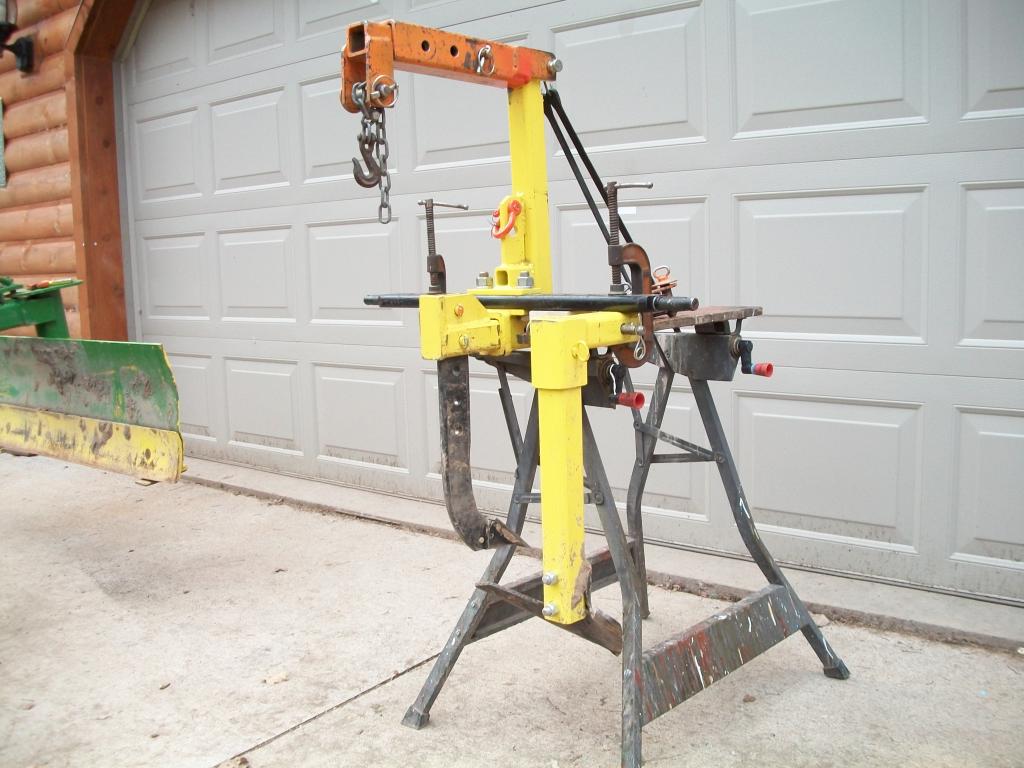

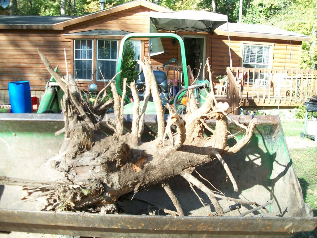

It can be done. I've used an older JD855, 24hp, hydro to grub up to 9" stumps
I use a sub soil tool and chain over a car tire rim to gain pulling leverage.
It may not be a done in one weekend project, but it don't cost much.
Good luck
