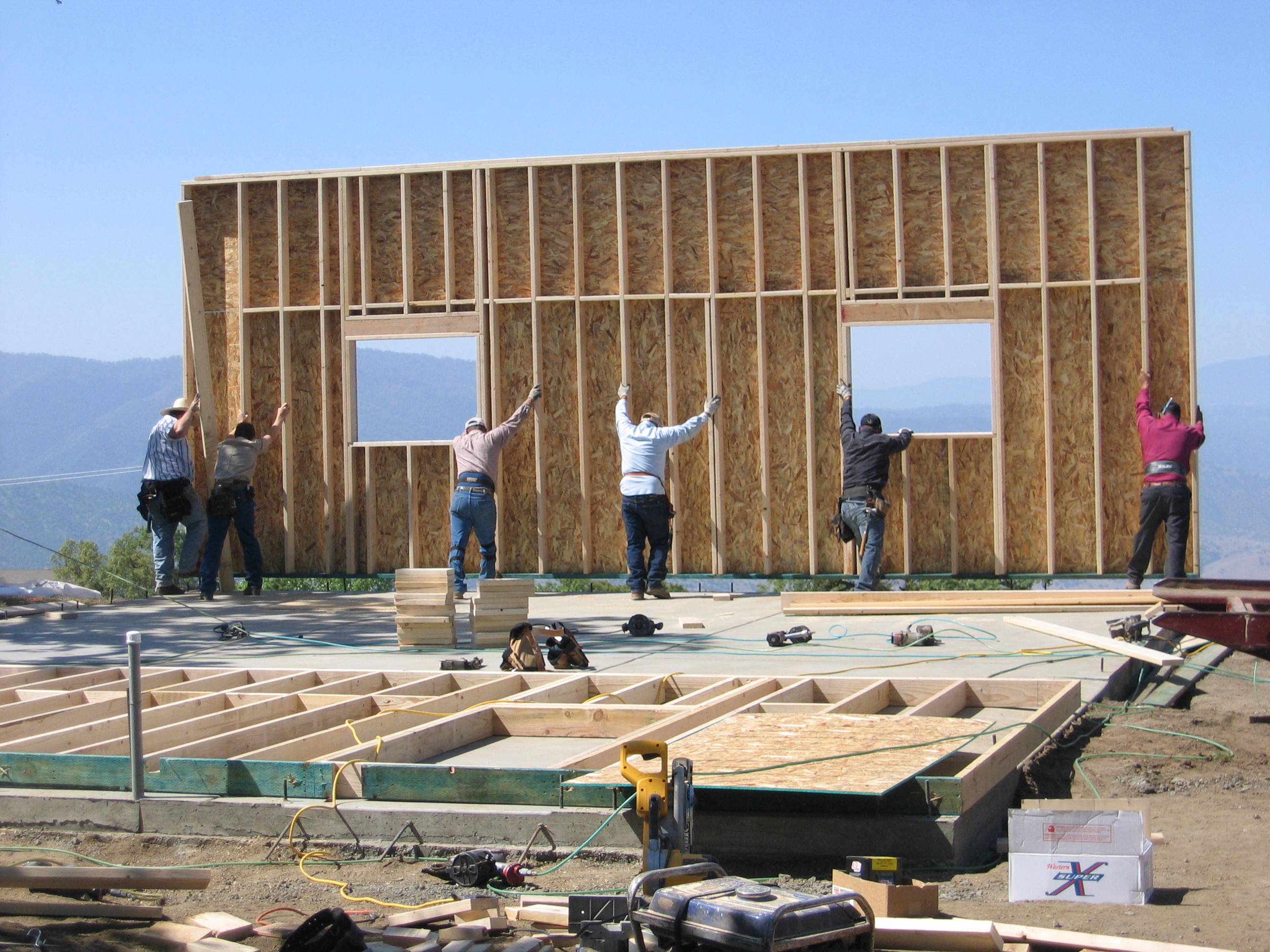

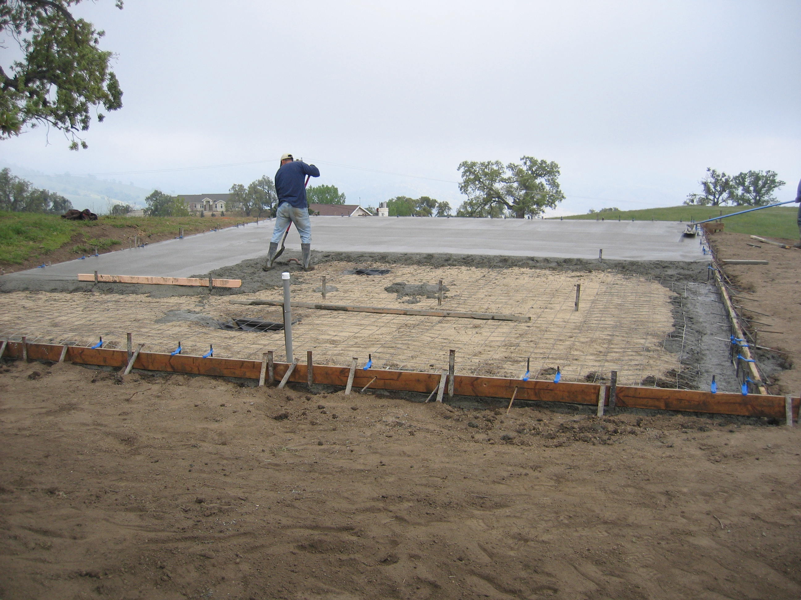

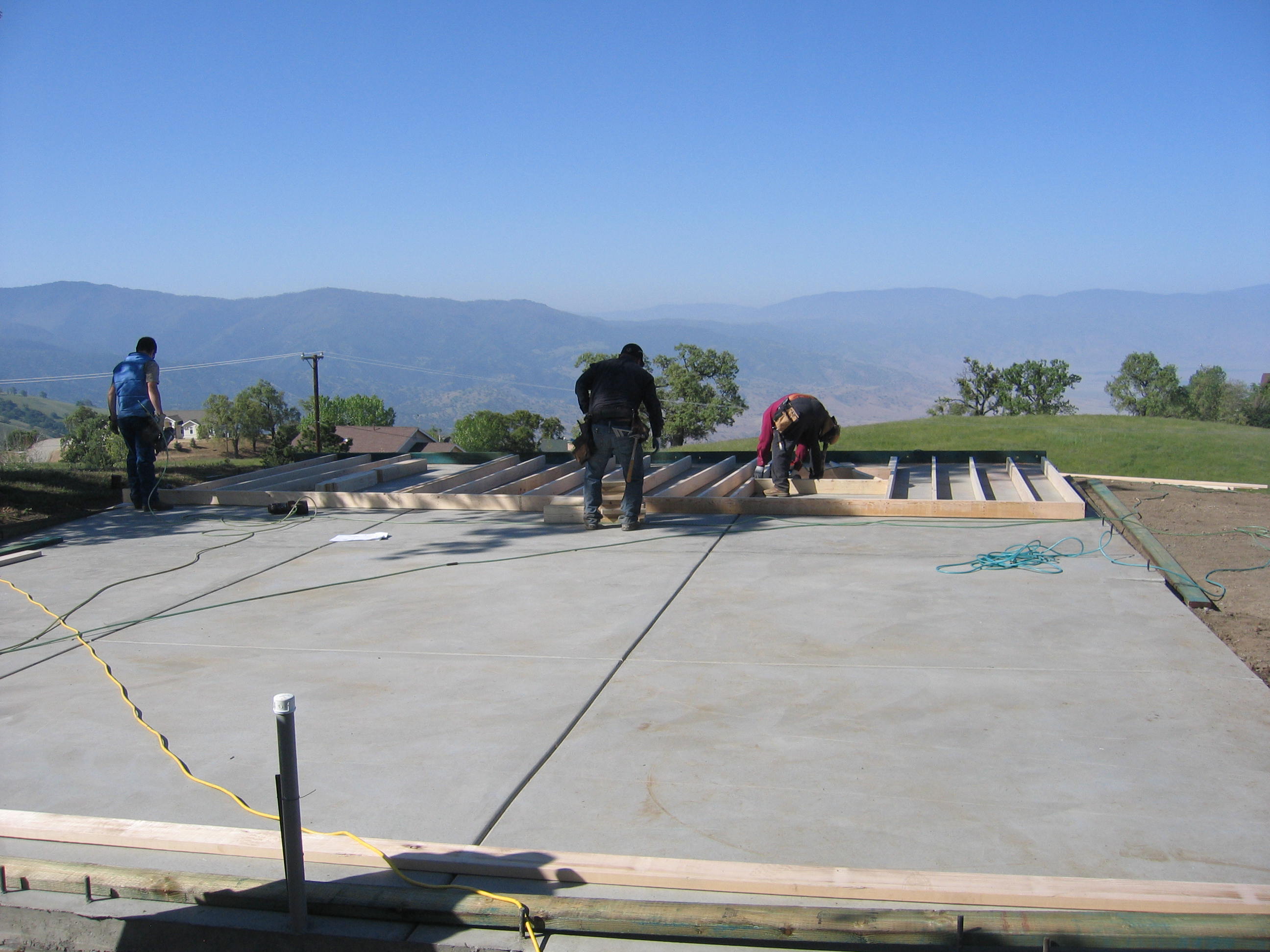

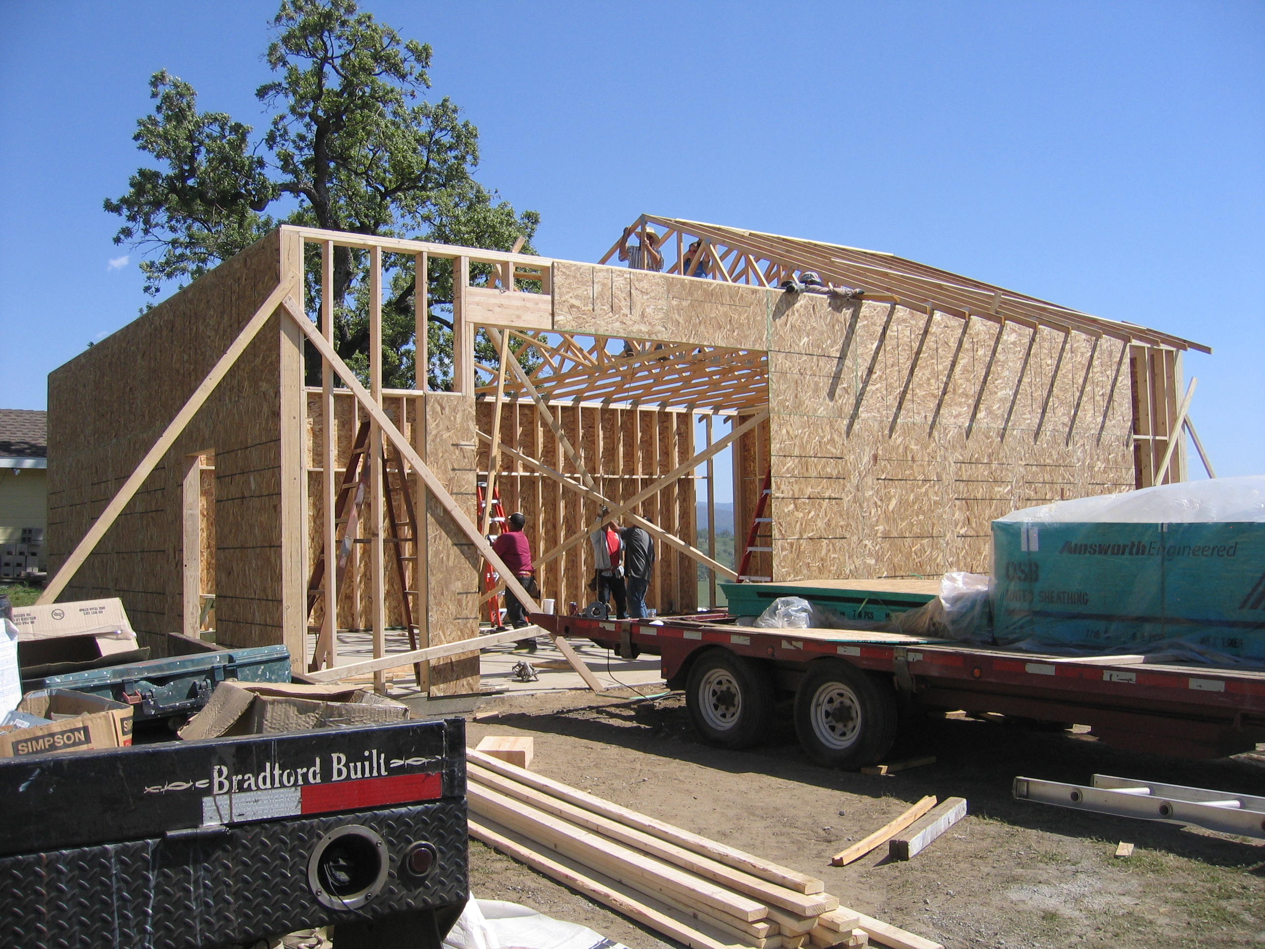

WOW, The work has started. The concrete was poured last week and the building started today. See Pictures! They showed up about 0830 and had a crew of six plus the owner. Also his two young boys. They plan on finishing up tomorrow? The plan is for my son and me to finish putting in the windows and doors and the siding, then paint.I have the 1 1/2 " conduit in the ground but it took me 3 days to dig under the 4' wide sidewalk. Finely got that part done. The inspector said I could run romex in the attic and use a water tight junction box at each end of the house. My part of this project will go MUCH MUCH slower.
