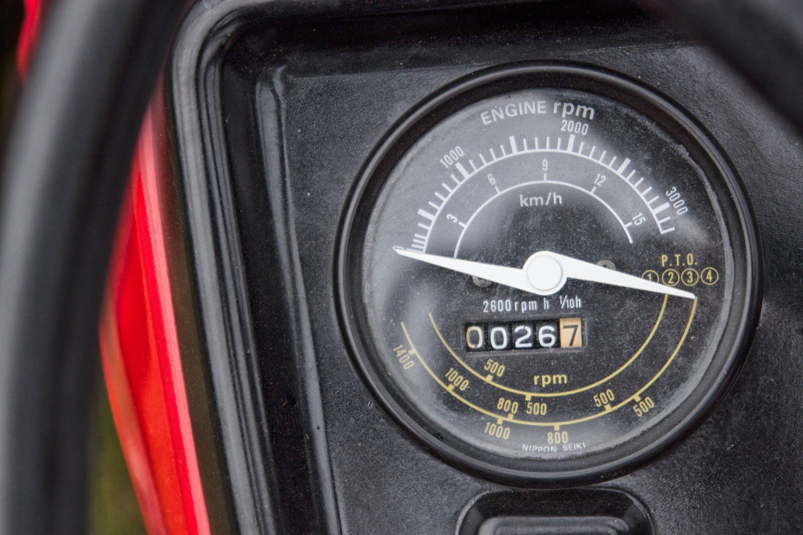

All one has to do is look down from the seat and you would be looking at the decal. Easy to shift. And yes, most times, double clutch is needed. Once it's in there, you can work all day brush mowing with the 'live' PTO on the YM2610 because the PowerShift has it's own neutral that the PTO keeps going. This way, I can travel along. stop, go into N and then R and mow backwards around trees and landscaping vs. turning the entire tractor around or spin down and spin up the PTO making the lawn messy like it was chopped.
The Power Shift is a MUST HAVE in my book. It's gotten myself out of binds many times. With the JD-850, I would fight to multi-clutch and shift. It's not easy on slopes.
AND with the 4-speed PTO, you can run the engine at different RPMS to get to the 540rpm should you choose. Just look at the RPM/Hour gauge
500rpm PTO speed-1 2200rpms engine
500rpm PTO speed-2 1900rpms engine
500rpm PTO speed-3 1600rpms engine
500rpm PTO speed-4 1200rpms engine
Now you would say, how would you hit 540rpms and not 500rpms. I just at a little to the throttle for the needle to hit the 5 in the 500. It's close enough. With the JD-261 finish mower, I can run in PTO-1 and have the needle point to the 500 in the PTO-2 area. The mower worked happily there. Remember, 540 is the MAX, not the norm.

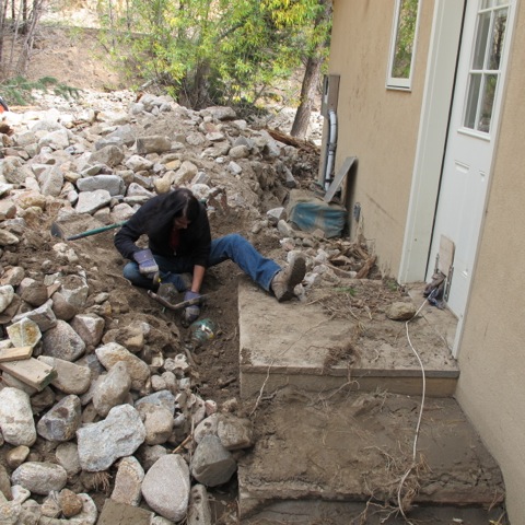

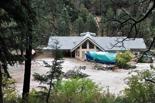

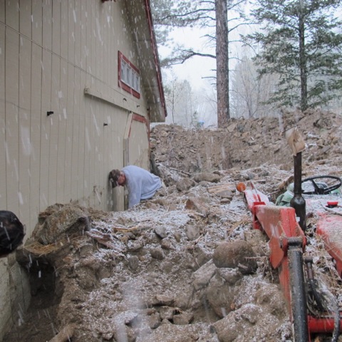

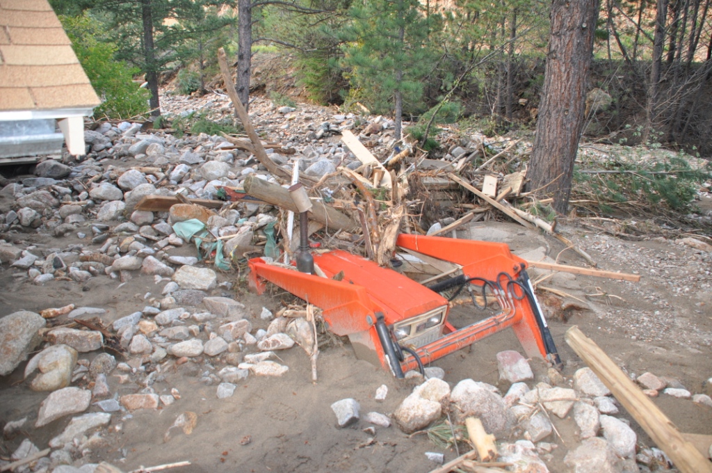

I haven't posted in a while due to the flood we had here in Nebraska, not sure if any of you head about that, but its a real mess. Any ways I was going to let you know that Bobby no longer works at Fredrick's. I had called down there a few months back to get some info on tillers and they said he no longer worked there. Not sure who would be the next best person to talk to now.
If you need flood info, we are 5 years into rebuilding our place after the 2013 flood. It's a long process, and there are a number of things I'd do differently.
There are basically two types of flood. One is what I'd call "water up; water down" but without much fast current.
The other type has fast current and carries lots of debris. Ours left about 4 to 6 feet depth of gravel and rock across the entire property.
Here's some pictures...
