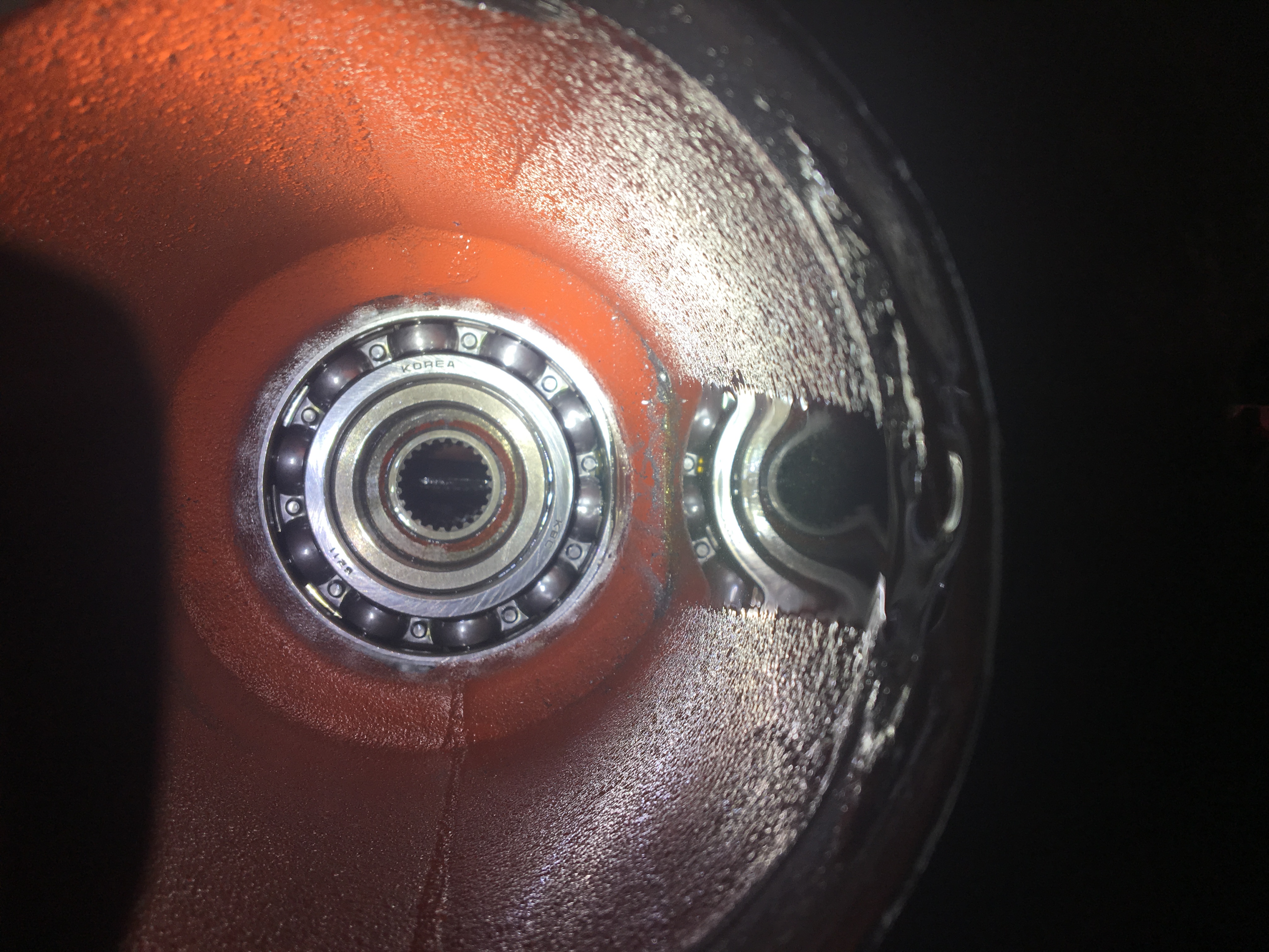

Well, I finally had a chance to fully pull both Final Drives off each side. What I found looking down the tube from the left side does not seem encouraging. It looks like gear bevel on the front diff and the pinion bevel is toast. I haven't pulled the bearings/gears on each final drive but as shown in a previous post, at least the right side needs some work. With all that being said, can I get an honest answer on if it might just be easier to buy a whole new axle assembly rather than pulling ever last bearing/shim/gear apart and ultimately finding a lot needing replacement? And if it's best to start pulling things apart, do I need to bring the final drives to a shop or can I remove these bearings with typical tools? I might be out of my league here...in case ya'll hadn't noticed. IMG_2404.JPGIMG_2406.JPG
   / Clunking in front axle? #60
Wow! That’s not a common issue! Sorry to see that. I doubt a whole new axle is the solution. If it’s over your head their are mobile heavy equipment mechanics that can tackle this. The normal operation would be to remove the front axle and work on it on a bench. You could do the R and R and a shop could do the ring and pinion setup and replacement. Setting backlash, pinion depth etc isn’t that big of a deal for a gear/axle or heavy equipment mechanic/shop.
