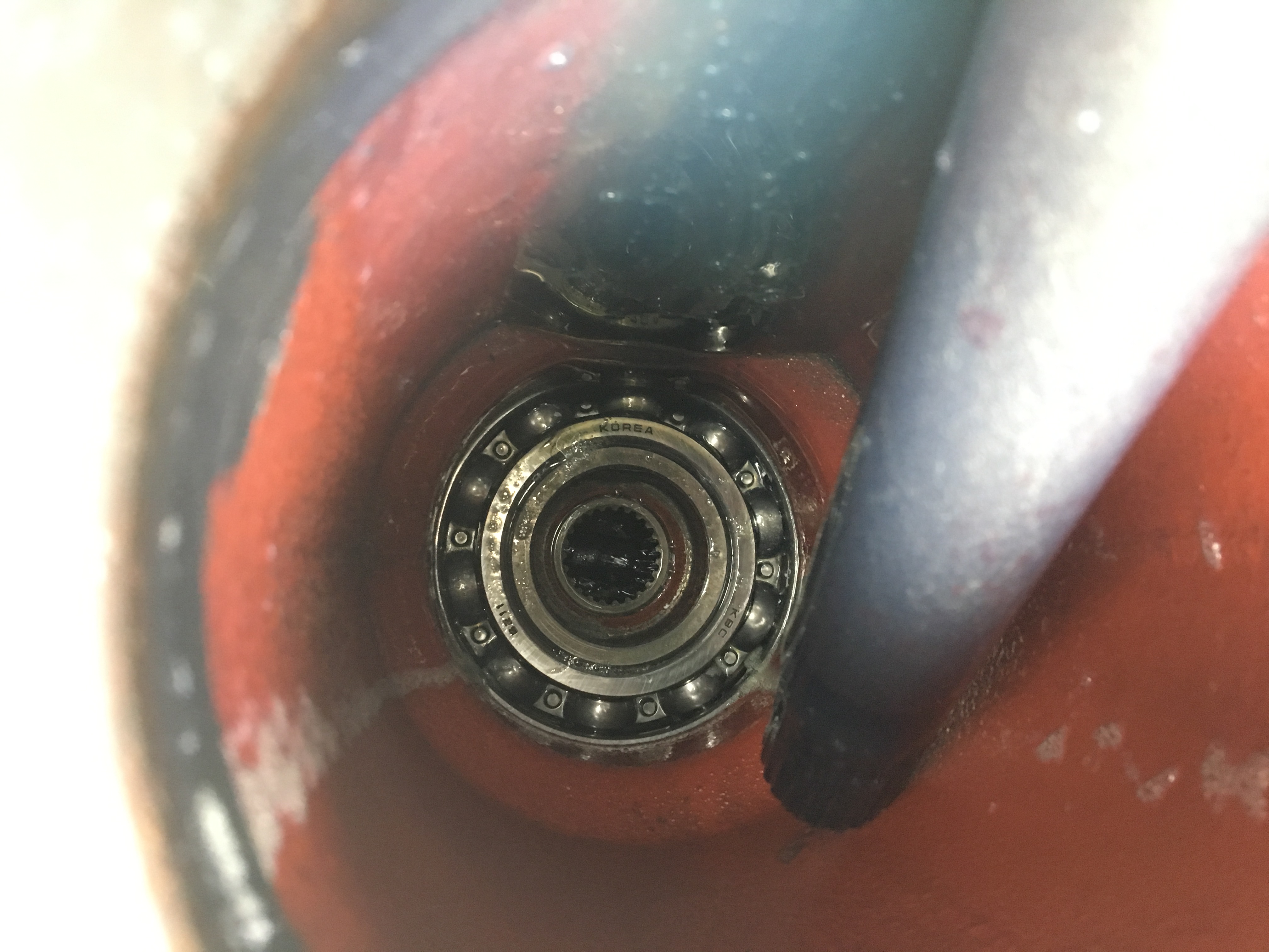

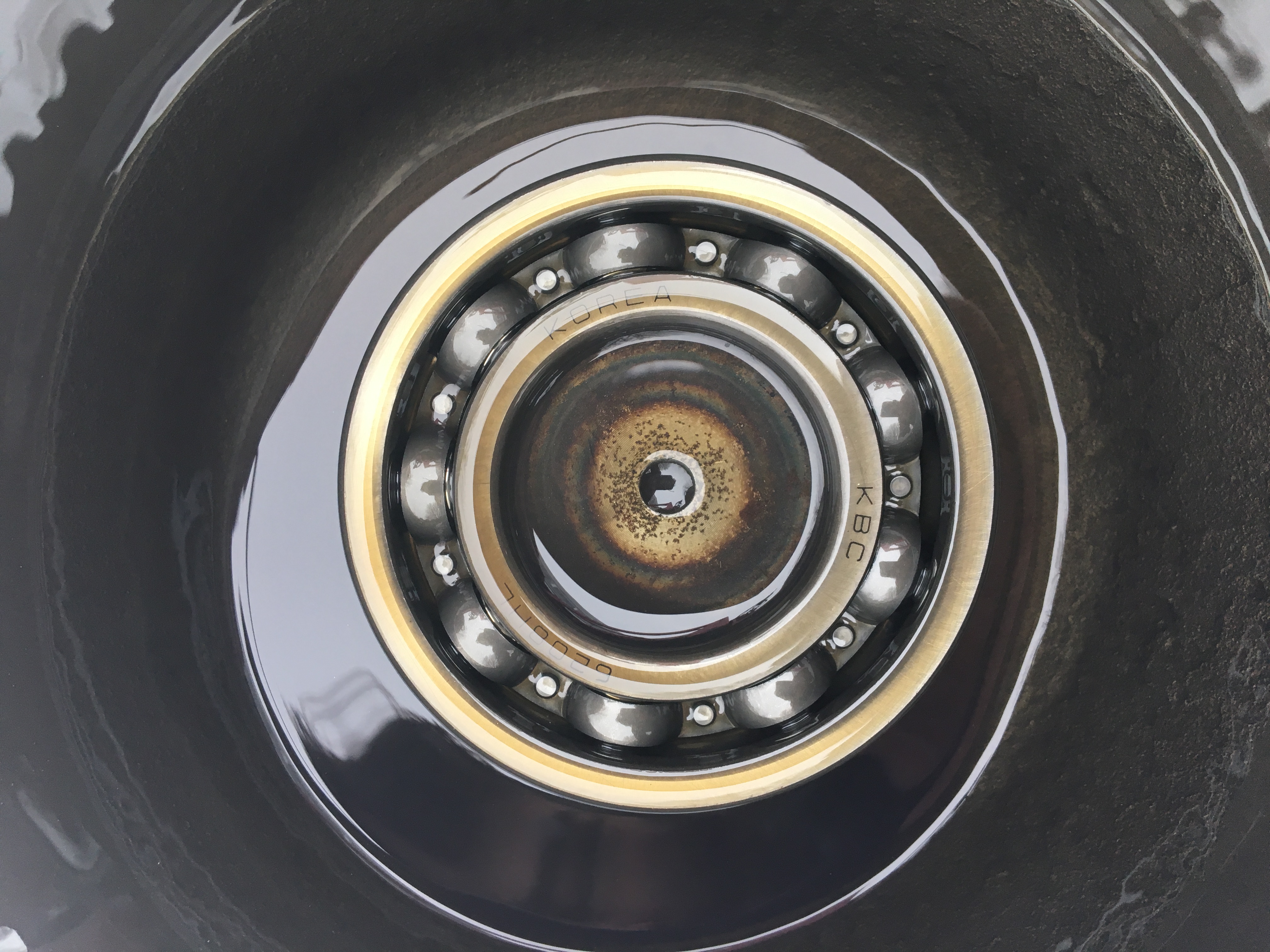

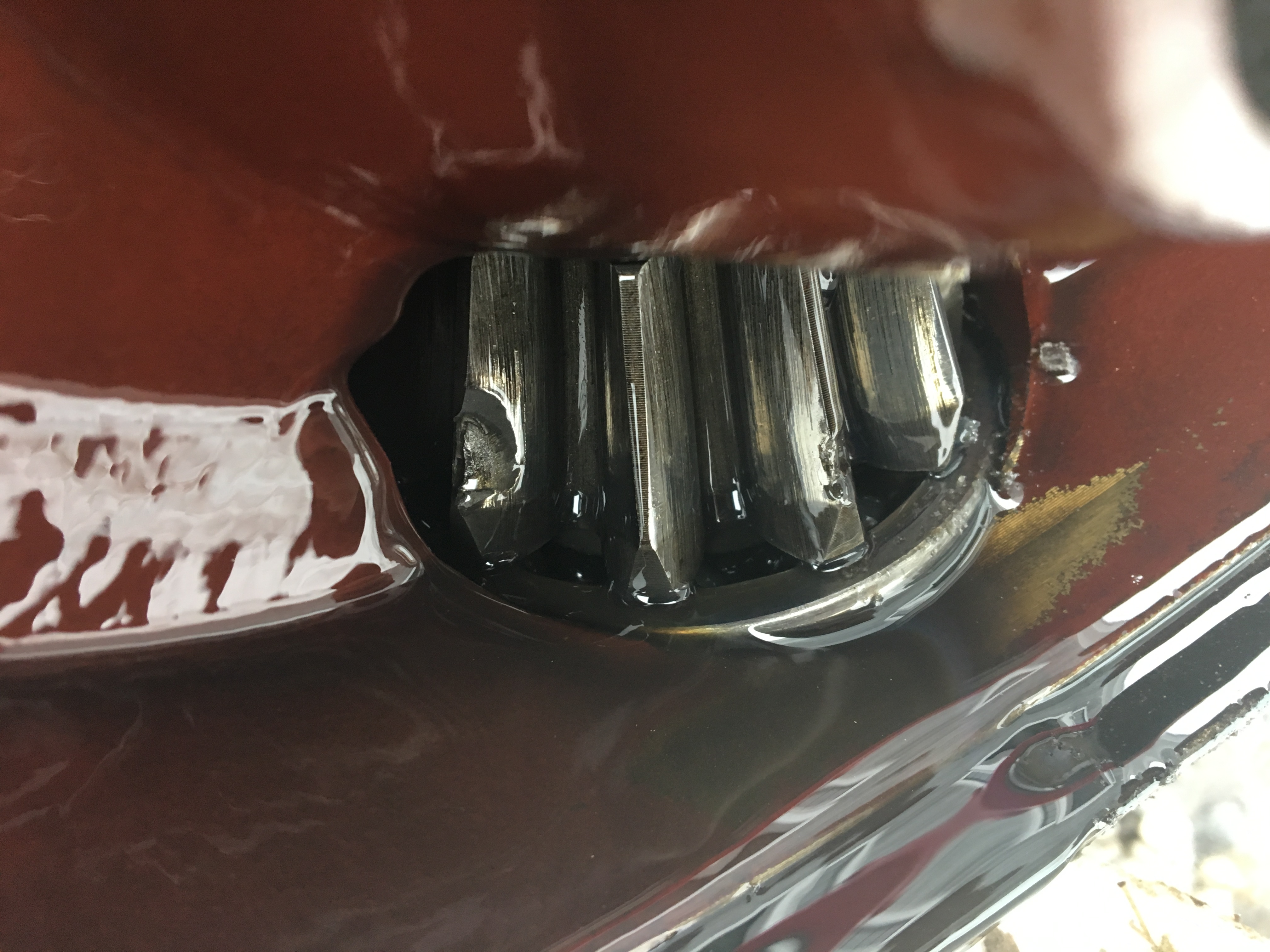

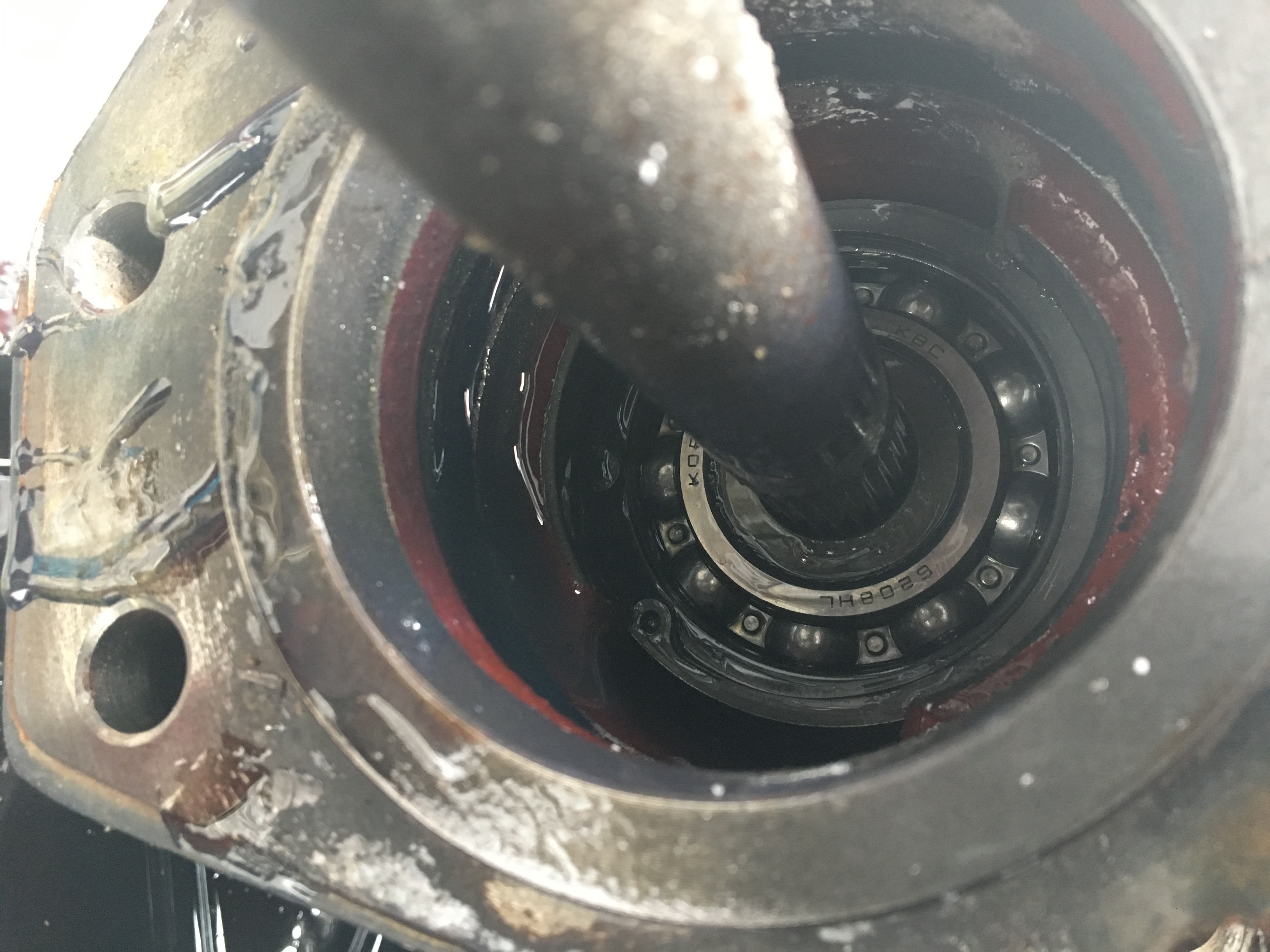

I took the right side partially apart the other day, and the bearings I could see looked fine. I did find some damage to one of the lower gears, as seen in the photos. I think I need to wait for a warm day and pull both sides and fully investigate it looks like. I can't imagine that that gear is the cause of the issue...rather it seems to me maybe it sustained damage because of a larger issue? Or perhaps it is the source? IMG_2091.JPGIMG_2092.JPGIMG_2093.JPGIMG_2096.JPGIMG_2101.JPG

“Lower gear” in the final drive or are you zoomed in on the diff.
   / Clunking in front axle? #48
Looking at the pictures
in addition to the large chips / damage in the drive gear teeth-
there are multiple vertical striations on the tooth face.
That is Suspicious...
Then looking at the large bevel ring gear
the shiny wear marks on the outer teeth face (right up to each tooth edge)
imo indicates excessive tooth lash between the gears.
The tooth faces should be smooth since they are a (sliding) surface that is created between the two gear tooth faces as the gears turn while meshed.
I would bet there is a bearing failure in either the support bearings for the damaged bevel drive gear vertical shaft bearings and /or the outer driven ring gear support bearing
(allowing movement /misalignment) since the inner bearing looks to be intact.
The most likely way to get those long striations is excessive gear lash-
I think the clearance got so large the tooth edges were actually digging into the small driven gears face as it was trying to drive the large ring gear,
also appears to be other misalignment going on and can't tell for sure from the picture but the ring gear does seem to have wear and (possibly) a damaged tooth face?
The oil on the ring gear may be making a reflective shine that appears as wear???
if it were mine, (When possible)- would check out the bevel drive gear vertical shaft support bearings and also the outer hub bearing. It will all need to be cleaned out anyway.

Looking at the pictures, in addition to the large chips / damage in the drive gear teeth- there are multiple vertical striations on the tooth face. The tooth faces should be smooth since they are a (sliding) surface that is created between the two gear tooth faces as the gears turn while meshed.
Yes, I saw those vertical marks on the small gear too. Normally, when you have a bevel gear set like this, the small drive gear will be machined at a higher quality, smoother, and harder than the large gear. It seems like some newer equipment has less emphasis on quality than it did years back. I believe the the marks on the small gear are crude machining marks, and on a hardened part, may lead to stress cracks.

The outer bearing is the one that goes bad. Balls get out and get between the gears.
