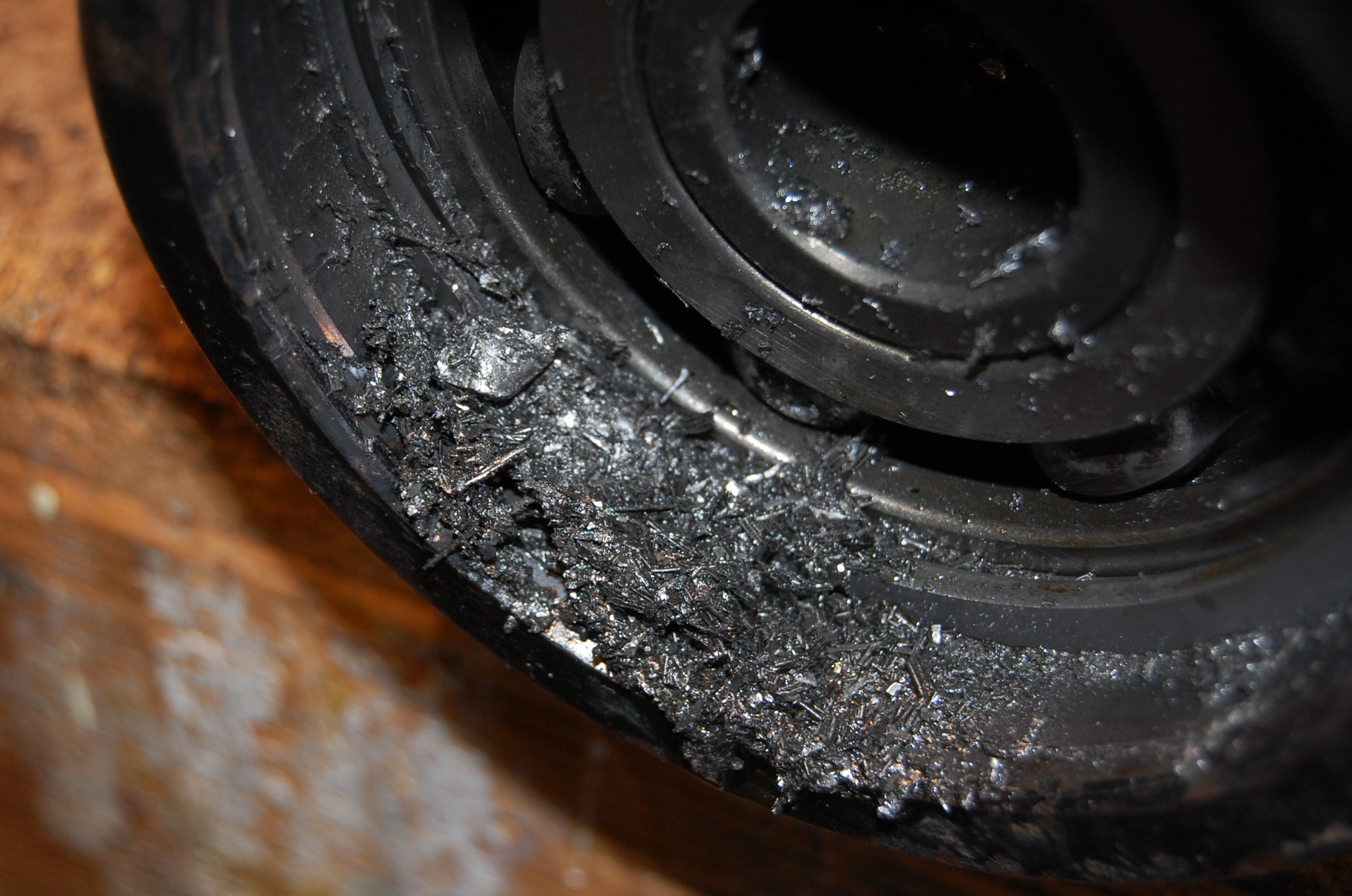

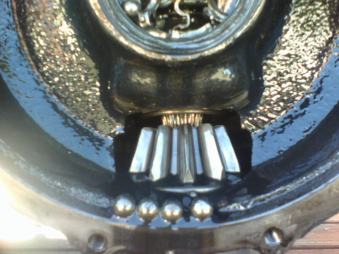

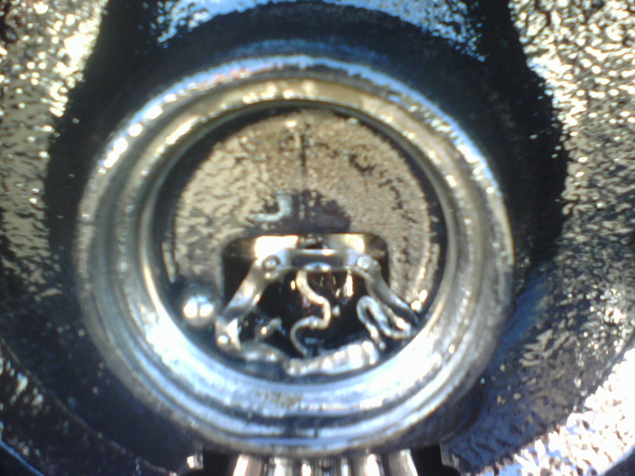

Mine did that too and the damage was quite extensive, here's what I found on the right side:
/ Clunking in front axle? #10
I always apply the KISS principle. Start with the front driveshaft.
Identify this problem before further use. In regards to drivelines, the failure will multiply if not corrected very soon.
/ Clunking in front axle? #11
As mentioned, check the front driveshaft first. Collapse the tube between the front axle and front trans case and see if either coupler on each end has broken or slid down the shaft allowing the driveshaft to flop around in the tube. I've never broken one but it is certainly possible.
I have had to replace the bolts holding the ring gear to the carrier in the front diff once, then a couple years later I had to replace the whole diff assy. - not cheap but made the tractor whole again. I think the diff assy was around $750 +/-. If that's your case, be sure to remove the whole axle housing out and thoroughly clean it out with a solvent of your chosing before putting any new parts inside. Your outdrives will be off the housing anyway to r&r the diff and it's not much more to remove it from the tractor where you can move it around to clean it GOOD. Any metal left in nooks & crannies WILL destroy your efforts eventually.
/ Clunking in front axle? #12

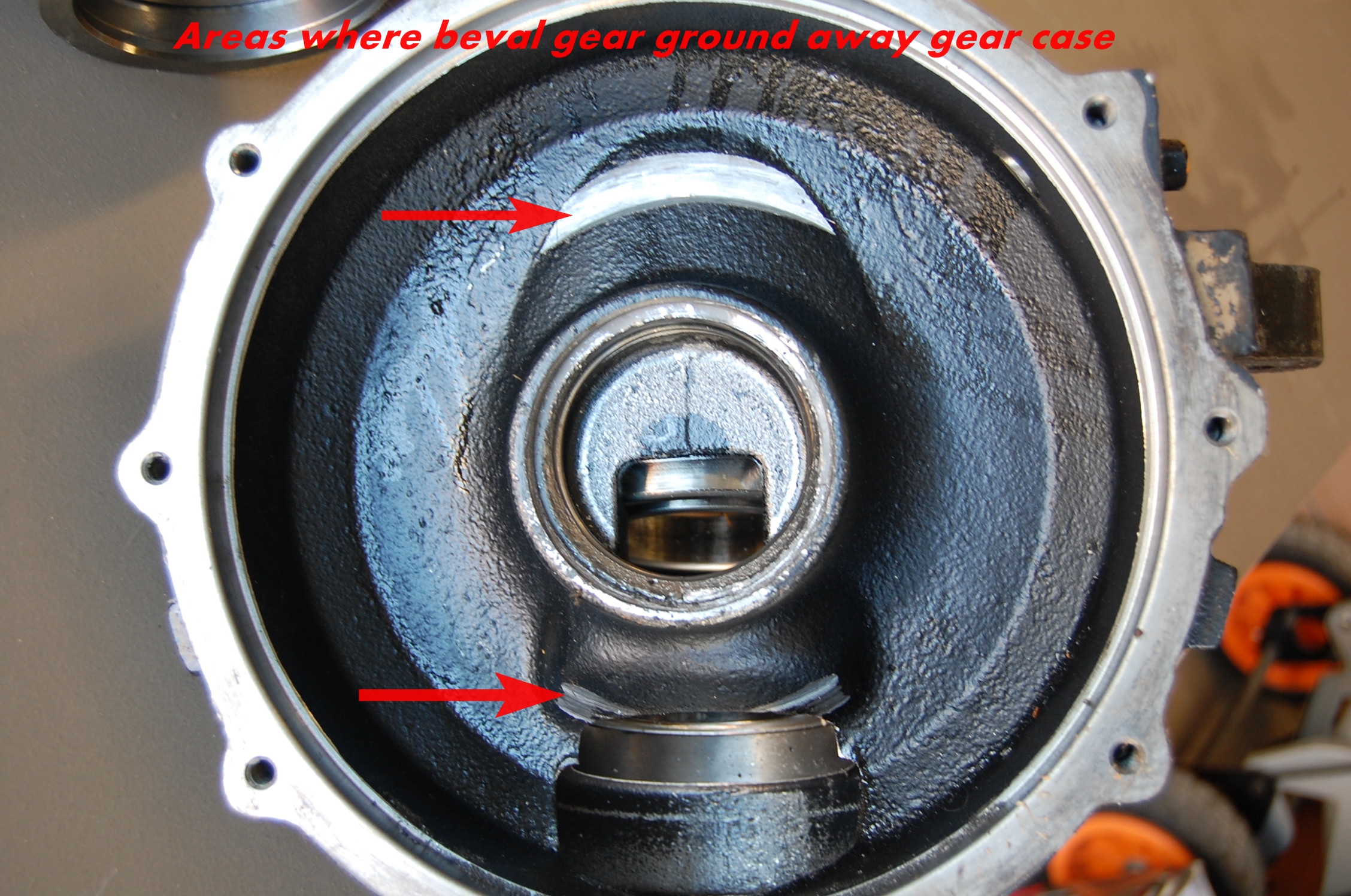

Yep, it's the bearing that supports the end of the wheel shaft. When this failed it allowed the bevel gear to "walk" and grind into the final gear case (see metal grindings 3rd photo). The grindings got into all bearings on that side. This "walking" of the bevel gear was the cause of my "lurching" when in 4WD.
If this is the problem with yours, you'll know which side it is because when you pull the lower drain plugs, the side with the issue will have the metal shavings. In the end after replacing the gear case, bearings and seals I was a little over $1,350 for parts and did the repair my self.
