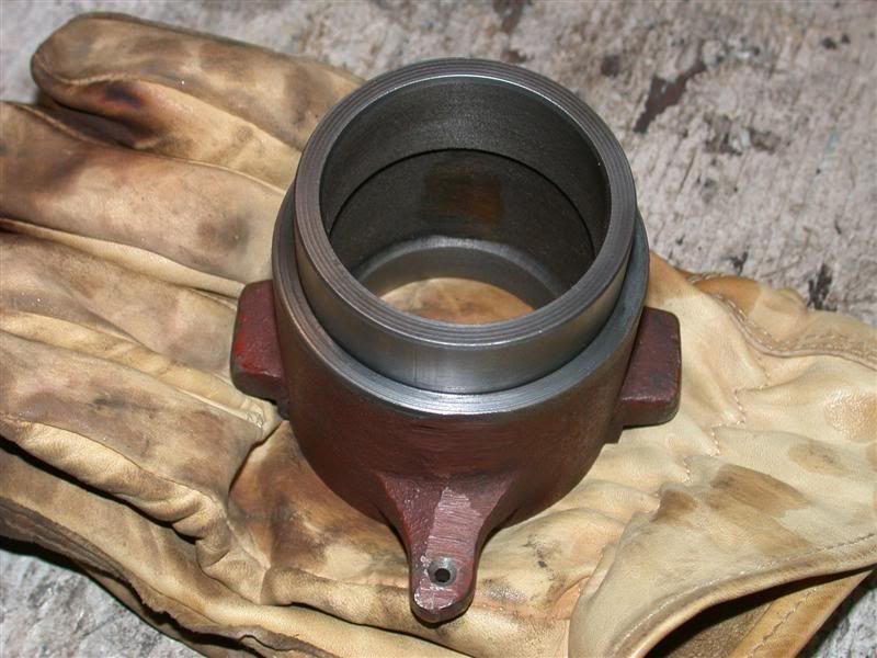

Greg, if your TOB moved off the seat, then the press fit was not adequate. When you re-installed the new TOB, did you tighten the fit between the seat and bearing ID? Or was it a better fit?
This was on the TS354C, the one that had the clutch linkage unknowingly jammed forward by some brush. Since the seat on that sliding sleeve was so badly scored, I simply replaced it.
So the twin return springs mentioned were on the TS354C. I never actually looked for any differences in the KM454 book. Since so many of the parts diagrams on my two tractors are identical, I just assumed the KM454 had two springs as well. My mistake.

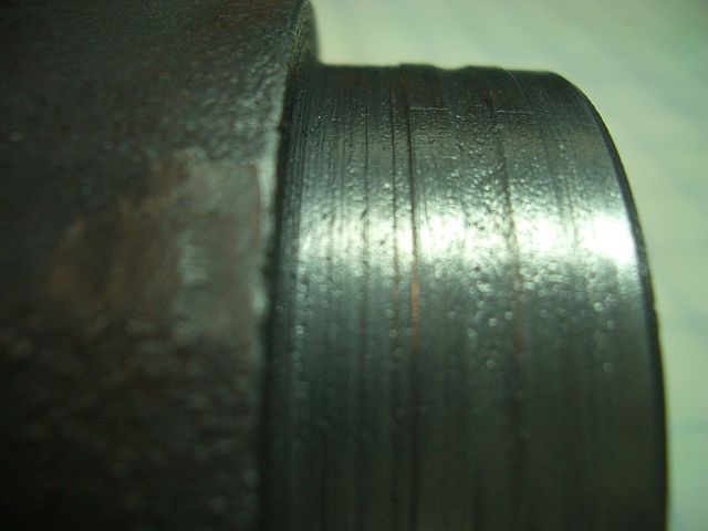

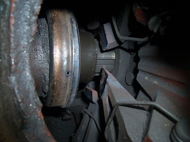

The KM454 still has the original clutch and bearings (one of which gets greased regularly). I detected finger wear early on, but adjusted it out before incurring irreversible damage. I now have one spare clutchpack and bearing set for each tractor. That's how I was able to test drive the 3-finger stack height adjustment, and conclude that it can realistically be performed on the bench
I initially got one of those bearings from Chip that didn't have a hole. Since it's not a sealed bearing, I didn't trust it to last without periodically refreshing the grease. It would have been easy to drill a 2mm hole myself, but I didn't want to chance metal fragments circulating in the grease. So I sent it back to Chip - with a request that it be replaced with one that DID have a grease hole. Now I can grease the TOBs on both tractors - at will, and without splitting.

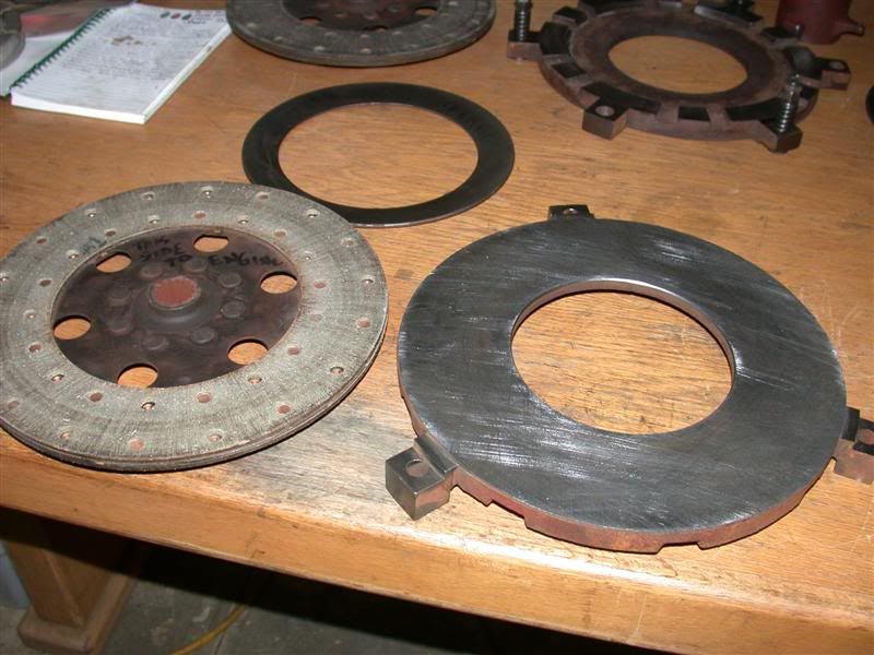

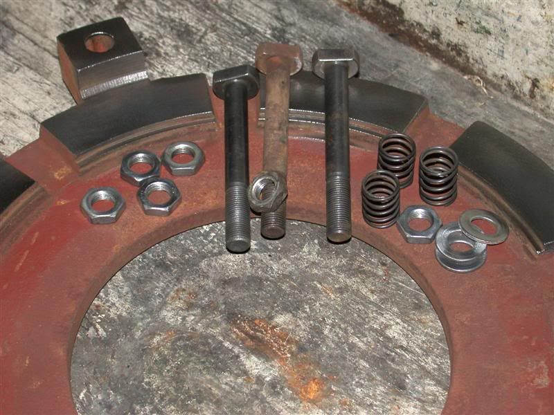

Today I cleaned the rust off every part.
Also roughed up both clutch discs and flat stoned all the pressure plates with a 220 grit YLS stone.
It was a lot of tedious work but worth it to me. One of the photos shows how dirty and rusty the bolts were for comparison. All the plates were that way before I wire brushed them.

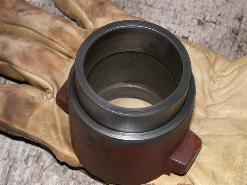

Some say no lube and some say yes, lube it. I know you don't want any lube to get into the clutch, so I'm torn between the two. Inspecting my sliding TOB seat, I saw there is a cavity ring between the two machined ID's. When I took it off, it had some residual grease in there. Looks like the cavity is there on purpose, perhaps to house grease? I know it's more work to machine that undercut in there, so I'm thinking it's got to be on purpose.
I mentioned before I'd like to add a grease fitting right to that sliding seat.
One I can get to from the same hole in the housing. If I'm going to do that, obviously now is the time.
I'm curious, what do others do there?
I'd like to hear the pros and cons. I already got Chip's opinion and I value that, but I'd like to hear yours.

I would favor a grease fitting on the sliding seat. With judicious geasing it should be a pure benefit. Short of that, I would not put it back w/o some lube. If it is to be non renewable it should be dry. I would use Slip Plate aerosol graphite by Superior Graphite. It forms an extremely thin coating that stays in the joint. I believe many parts in your assembly would benefit from it. Grainger has it. NH tractor dealers stock an acceptable CNH substitute. I recommend against other pretenders.

Regarding the sliding seat, in the plastic injection mold making trade there were medical molds (and others) that couldn't have any contamination from lubrication. We used to buy Graphalloy Graphite Impregnated stock and turn up our own bushings if they did not supply sizes for our custom applications.
We also used Graphite Plugged Bronze Bushings such as these for similar reasons.
The bronze was used for mostly low pressure though. I suppose I could turn the ID of the Seat and press one in, but I'd rather install a no brainer Zerk fitting.
That's why I asked the lube/no lube question.
The intent is to prolong the life of the part (parts for some) that failed and perhaps avoid (another) tractor split. As you can see from my documentation, the clutch itself and other components could last for thousands of hours had the throw out bearing not frozen causing damage and consequently, a failure.
LOL ... I'm just trying to make them work better without making it worse. Maybe I'm over thinking this, but having seen it with my own eyes causes me concern. What I'm getting at is I don't want to be splitting the tractor every 500 or 1000 hours to change the throw out bearing, especially if the other components are still good.
