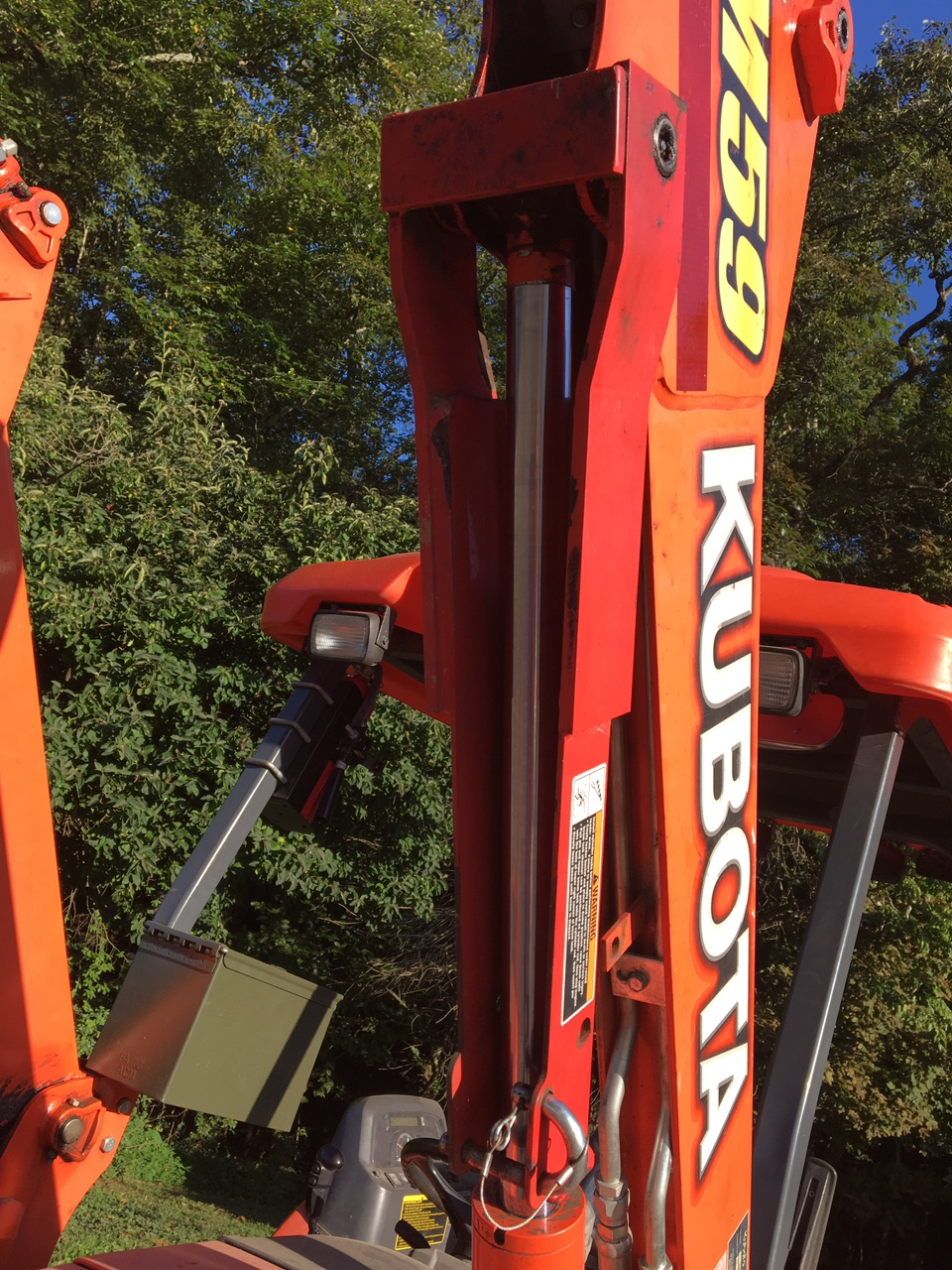

Like to think they engineered appropriately to be safe.
If they are smart, they engineered it for idiots, so it would stand up to someone leaving it in place and then trying to close the cylinder with hydraulic pressure.
That would have to be much stronger that something that just needs to oppose gravity and hold up the weight if the hydraulic pressure in the cylinder went away.
A section of pipe with the right ID to match the OD of the ram would be my choice, cut it in two length wise and you have one for both sides. Both with 180 degrees of contact.
How much are you willing to bet? A life?

Messicks has the M59 loader prop called “stopper, boom” for $173. Needs pins and bumpers. Might work on other large loaders.

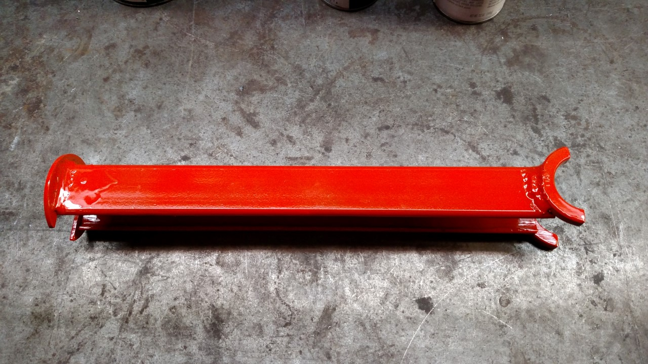

No. This is to get the loader out of the way to gain some floor space during the winter. I don't want to remove the loader all together and leave it outside since I may need it for snow removal.
Next week, I'll be stopping by the steel supply center and look into picking up a couple lengths of 2" X 1/4" angle to make some cylinder props.

I'd get some square steel tube and cut the side out. Make some ears for it so that to install and uninstall it you need to push the rod further out. Safest way to do it.

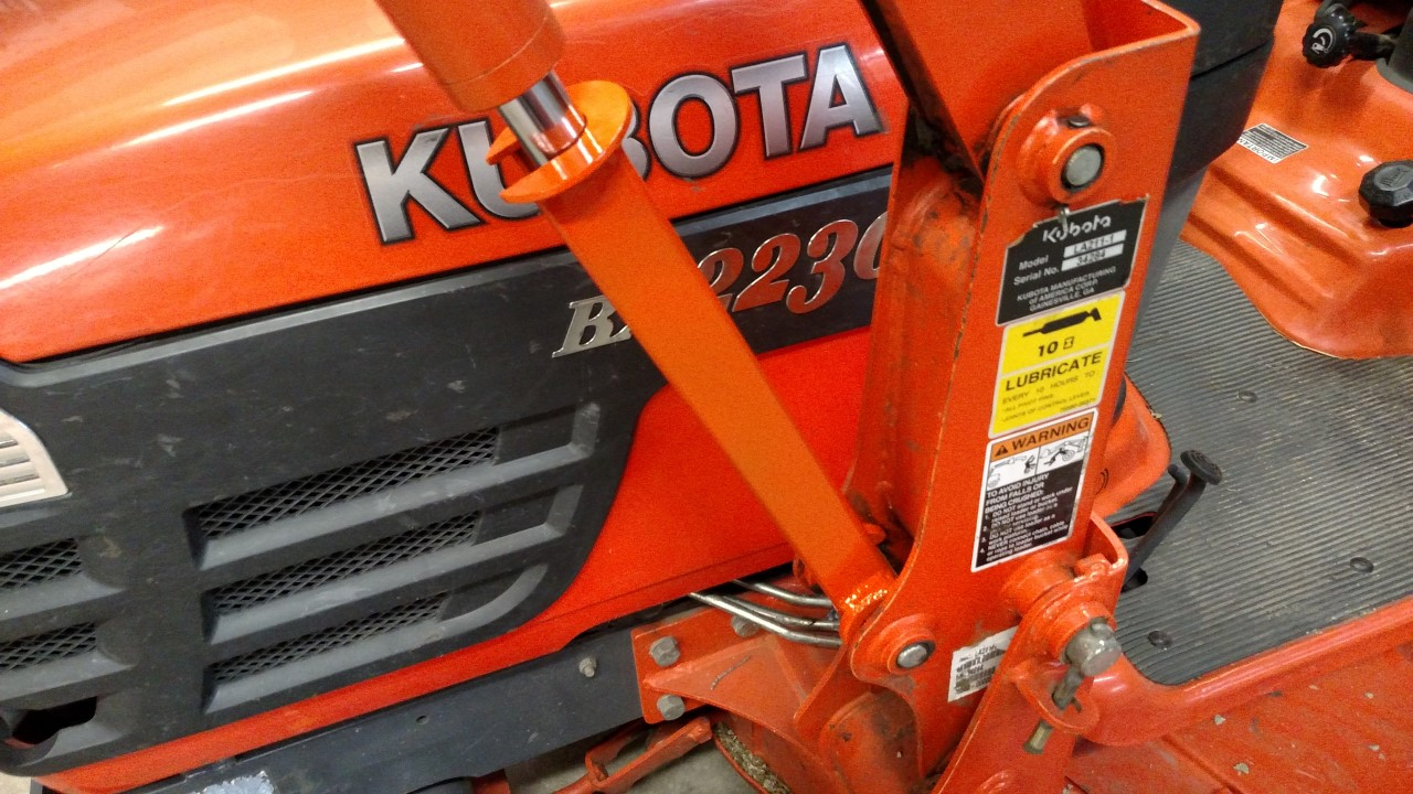

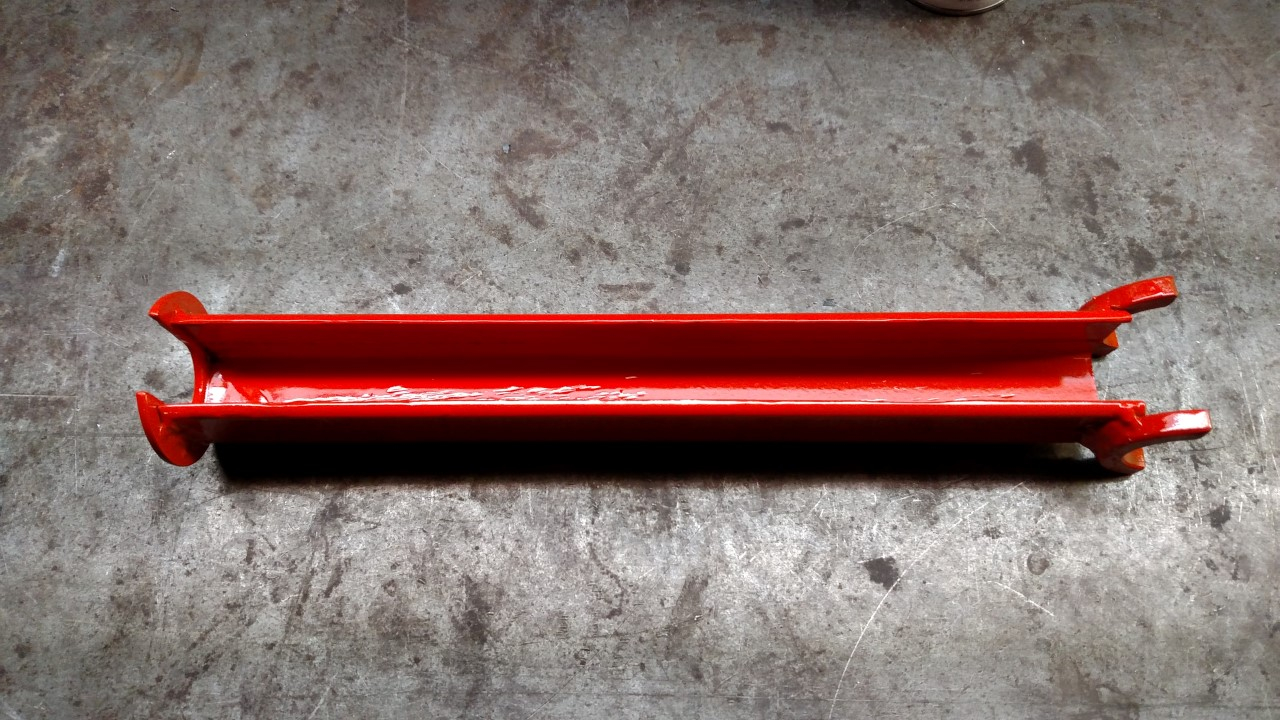

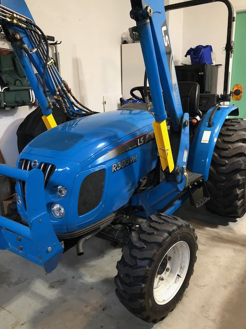

I decided to go the Commercial route. Got these from www.rpmstore.com.
