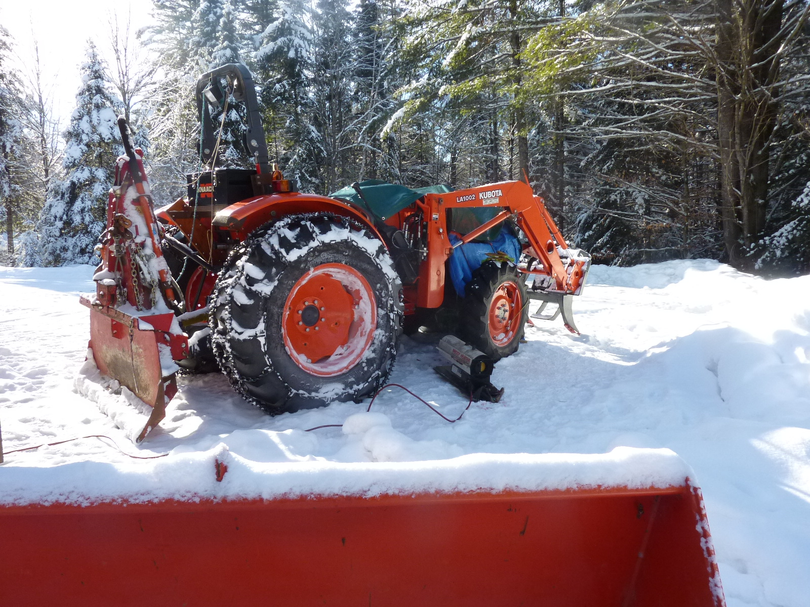

My track steer ( ASV RT-50 ) still has summer diesel and would not run more than 5 secons after starting. Been -14 F for several days.
What's my remedy?

Yikes. At that temp with summer fuel the diesel is almost certainly gelled in the tank, lines, and filters. I believe untreated diesel #2 gels at 0 deg f, with the CFPP (Cold filter plugging point) is around +10 deg f.
Personally, I would try tarping the machine with some type of heater underneath, or just leave it for warmer weather.
If you must start it, I guess adding a degelling agent like Power Service 911 would be the way to go. It will likely have to be added to the tank if that fuel is in fact gelled. Replace the filters and fill partially with 911 to move the degelling agent through the lines.
It could be quite a project to get it going in -14 degrees.

911 red can diesel treatment into your existing fuel, take off the existing fuel filter and fill up with fresh fuel with a new fuel filter and screw it on following the priming instructions (likely a bleeder screw on top of the filter housing.
Summer diesel is number 2, and you should cut that mix with 1/3rd diesel number 1 or kerosene for operating below 24°F
For operating in really cold stuff, your ASV dealer should have cold prep kits that warm the fuel lines, heated fuel filter housing, block heater, ether start systems, engine oil and hydraulic oil heaters, and even more. Trust me, the guys building ASVs know what cold is.

Cut fuel in tank by about 50% with kerosine and added PowerService 911 for good measure. Could see globs of wax suspended in tank. Changed filter. It was a bowl and cartridge type - solid wax. Tarped machine and heated to free up fuel lines and pump.

Starting Wednesday it should be getting warmer up there. For the normal winter fuel treatments, it should be dosed and mixed above freezing to work. If you can, wait for a warmer day to suck out half the fuel and dump in some #1 fuel. You will probably have to change out the fuel filter and remember the bleeding process.
