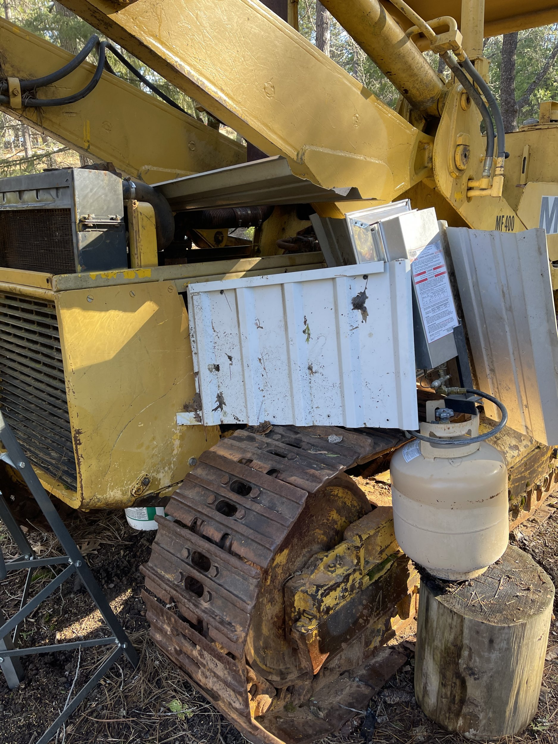

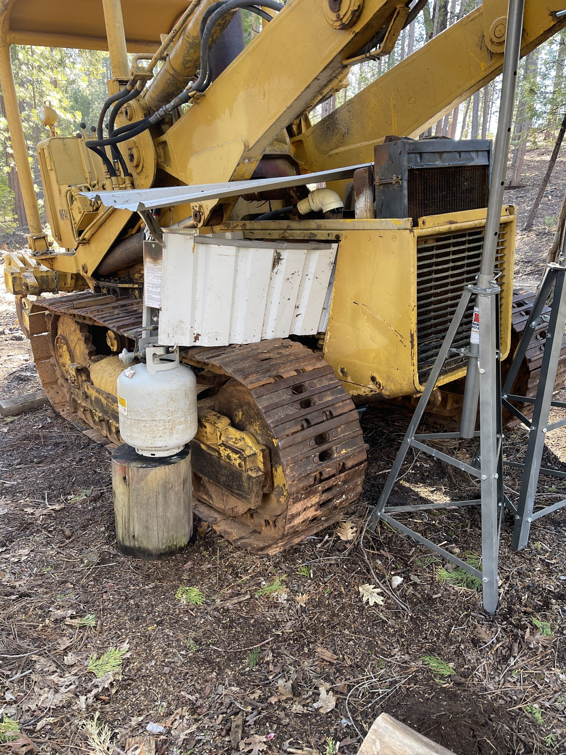

Cut fuel in tank by about 50% with kerosine and added PowerService 911 for good measure. Could see globs of wax suspended in tank. Changed filter. It was a bowl and cartridge type - solid wax. Tarped machine and heated to free up fuel lines and pump.

This looks familiar. The biggest difference is the brand of space heater.

In those pictures I was trying get the rusted piston rings freed up. Kinda crude, but it didn’t work.

Dilute 50% with kerosene. Remove and replace fuel filter filled with 50% diesel 50% kerosene. Point a small torpedo heater near the block/fuel tank. Put a piece of old tin roofing on the opposite side of the machine so that warm air goes up through machine. Careful using a tarp, they are flammable. Block heaters do nothing for frozen/gelled/wax fuel. The 911 products added to the fuel filter Only get the machine running ,will not keep it running. Keep topping up the tank with truckstop winter diesel. Label a 5 gallon container and store it till next year. It works here in Vermont.
