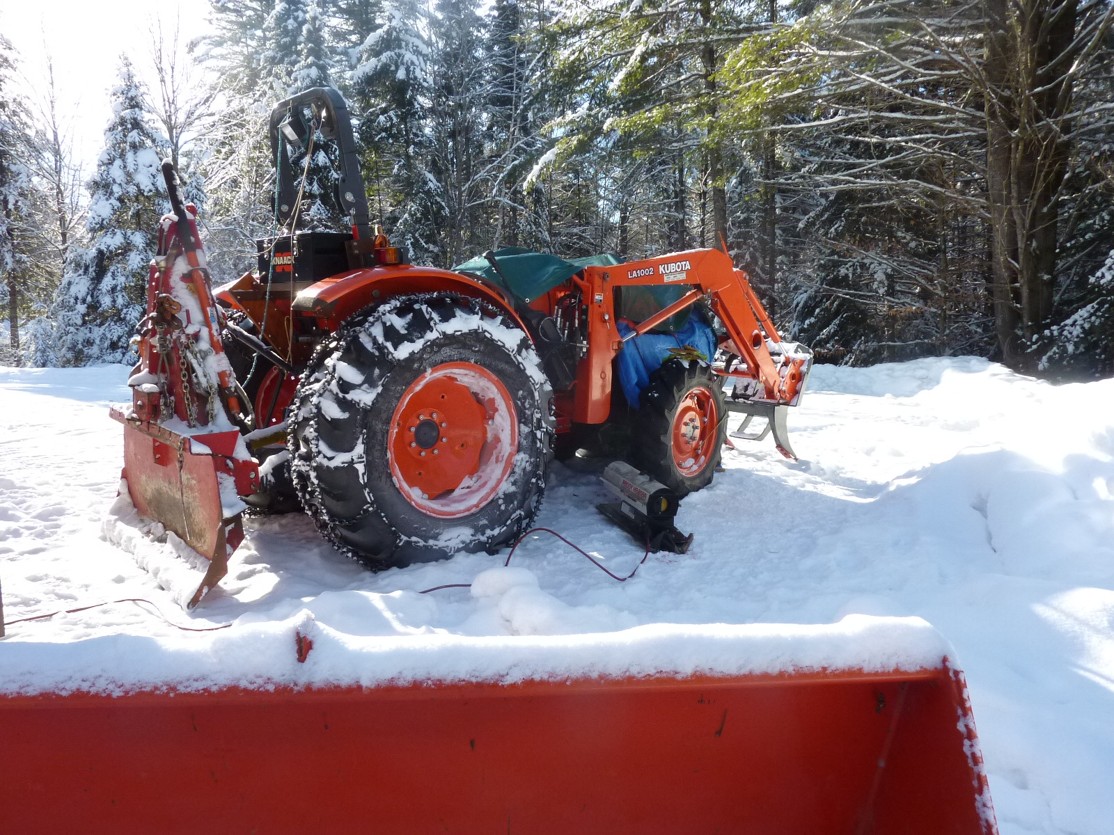

Cut fuel in tank by about 50% with kerosine and added PowerService 911 for good measure. Could see globs of wax suspended in tank. Changed filter. It was a bowl and cartridge type - solid wax. Tarped machine and heated to free up fuel lines and pump.
gg
This looks familiar. The biggest difference is the brand of space heater.

My track steer ( ASV RT-50 ) still has summer diesel and would not run more than 5 secons after starting. Been -14 F for several days.
What's my remedy?
Many thanks,
GGK 87 yo rookie
Dilute 50% with kerosene. Remove and replace fuel filter filled with 50% diesel 50% kerosene. Point a small torpedo heater near the block/fuel tank. Put a piece of old tin roofing on the opposite side of the machine so that warm air goes up through machine. Careful using a tarp, they are flammable. Block heaters do nothing for frozen/gelled/wax fuel. The 911 products added to the fuel filter Only get the machine running ,will not keep it running. Keep topping up the tank with truckstop winter diesel. Label a 5 gallon container and store it till next year. It works here in Vermont.

Blankets and a heater and bring it up to temperature might take a day to get everything warm and then run it until you can refill more than half of the tank with winter cut fuel

Project farm on YouTube has a great video on winter fuel additives for lowering gel point. Pull the filter get it warmed and refill with hot shot, add a bunch to the tank. Start unit it will be sputtering but run on the additive as it clears the line. Top the tank with winter fuel.
   / Cold rookie mistake #34
As stated: Tarp and heat till fuel is no longer gelled. Add fuel treatment and run tractor till all the gelling is gone. Then add proper fuel.
Note: additives containing alcohol are Hard on fuel pump.
I gelled up this past week, too. We dipped to -25F (NW Montana). The tractor got tarped and it got a propane based space heater spa to liquify the lines and filter. I put in some combo treatment and alcohol in. The store only had it available in gallons so that is what I had to purchase. I used a total of 4 ozs, and now I wonder if I should junk the rest because it has alcohol?
