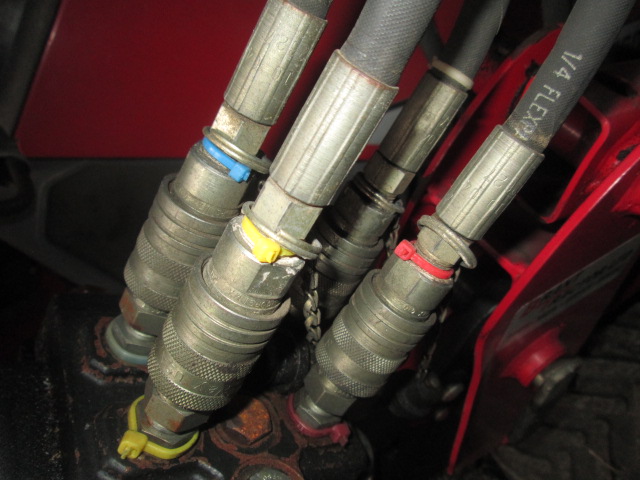

I had a small leak in my valve so I took out the fittings and replaces the O-Rings, and forgot to note which one went where...
Of course it doesn't really matter which one goes where, but if the color coding from the zip ties is going to be helpful, it does make a difference.
Someone have a pic of their valve?

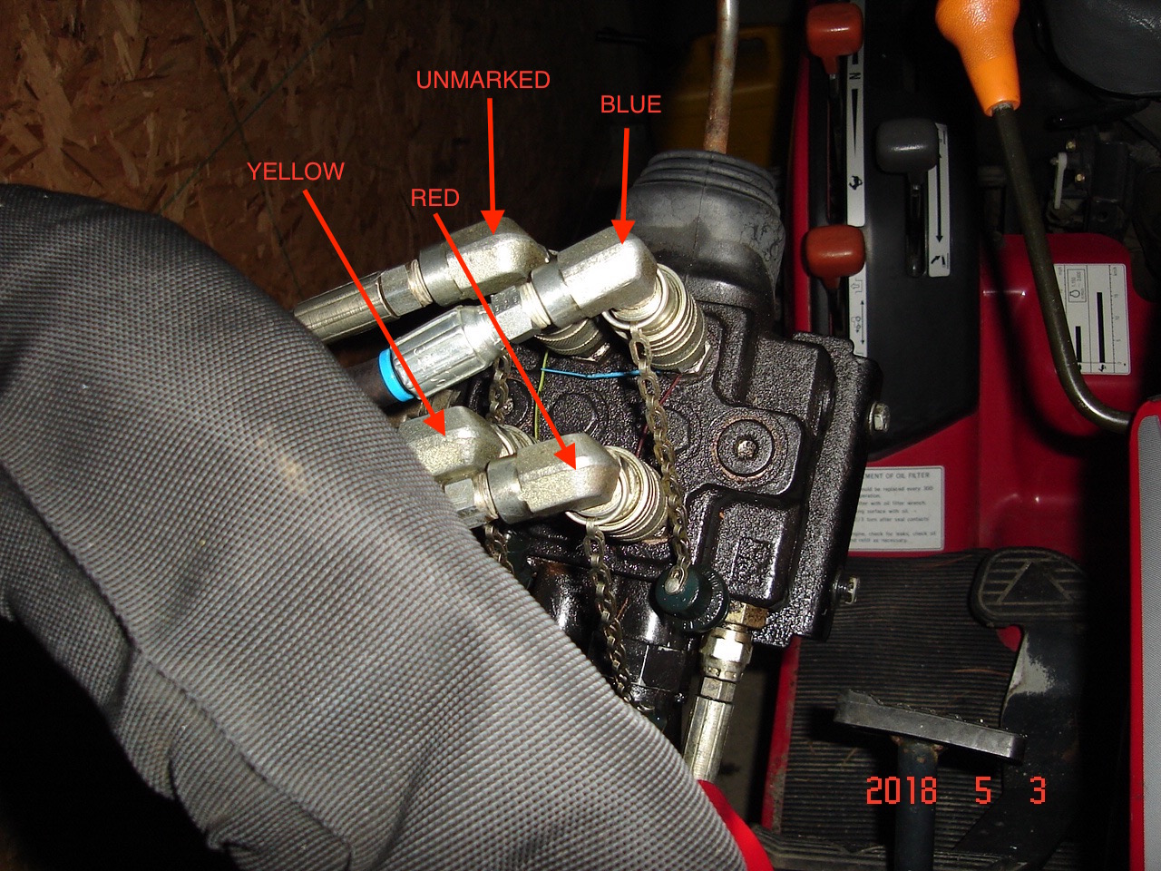

/ Color Coding on GC Loader Valve #2
Here's the way it is on my 2310, but keep in mind there have been some discrepancies in the colors occasionally from the dealer or factory....
This is standing in front of the tractor looking rearward.

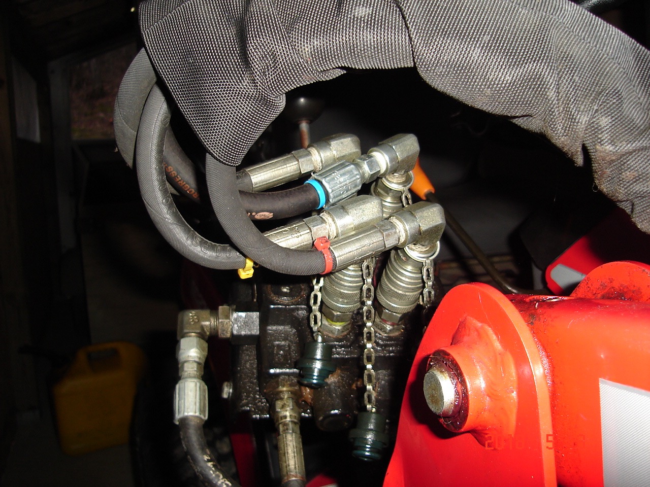

/ Color Coding on GC Loader Valve #4
I don't think there is a "factory" colour code for the hoses. My GC2300 is a bit different.Nimco valve block.JPG
The ports I posted are not the actual correct ones, just the closest to the couplings, so I deleted them, to avoid confusion.
The spool on the left side controls the lift arms, the spool on the right the curl function.
Direction can be changed by switching the connections curl rod/base, or the lift rod/base

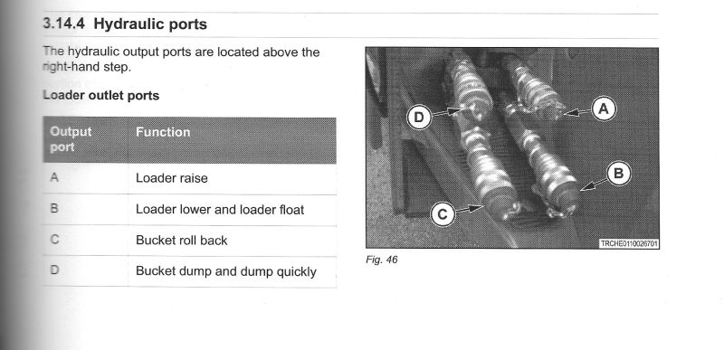

/ Color Coding on GC Loader Valve #8
the manual has a pi ture and description of each of the couplers.

Mind helping a new guy? I also have a slight leak. Is there anything else inside the valve I can lose besides the O-ring?
I had copied this from another poster:
Tilt cyl rod: Red
Tilt cyl base: Blue
Lift cyl base: Green
Lift cyl rod: Yellow
-Phil
