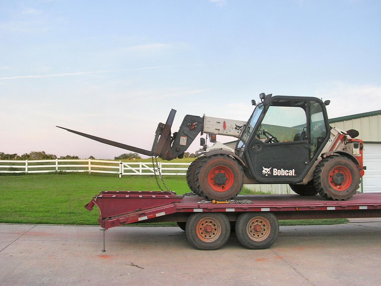

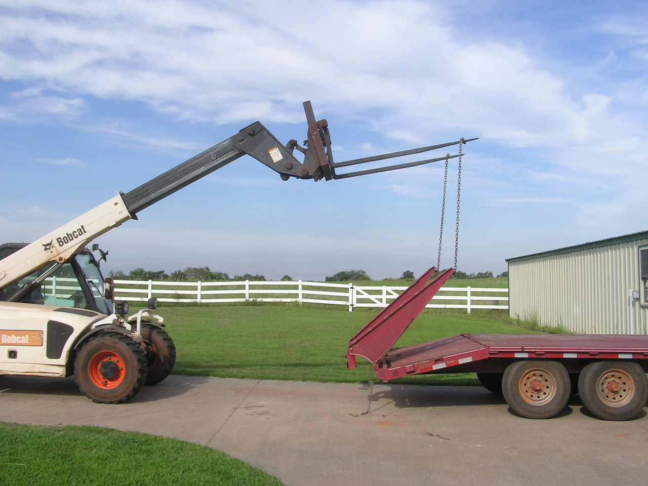

I replaced the original battery with an AGM battery 5 years ago.

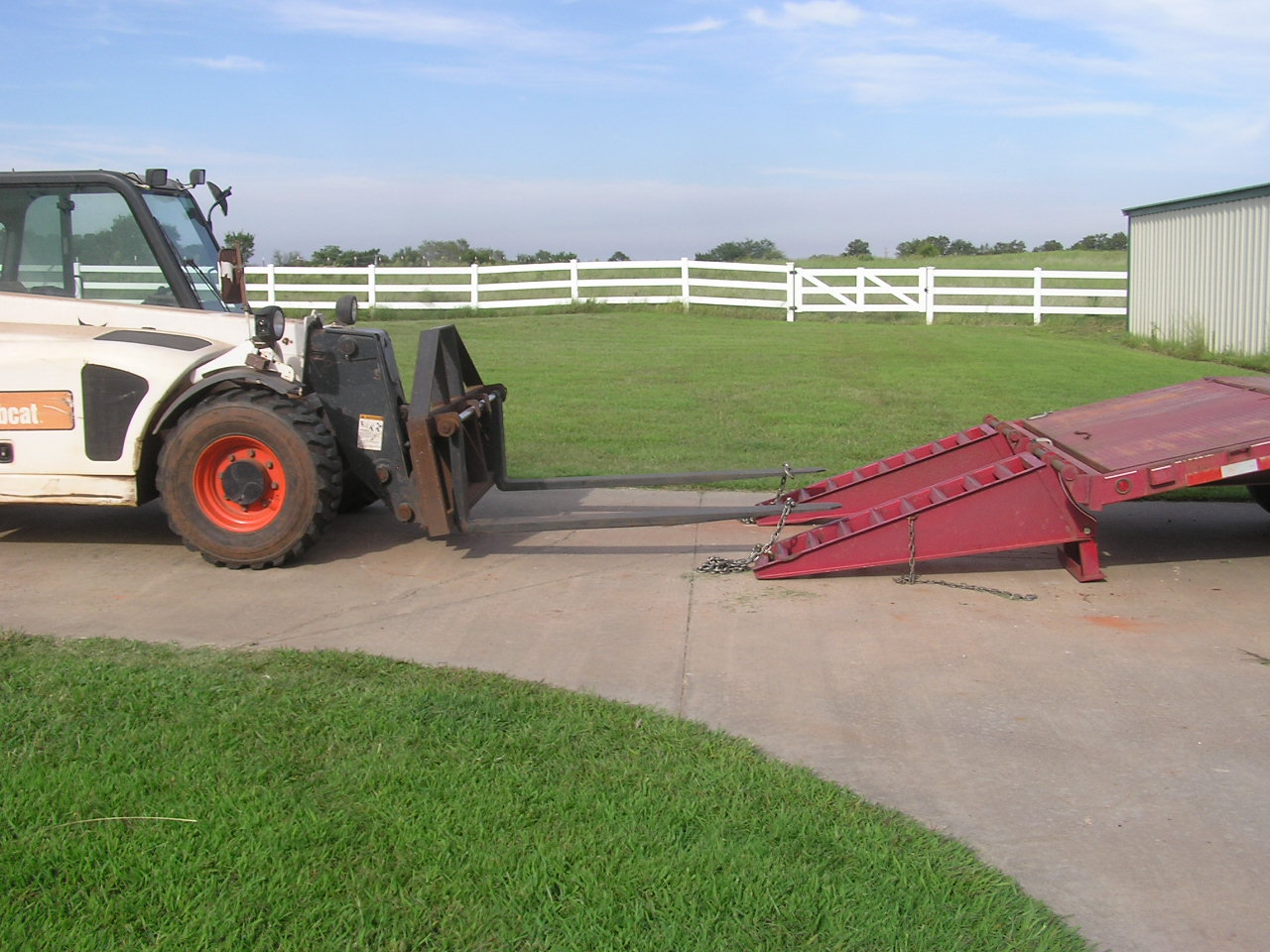

This is how I replaced it. Put the V417 up on the trailer:
Removed the old (black) battery:
Set the AGM battery on a bucket:
Slid the bucket in and over:
Shoved the battery up in place and clamped it down:

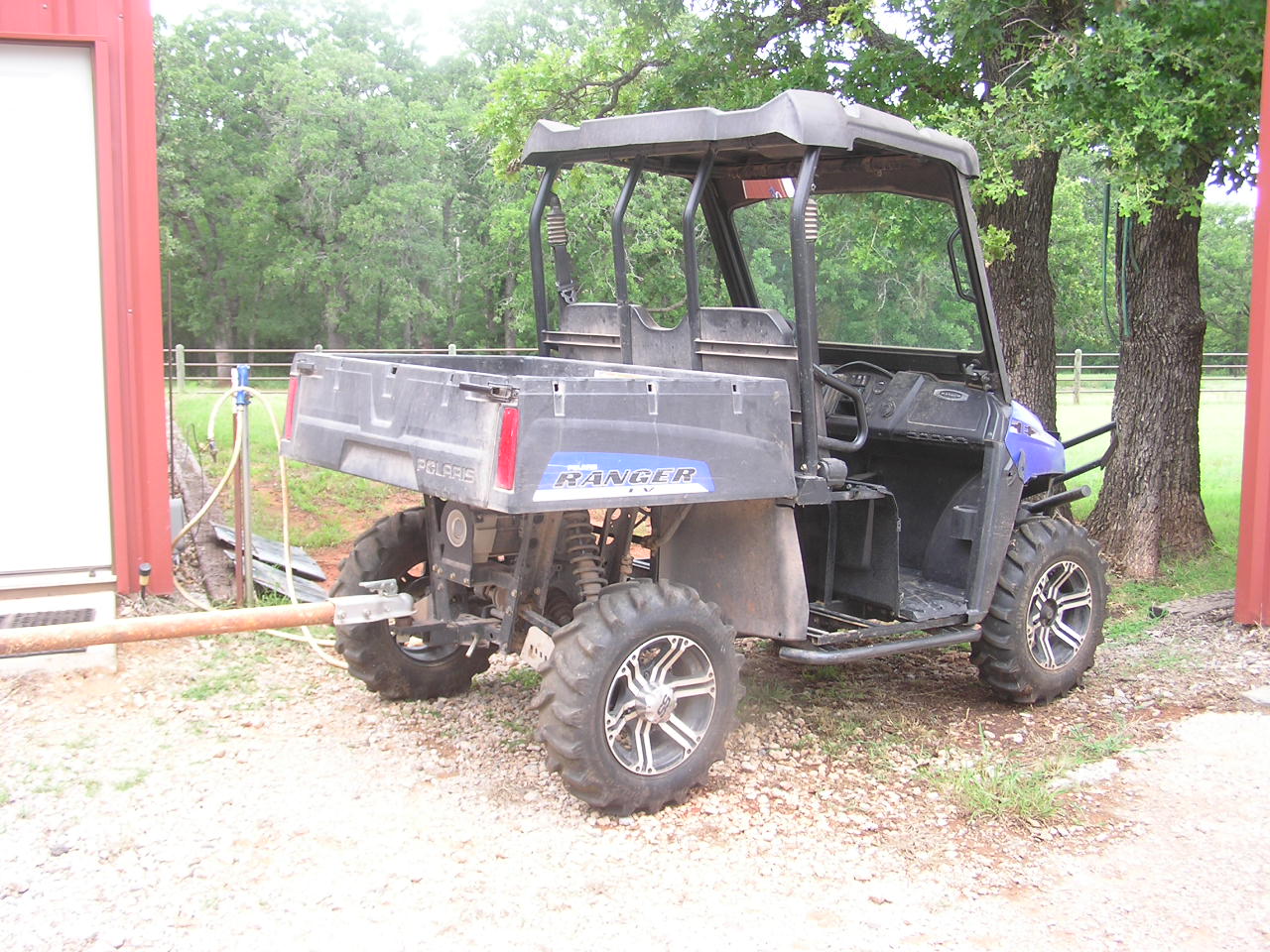

It is an old ammo box that someone painted before I bought it.
Use it for chain and strap storage:
And another chain storage spot:
And shovel storage place above the box:

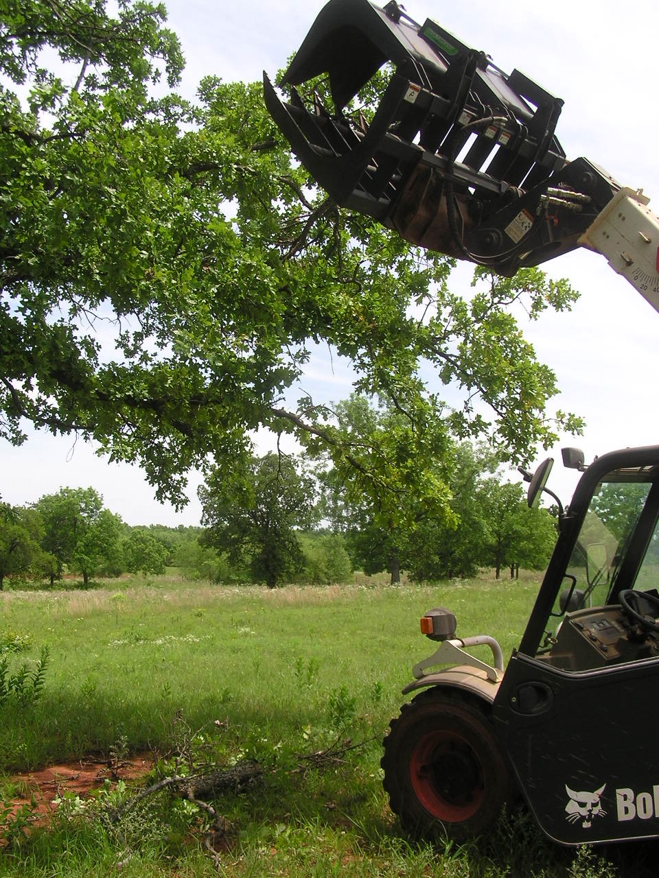

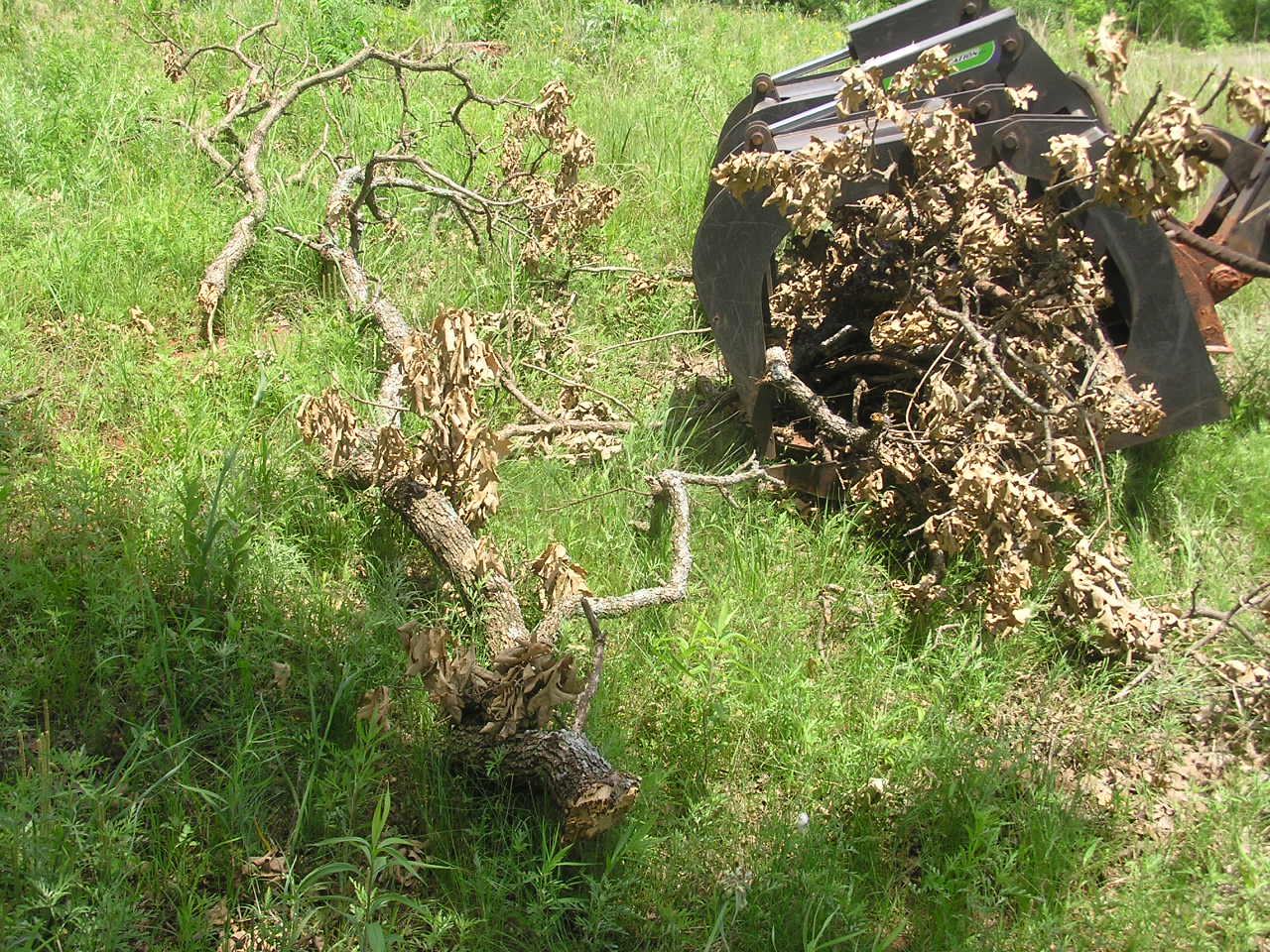

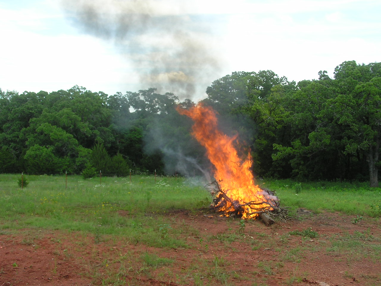

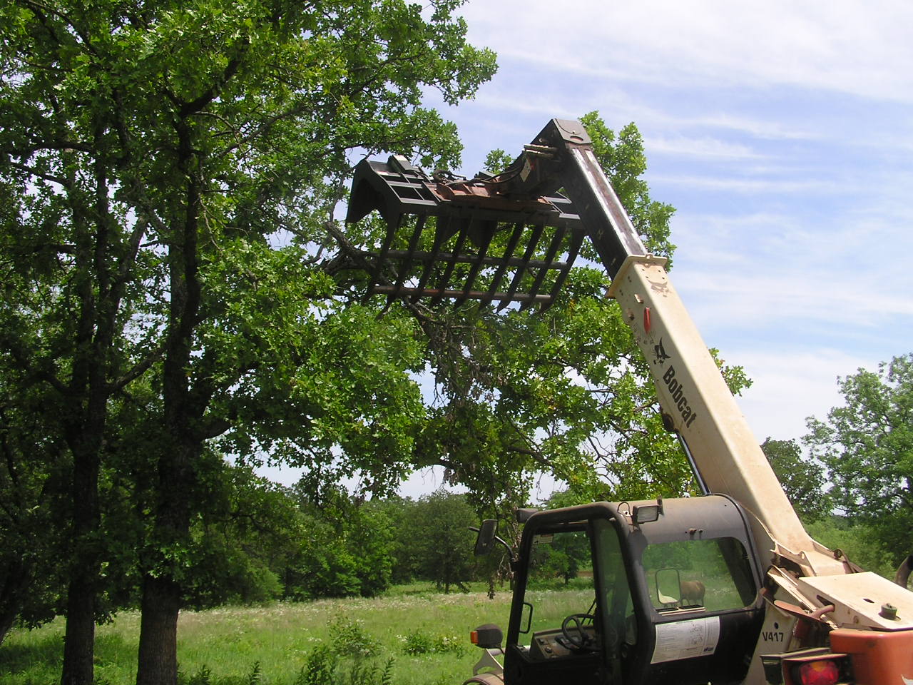

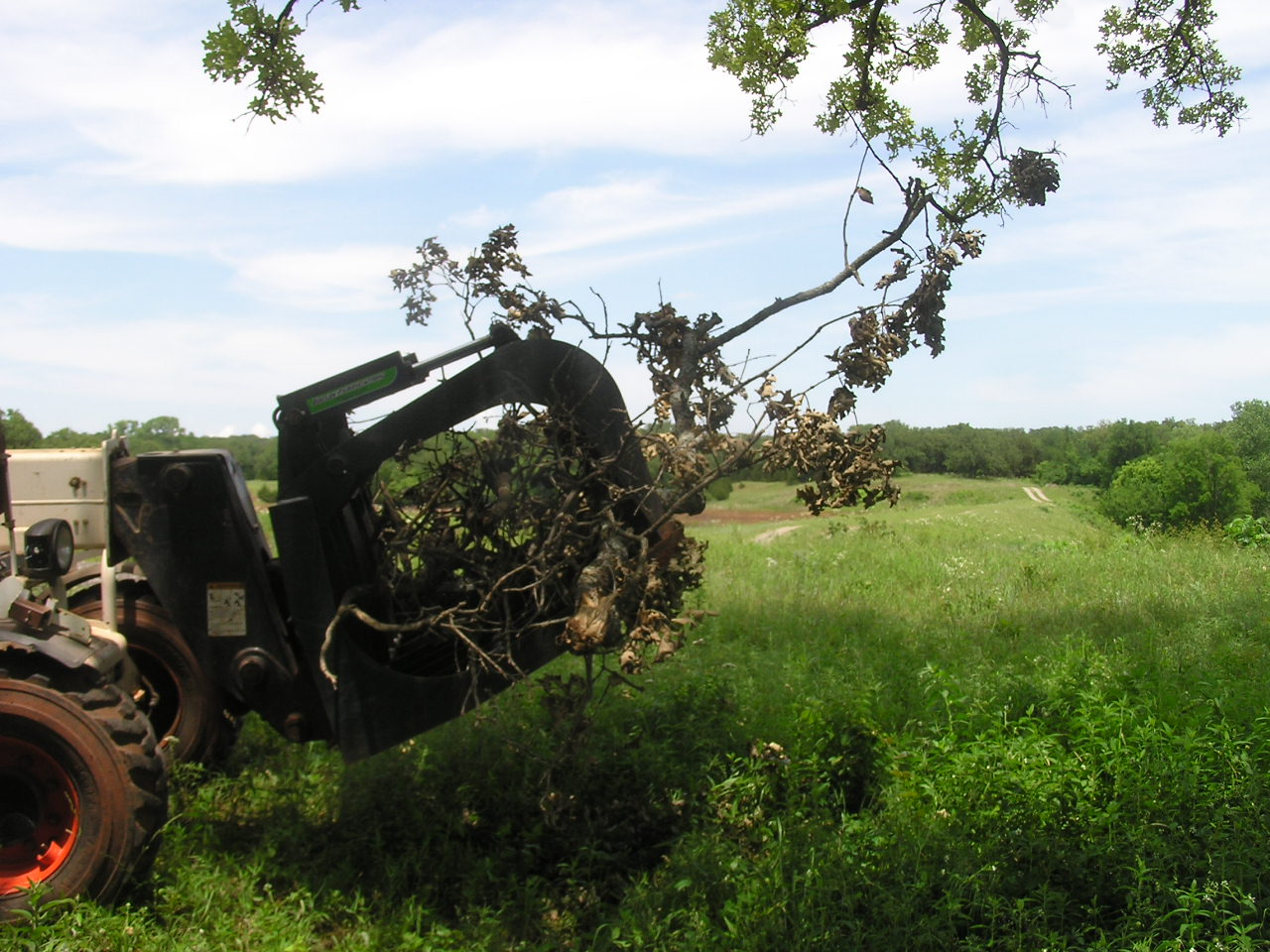

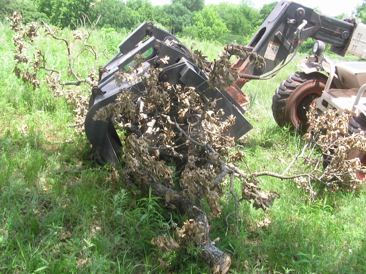

Hooked the chain to the tree I pushed over two months ago:
Dragged it out of the woods:
Pulled it to the brush pile:
Picked it up with the grapple:
View from the seat, pulled forward and extended the boom to put it out over the pile:
Opened the dual lids and gravity grabbed it:
