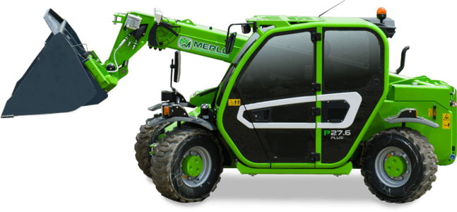

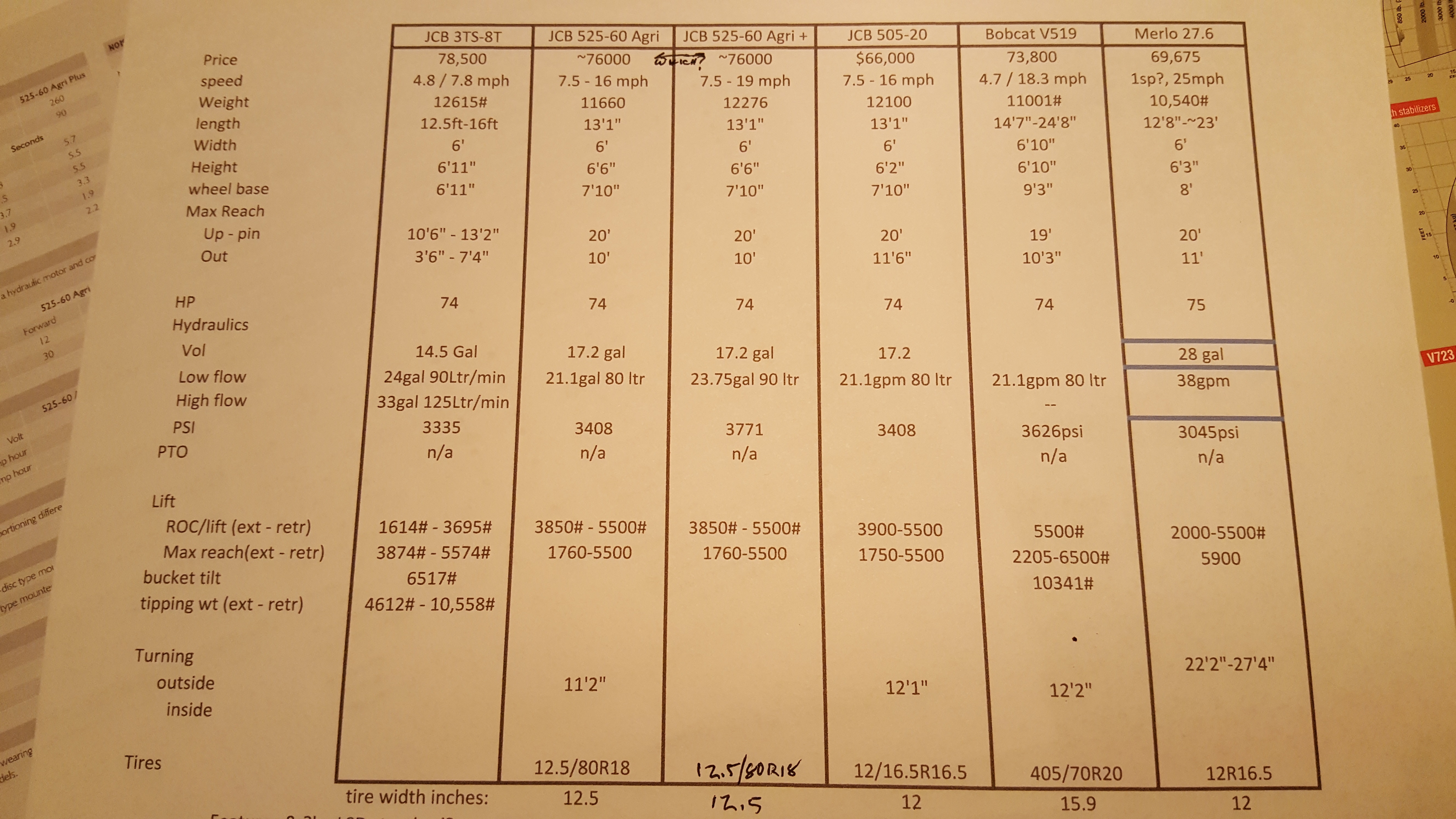

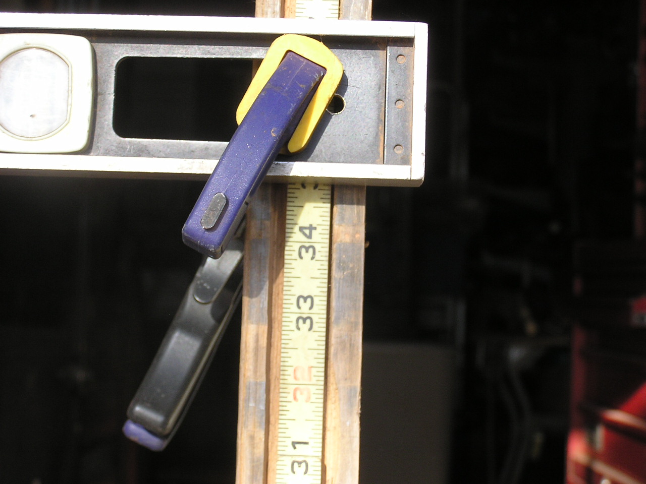

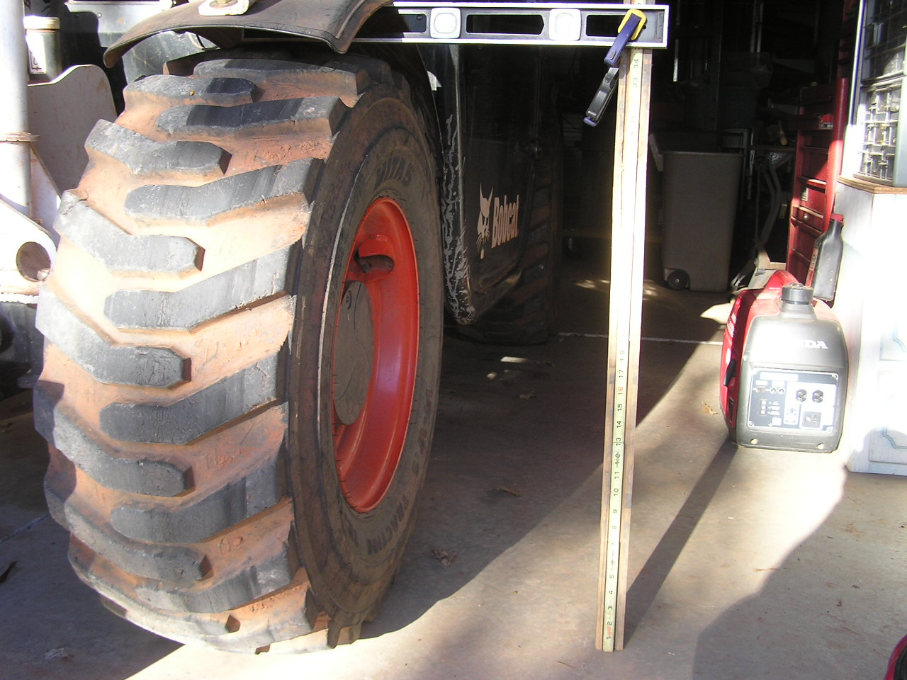

What is the ground clearance of these machines? Xfaxman, the V417 seems to be the smallest/most compact in this segment? Do you ever have an issue with ground clearance? I’m thinking about hilly terrain with a lot of large rocks and stumps to navigate around.
   / Compact telehandlers
#67
Merlo 27.6 is lowest, at 9"
Bobcat v519 is middle at 10.4" - surprised this isn't higher because it has larger wheels than JCB
JCB 25-60 is next at 13"
V723 (larger version of bobcat) is highest at 16.9"
Haven't really researced the manitau yet - not sure who sells them around here, but it's ~15"
   / Compact telehandlers #68

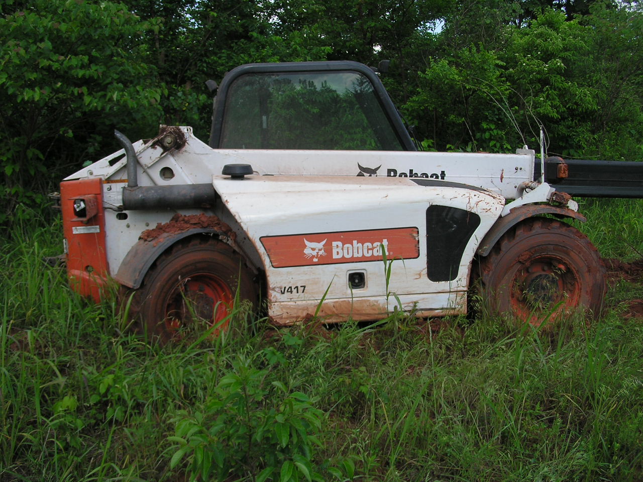

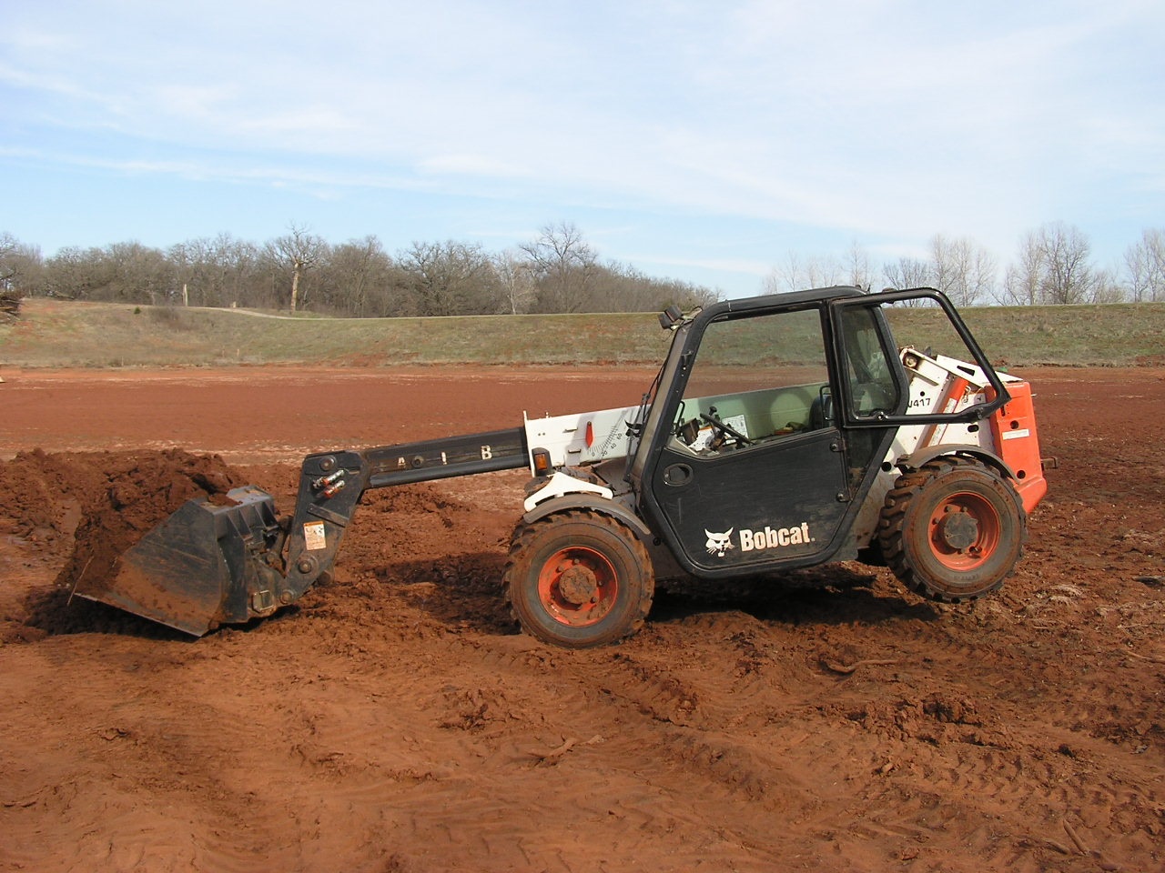

Mine is 11.6 inches. Smooth bottom, so no clearance problems but have drug it over some large logs. Guess I need to take some pictures, because tractor drivers wouldn't know how to do it. Drive up against the log, extend the boom, lower the boom, raising the tires. Drive forward while retracting the boom. Raise and extent the boom until there is enough weight on the front tires to pull you on across the log.
For motion impaired situations, retract and lower the boom, raising the front. Backup while extending the boom, pushing you out:
I carry chains and a tow strap in case I need to use a tree for the boom to pull me out or off a high center condition:
It wasn't high centered, the left front and right rear were spinning because it was on three wheels, setting on the axle to frame stop. It needs locking differentials. :thumbsup:

Mine is 11.6 inches. Smooth bottom, so no clearance problems but have drug it over some large logs. Guess I need to take some pictures, because tractor drivers wouldn't know how to do it. Drive up against the log, extend the boom, lower the boom, raising the tires. Drive forward while retracting the boom. Raise and extent the boom until there is enough weight on the front tires to pull you on across the log.:
Sorry, I was wrong on the v519 clearance. I pulled it from the brochure, but was looking at the v723 page. I edited my post with the correct numbers from the manual.

Great Pictures! Thanks Xfaxman!
"It wasn't high centered, the left front and right rear were spinning because it was on three wheels, setting on the axle to frame stop. It needs locking differentials."
I don't think that I've ever run across a tractor or off-road machine that didn't have a locking differential. Is it an option? What do they offer instead?
rScotty
   / Compact telehandlers #72
Your're welcome.
That is the problem, it isn't an off-road machine, it is a scaled down construction telescoping forklift with a SSQA.
They did design the boom to handle ground engaging attachments.
I just use mine as an off-road machine and use the boom to get unstuck. :thumbsup:
The new Toolcat has "Traction Control" that works in low range by applying the brake on the spinning wheel.

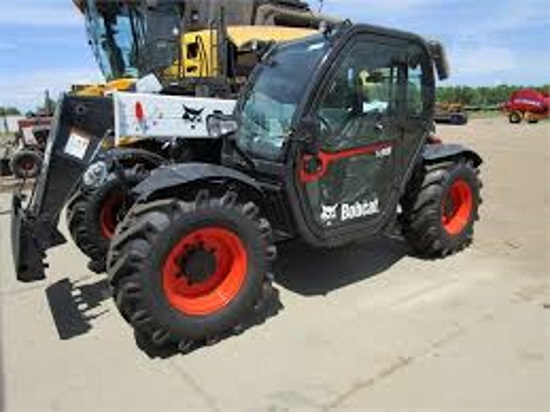

So I went up to Greenville NC yesterday to see a v519, since they didn't have one available to look at here.
I was very impressed, and think this is what we will be buying. The Bobcat has a little lower flow than some of the other machines I looked at, but actually has slightly higher lift power, and it has a lot of refinements standard (such as boom float, ability to run the engine faster while driving slower to keep power to a rotary cutter to name a few) that other machines you had to add or get a higher trim level.
