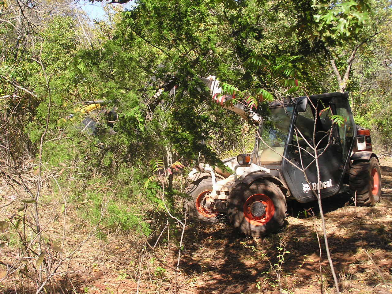

Yep, I agree. I am 77 years old, have had more tractors than I can remember, but 8 years ago I finally found a better machine for my situation. I don't see any reason for me to have a backhoe or a CTL now.

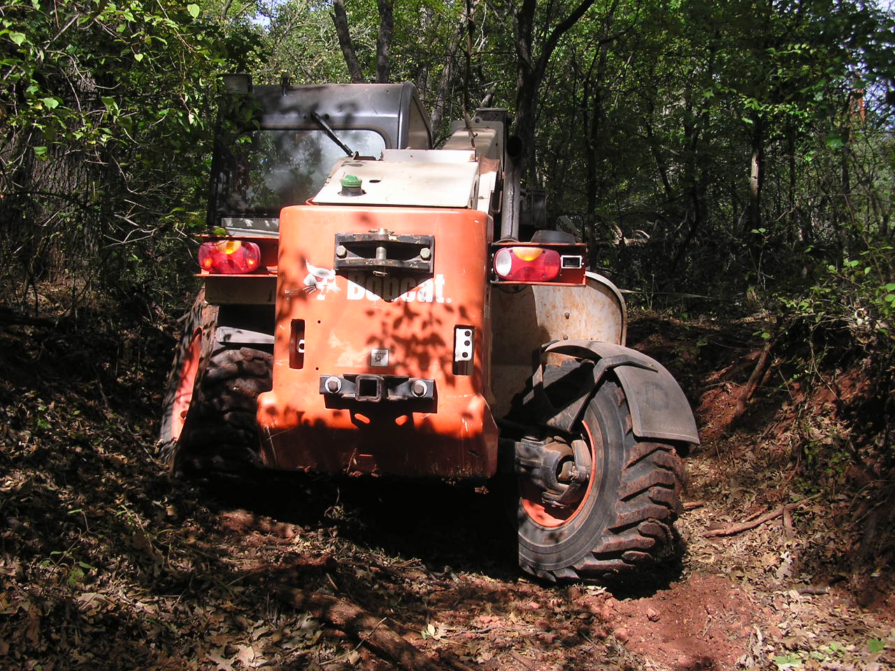

I use the V417 in the woods a lot. At 6.5' tall with 4 wheel steer and crab steer it will go places a backhoe can't:

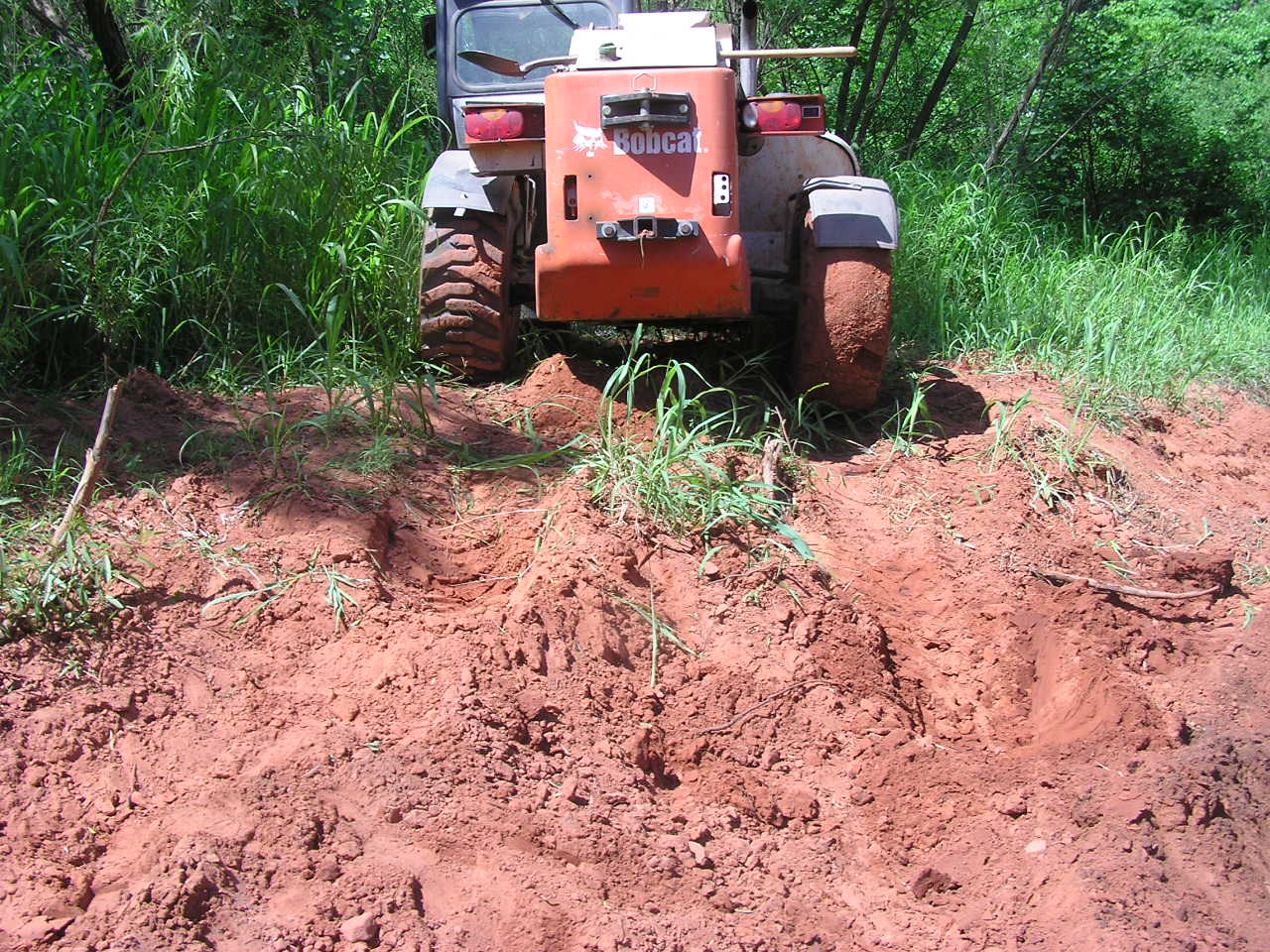

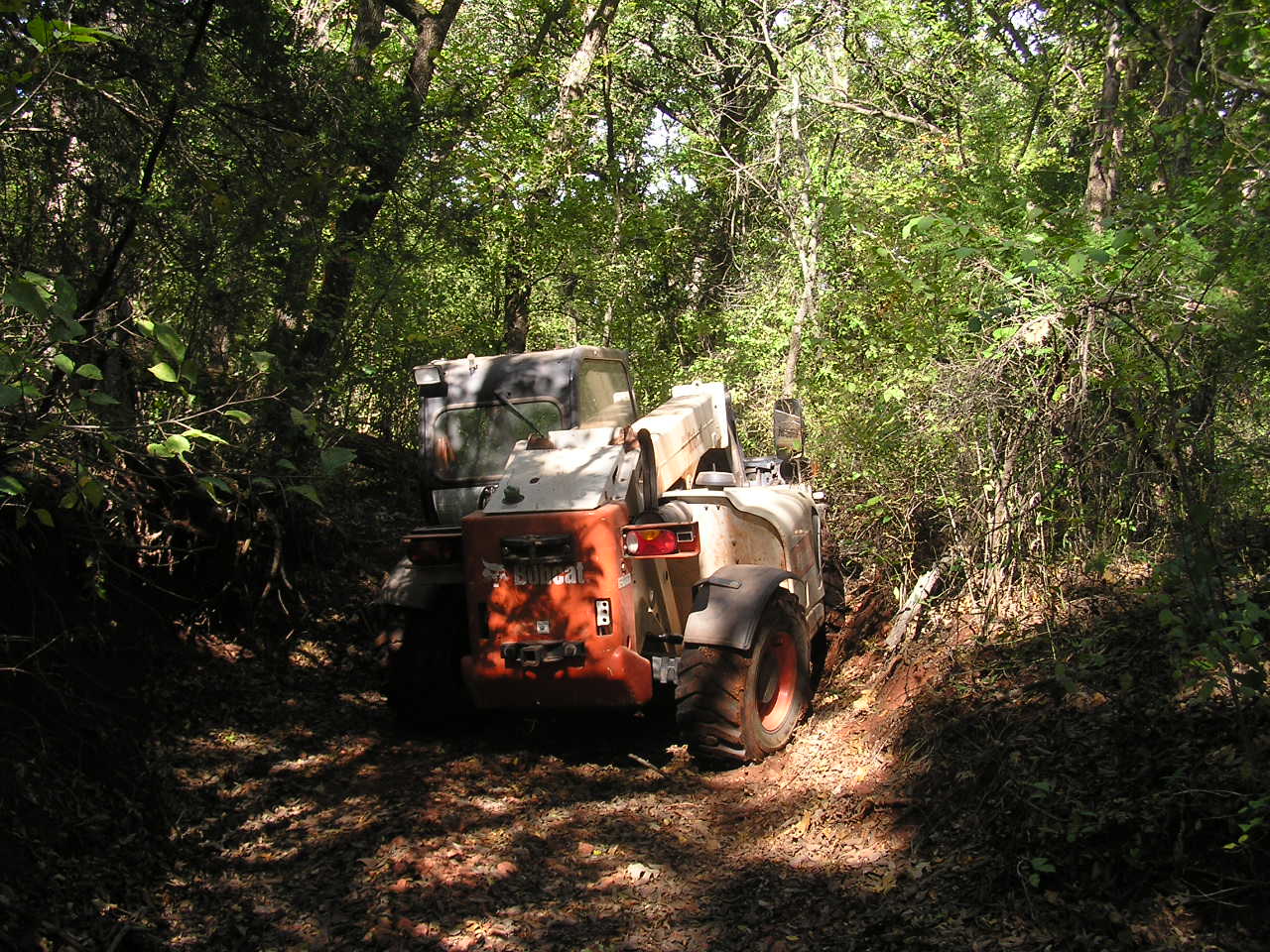

Mine is 11.6 inches. Smooth bottom, so no clearance problems but have drug it over some large logs. Guess I need to take some pictures, because tractor drivers wouldn't know how to do it. Drive up against the log, extend the boom, lower the boom, raising the tires. Drive forward while retracting the boom. Raise and extent the boom until there is enough weight on the front tires to pull you on across the log.

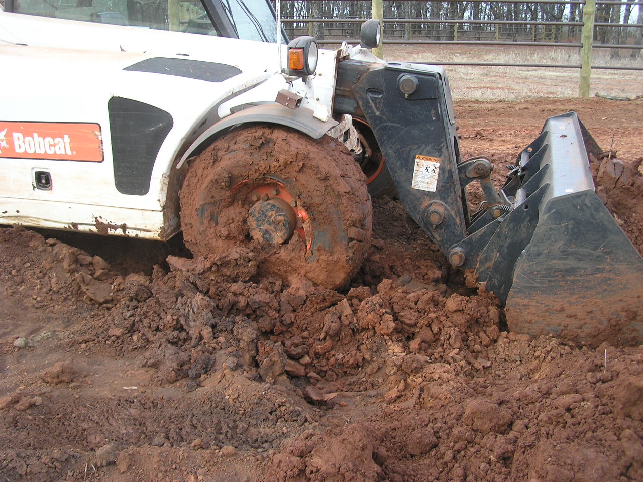

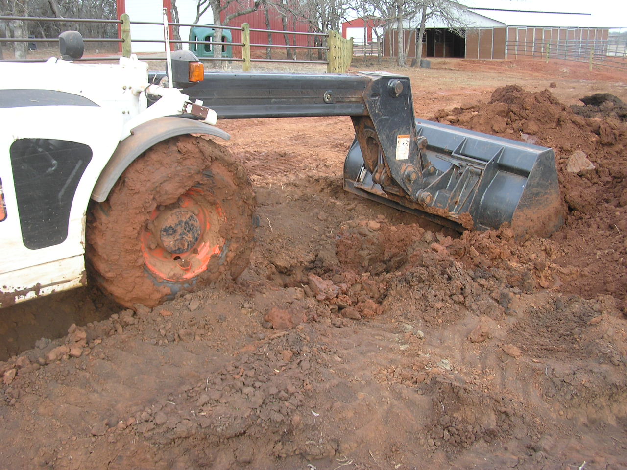

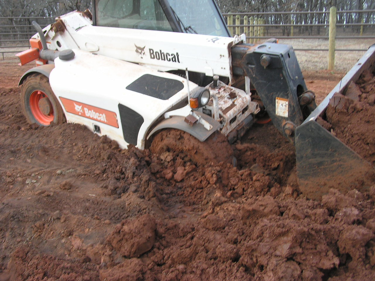

For motion impaired situations, retract and lower the boom, raising the front. Backup while extending the boom, pushing you out:

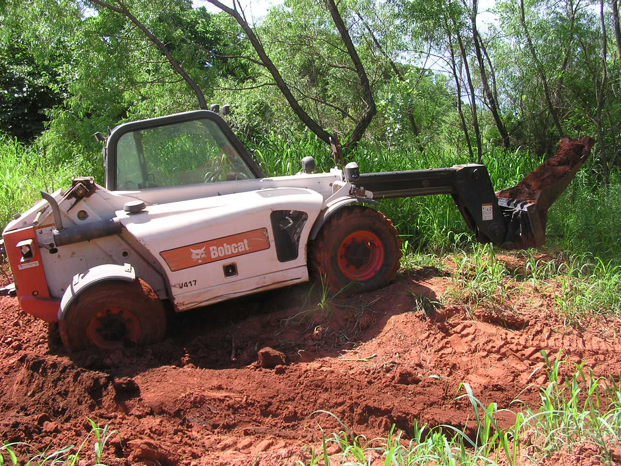

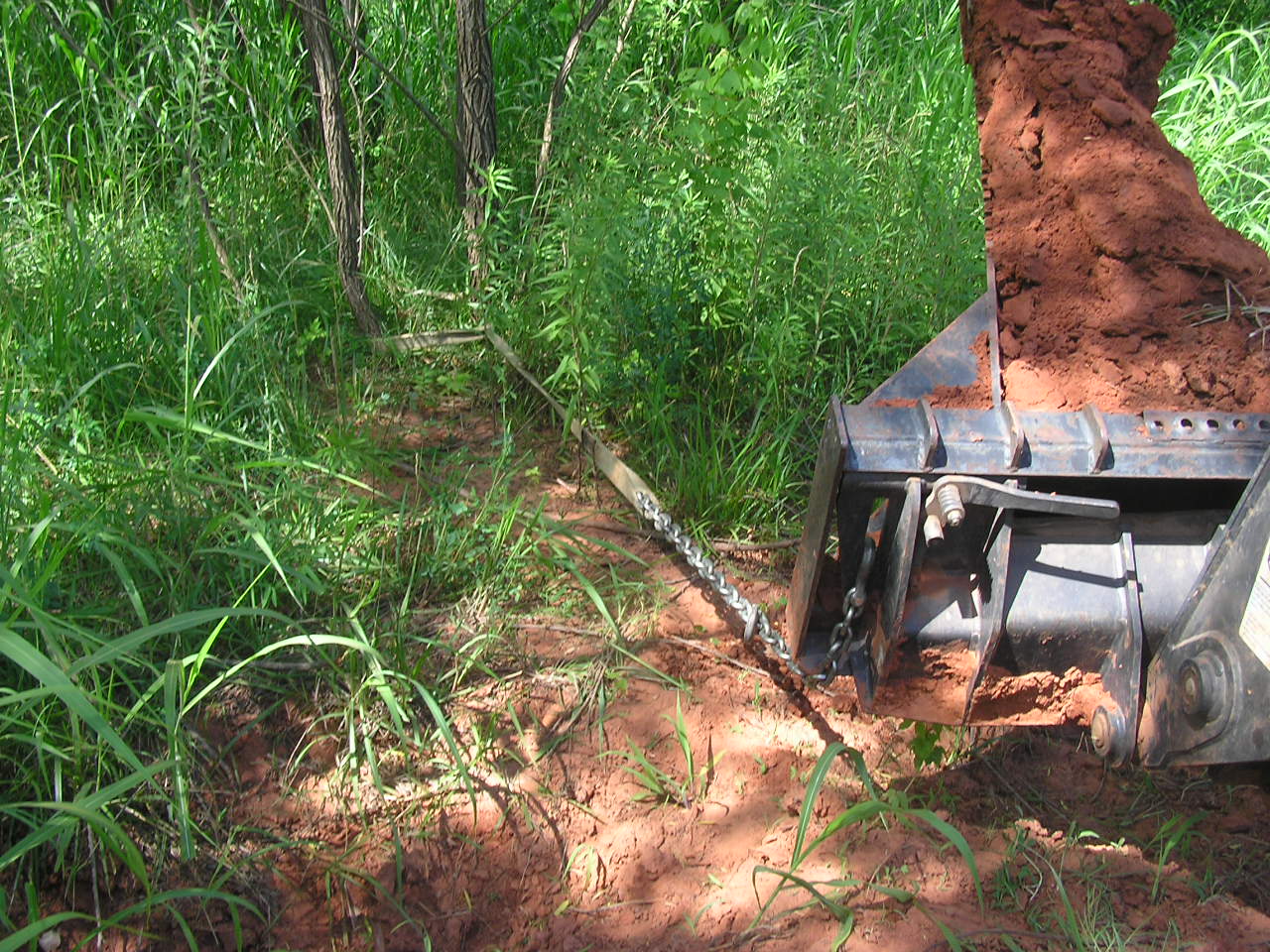

I carry chains and a tow strap in case I need to use a tree for the boom to pull me out or off a high center condition:

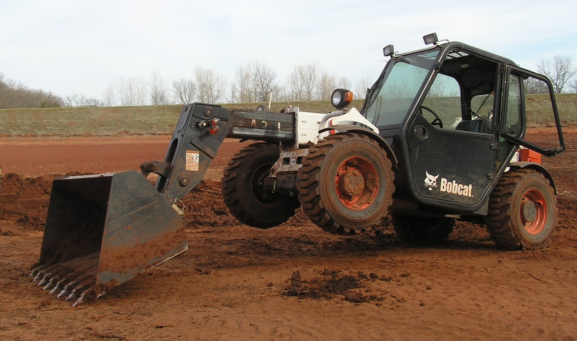

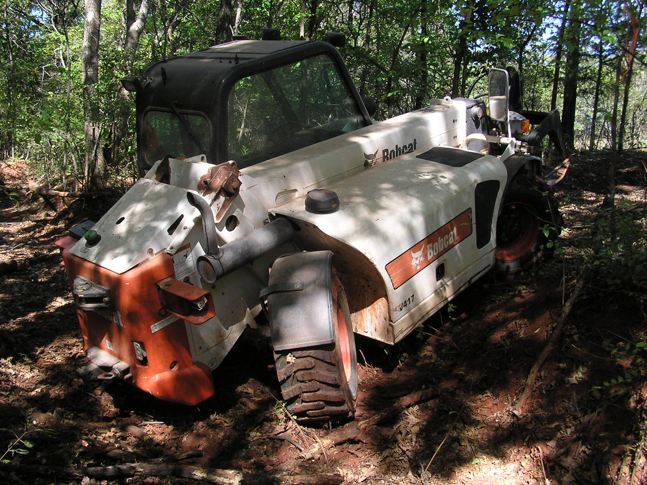

It wasn't high centered, the left front and right rear were spinning because it was on three wheels, setting on the axle to frame stop. It needs locking differentials. :thumbsup:
