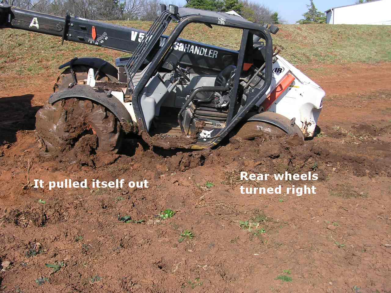

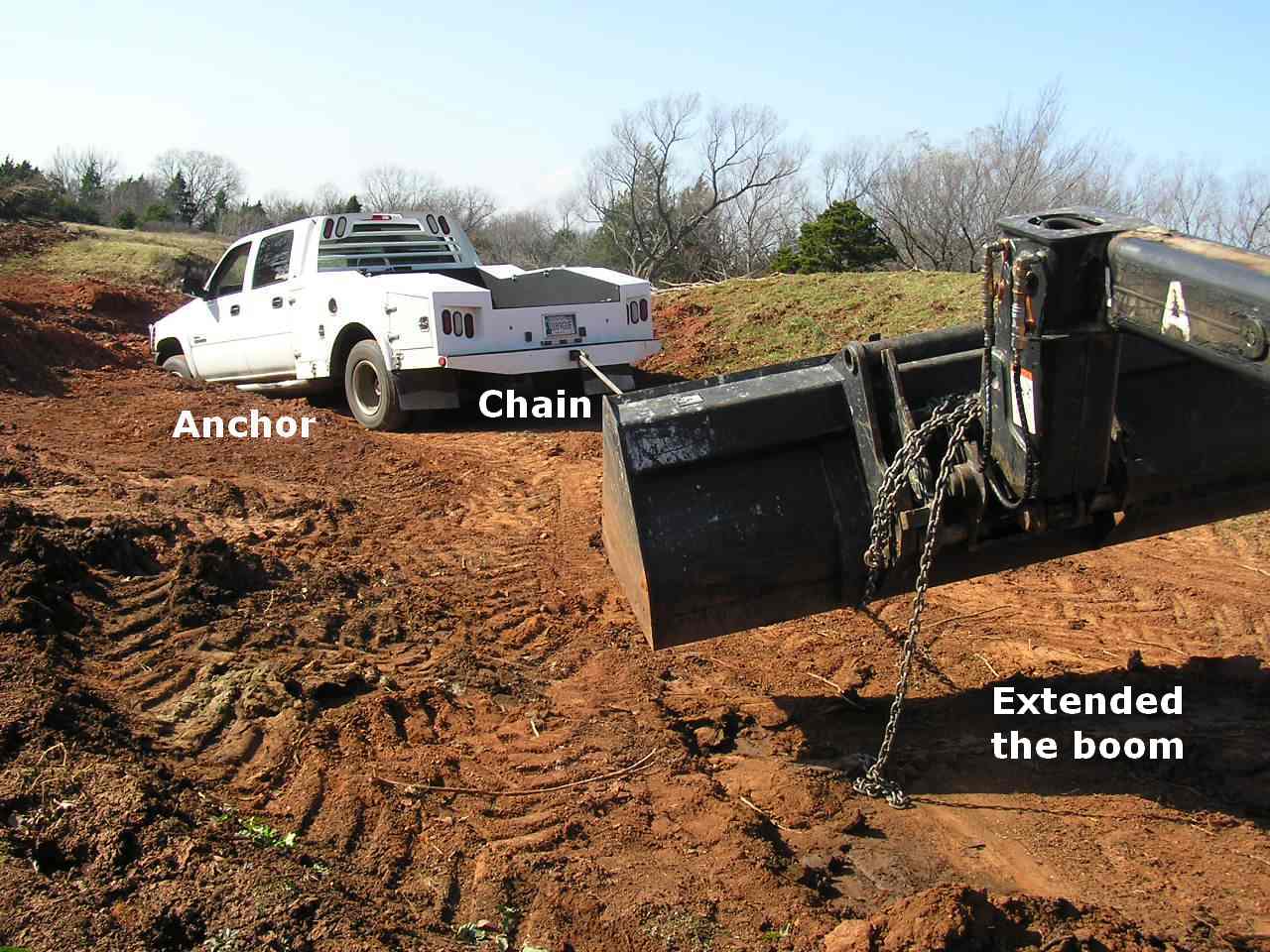

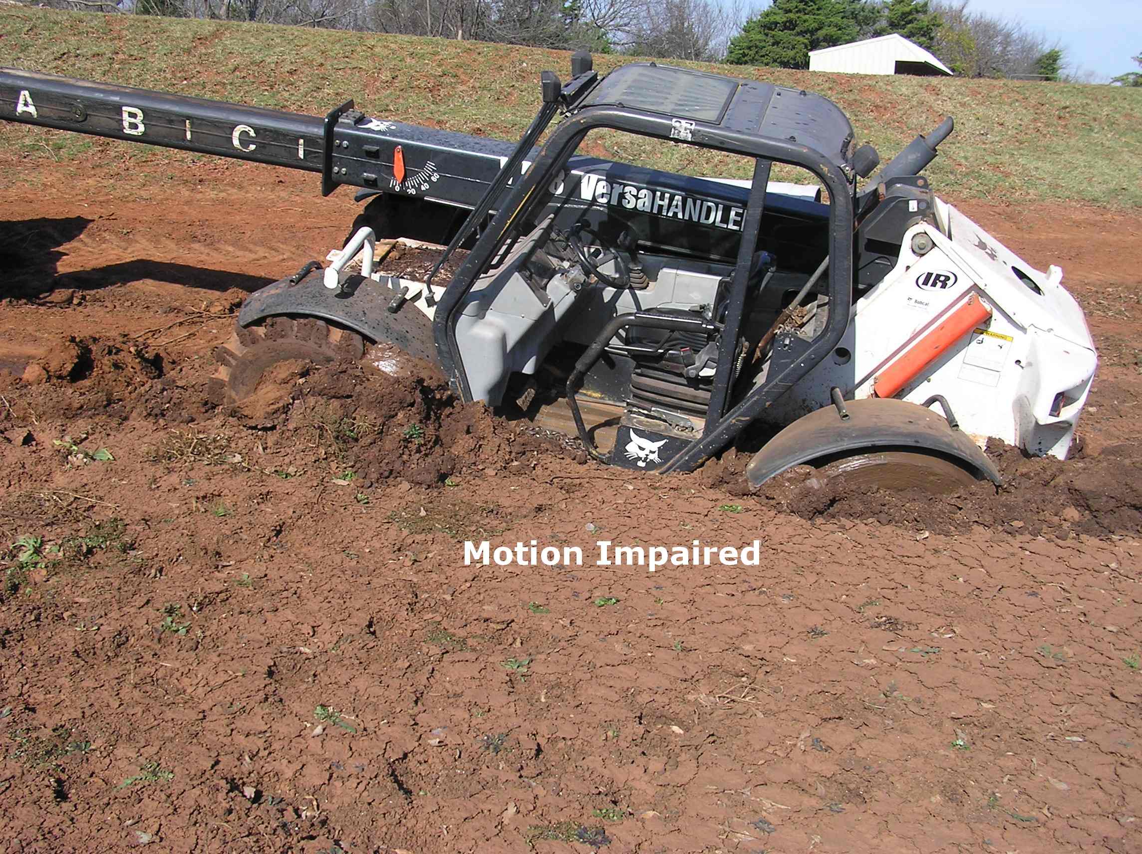

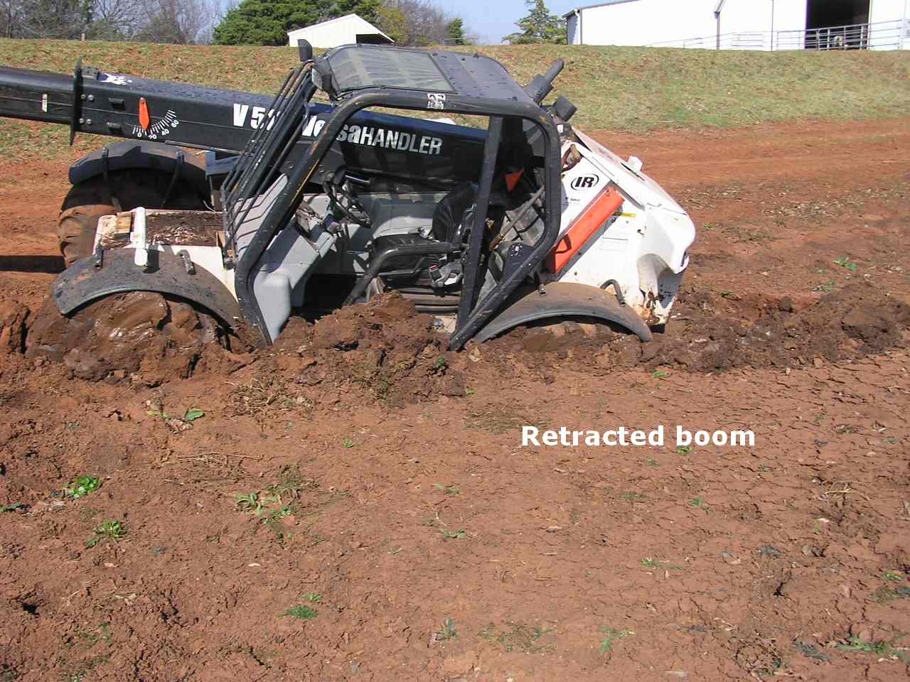

Here is my anchor. :D

You have some decent tires on that thing. Counts for a lot.
