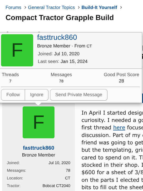

Not too likely to get a response because he has not been here since January of last year:
