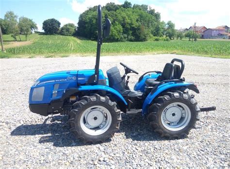

Until that happens though, I was looking at the BCS 4 wheel articulated tractor. I am not sure of teh availability in the US, but I like the look of them. My sheep barns are low so getting a smaller, maneuverable tractor about inside my barns would work well for me. The funny looking ROPS would be lobbed off before the delivery truck left though, that is for sure.

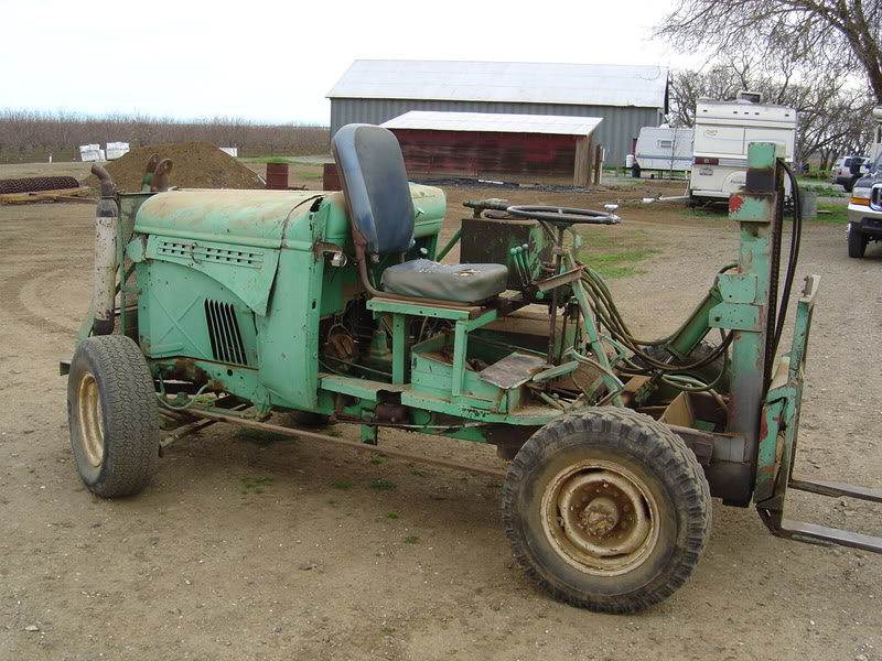

Yep, built like my put-together with the engine and pivoting axle at the back:
