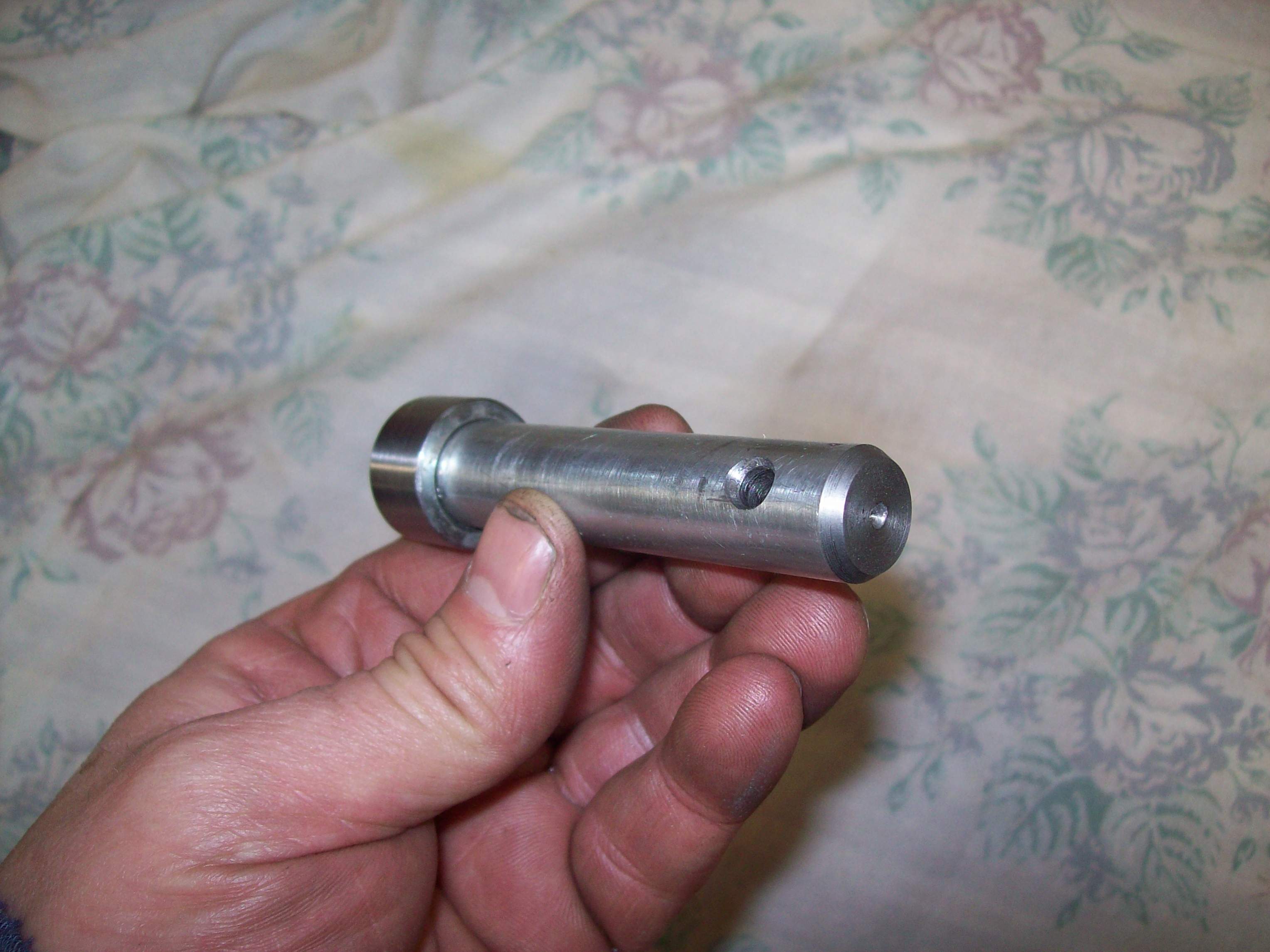

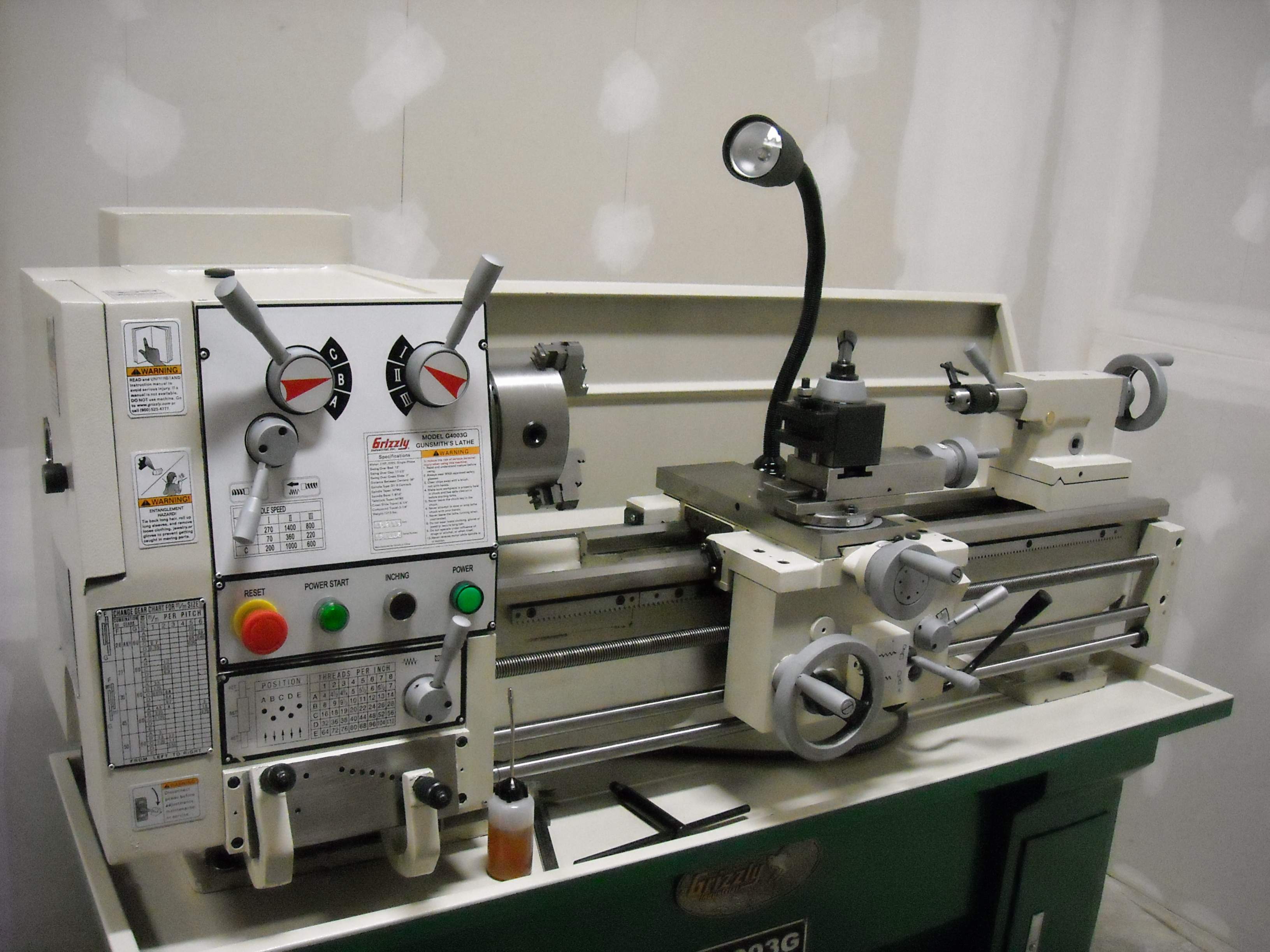

It's true US built (anything ) is usually better than an import and that is certainly true with the Lathes and Mills, however Price and availability have to be figured in.
A few observations from the research I've done
1) I looked a long time for a Lathe in our area, all I found was junk or one that the owner thought they were made of gold:rolleyes: I found one in the states that "looked good" (taking the owners word for it is a little scary) but the shipping was almost the same as buying a new one and having it delivered. If you live in an area that US made lathes are readily available, I definitely look around, I would find someone who knew what they were looking in an attempt to weed through the junk!
2) 3-in-1: I started off looking for the same thing, however most people that have used one of these are hesitant to endorse the idea. I was told on more than once the "yes they are three in one, however they don't do any of them very well" This all depends on the size of your shop, if you have very limited space than this may be the only option.
3) Size: As other have said, I would buy as big as practical.
4) And I think most importantly it depends what your going to do with it, sounds like you are in a similar situation as I am, wanting to do some tinkering and a little home R&D:) If your looking for ultra precision then may want to look a little deeper.
After what I think is sound advice I didn't buy a 3-in-1 I bought a Lathe and still looking and saving for the Mill. Since I'm novice and not doing highly precision work I chose to buy a Grizzly 12x36 (Gunsmith model) I figured that would increase it's accuracy. I'm very pleased with it so far.
