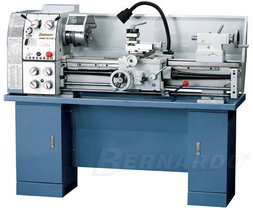

I also debated for a long time what I would get. I considered the 3 in 1 and almost went that way, but reading on the forums and machinist guys all seemed to not think that they were very practical. Therefore I considered the different options for a regular lathe. I decided that the headstock through size and the length that I had in my mind that I would need for my projects and decided on the 12X36. I have not made that many things with it and have not yet tried threading, but I have enjoyed using it in making pins, a roller for sliding door, spacers for a bike, bearing spindle and spacer for my gauge wheels and various other things. i certainly like the convenience of having it when I want to make something.

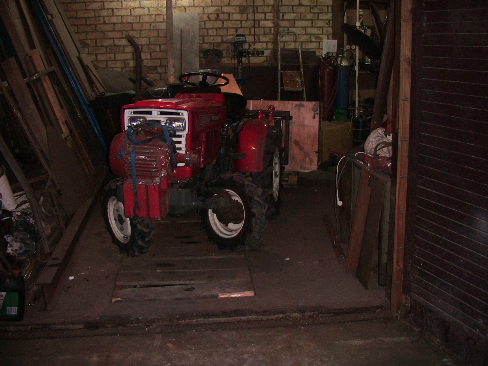

It is heavy and to move it into my shop area I had to be creative--the forks I made worked well, but the front wheels did not want to stay on the ground.:rolleyes: By adding an extra 3 phase 7 hp motor that I have and sitting on the hood and driving backwards I got it into position where I lifted it with an engine hoist.
My lathe is very similar to Mark's (AKpilot). I am very much an amateur, but I am using it to learn and do the projects that I need. I am gradually adding tooling to be able to do more.
