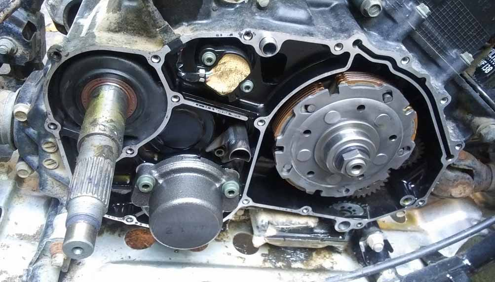

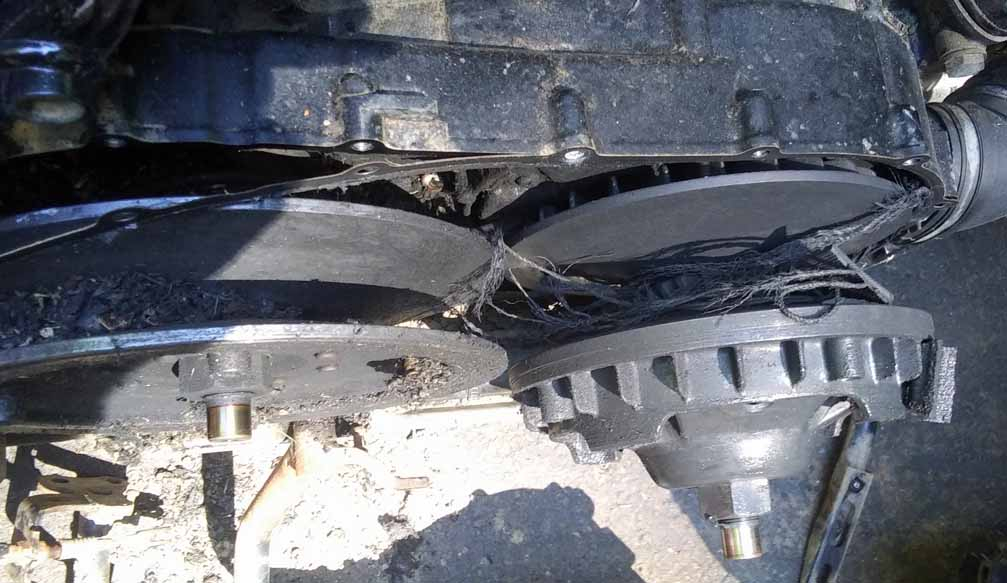

Here is the multi-plate wet clutch on a 2001 Suzuki Quadmaster 500 CVT 4x4. This is one of several I have had or worked on that suffered from rat's nest in the belt housing.

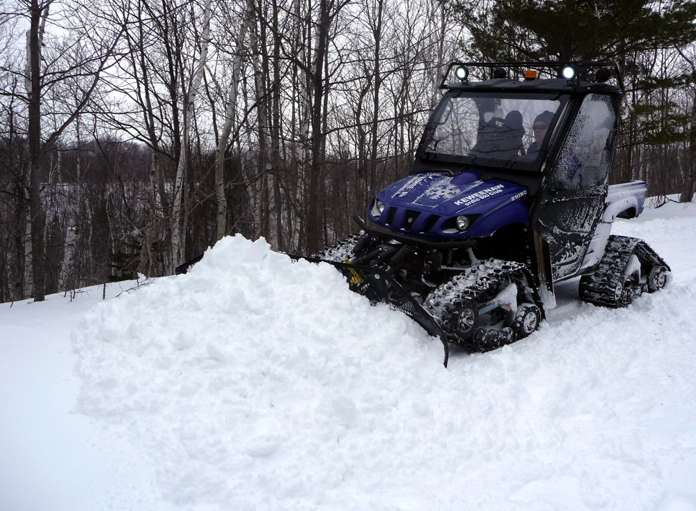

Most of the CVT trannys that are used in modern UTV's and ATV's today, work just fine. As others have stated, they use a separate clutch so the CV belt is tensioned at all times. Most people go years without servicing them. But I do believe in there maintenance!!! :geek:
