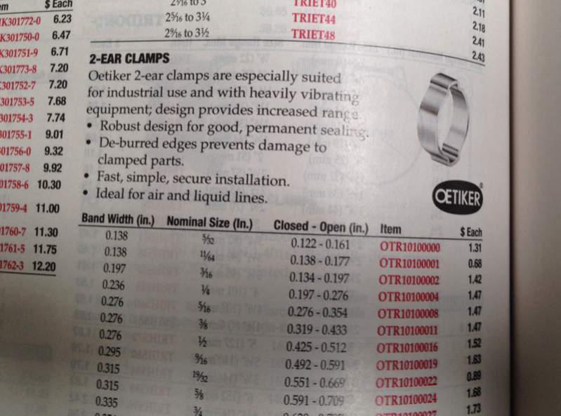

Dave, I don't know the name of the clamps, but I get them in bulk from my local industrial hydraulic supply. I think they're quite common. For your clear braided hose you need #13 for 1/4ID , #14 for 5/16ID and #15 for 3/8ID.
I'll look in my Acklands Grainger catalog tomorrow unless someone else knows what they're called.
Terry

Here you go Dave.
image-1943648755.jpg Terry
Ignore the typical Acklands Grainger retail plus 200% pricing.
   / Compressor piping or hose Question #26
Terry, I have that pliers for automotive cv boot clamps, where did you get your small clamps?
Standard at parts stores?
Those are called oetiker clamps, and you can buy them on Amazon, ebay, etc. Google oetiker clamps and you will see lots of suppliers.
